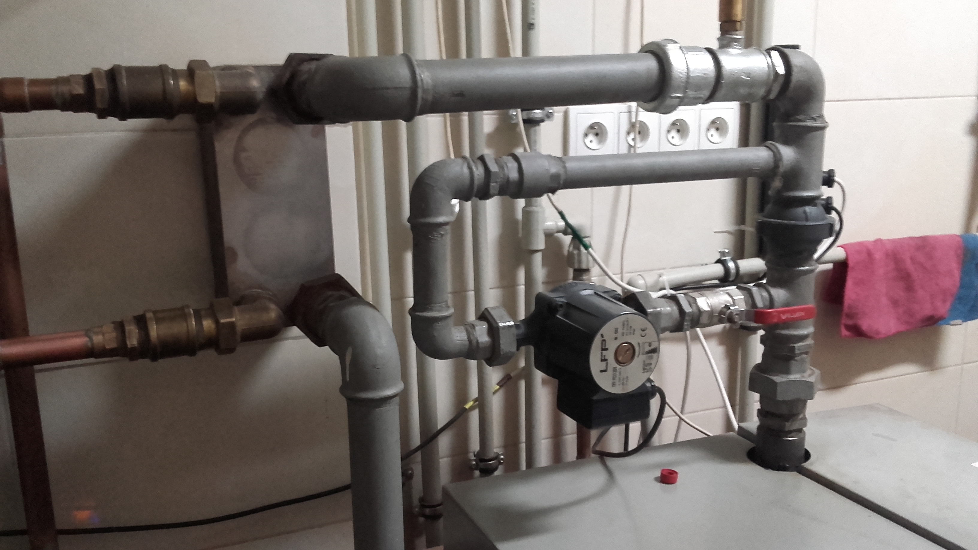

    Hello. Defro Optima Plus oven mounted for heating a 180 m2 house. This is an ordinary oven without a feeder. śmieciuch. The cycle is short. A differential valve is installed at the exit of the furnace and a pump bypassing this valve and access to the heat exchanger and then return to the boiler. Expansion tank placed above the stove about 1.5 meters under the ceiling. The problem is that from time to time the pump airs up, the pressure drops and the water boils. Today I replaced the differential valve and it seems better, but after about 8 hours of smoking the pump again announced itself, but the water did not boil anymore because maybe the differential valve worked. Everything works very well until the knock the pump will not get air. Where does this air come from in such a small system? How exactly to bleed this system? Or maybe there is another reason? Can anyone suggest something? Thanks in advance......
    #2 16969749
    Magister_123
    Level 36  
    Posts: 2893
    Help: 378
    Rate: 974
    Draw a diagram or paste photos of the layout.
  • #3 16969984
    puchacz2420
    Posts: 90
    Rate: 42
    The central heating furnace pump is aerated and the water in the furnace boils. The central heating furnace pump is aerated and the water in the furnace boils. The central heating furnace pump is aerated and the water in the furnace boils. The central heating furnace pump is aerated and the water in the furnace boils. The central heating furnace pump is aerated and the water in the furnace boils.

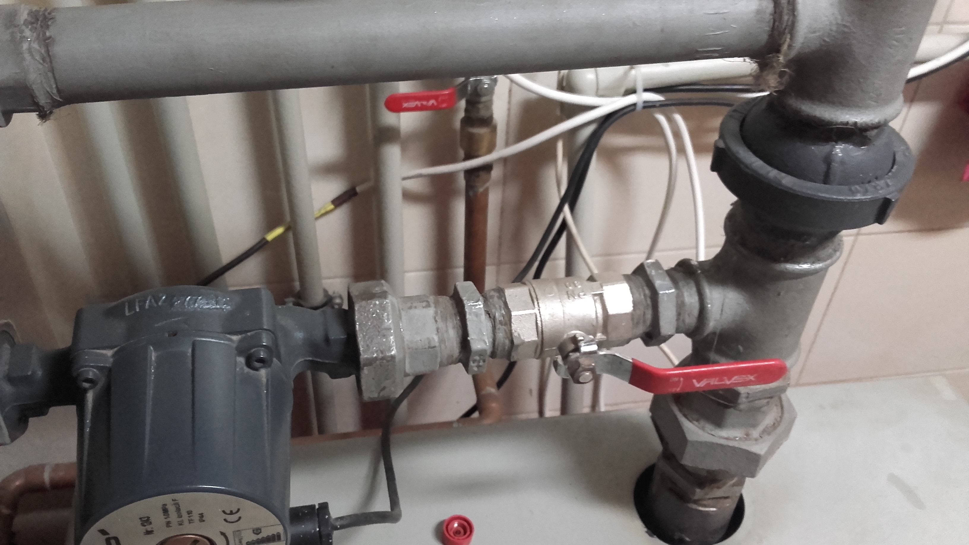

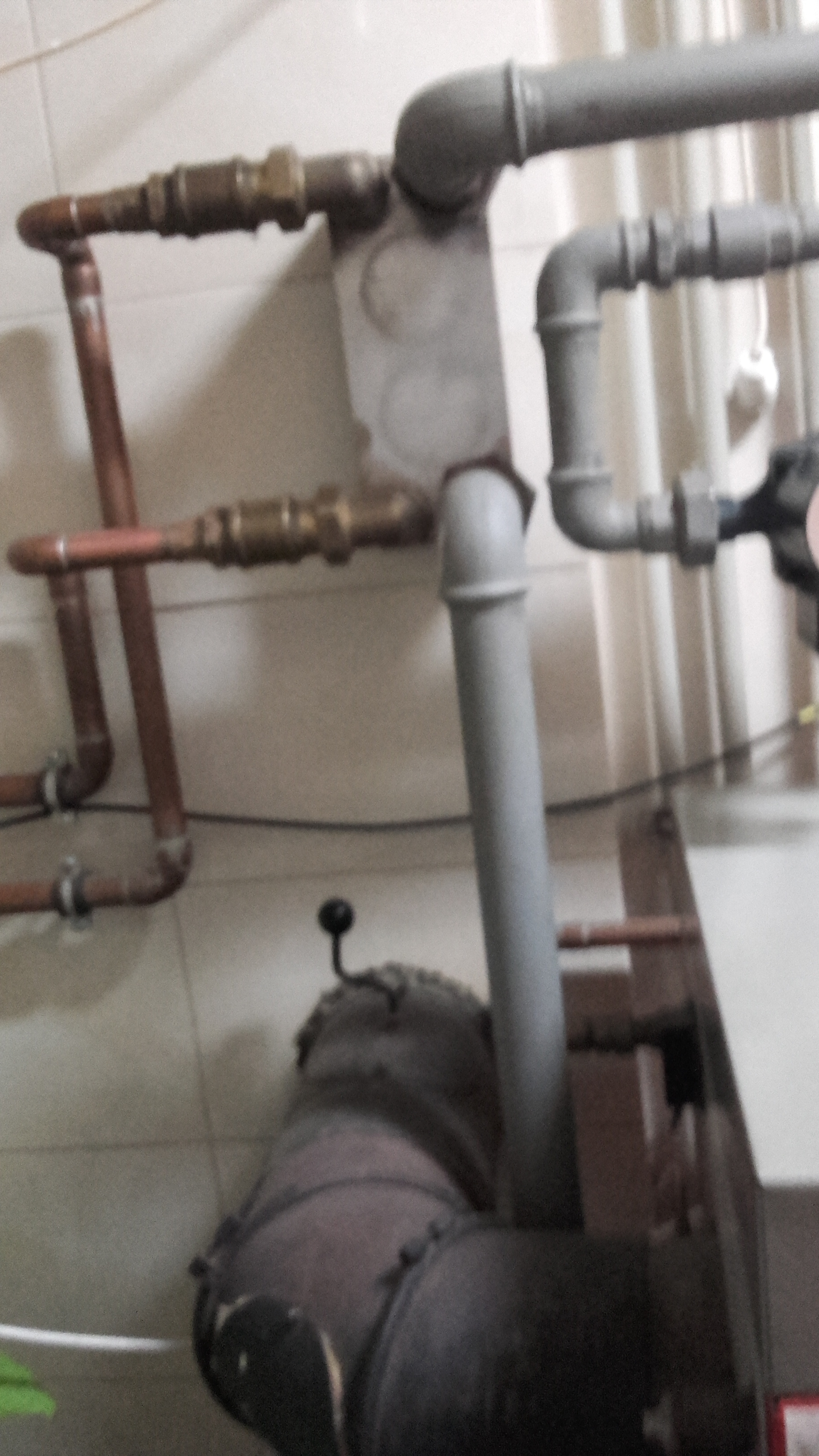

    I took photos of only a small circuit from the exchanger, only pumps for CH, DHW and floor supply.

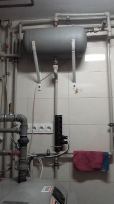

    This gray vessel is a balancing tank connected directly to the boiler. Boiler with a thermal power range from 8 to 25 kw. I can't read the power on the exchanger so I will write what I see. .Max work Press (bar) 30, max work temp 230, min work temp -190, test pressure bar 64, volume letters 0.7. There is something else HTA (m2) / weight (kg) - 0.9 / 5.3.

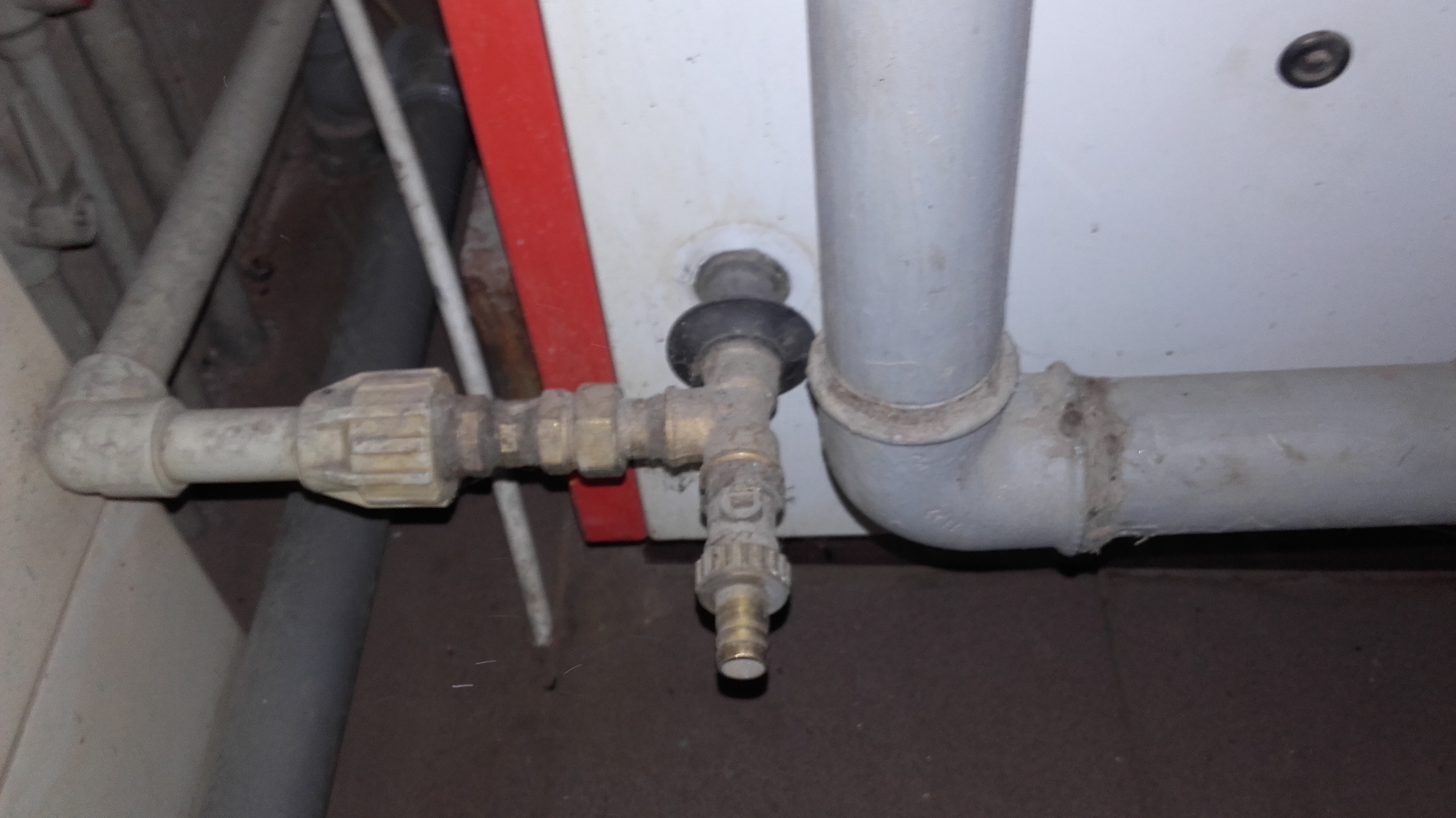

    One more thing ... a leveling vessel connected to the boiler next to the return ... as in the picture.

    The expansion vessel must be connected at the highest point of the installation. Do not measure the height from the oven only at least "1cm" above the highest point of the installation. The pump does not ventilate it just seems so because the system is aerated and the pump works with all its strength.
    In addition, the pump may be on the return, it will start working at the right time with a delay when the need arises.

    Dude, you have a "bomb" at home. Who did this to you? Answer yourself, how and where should steam escape from the boiler while boiling water?
    Installation for immediate conversion ... connection of expansion vessel.

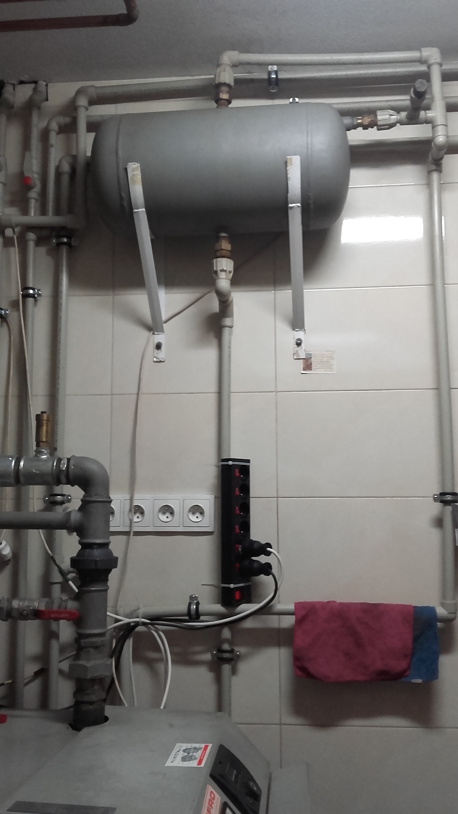

    Ok. As for the tank it is approx. It is about 70 cm above the highest point. I fired and heated the oven to 76 degrees and at 70 the system was announced the pump was running dry. I vented at the pump and keep it going for now. I set the temperature on the boiler 55 degrees and so far nothing is happening. Popale so for 2-3 days and raise the temperature again to 75 I will see if it is announced again. Thanks for help ... greetings ...
    Added after 9 [minutes]:
    That's right Stallone. Only where to connect this reservoir now. Constantly when it boils water it is thrown out through the reservoir ...

    Drain the water from the system and fill it again. After filling, you already have air in the system because which way it will go out.
    Expansion vessel should connect directly above boiler outlet

    Straight from the boiler from the top from the Dutch to the expansion vessel from above with an inch steel pipe while maintaining the slope to the boiler, i.e. first leaving the boiler to the expansion vessel, and only then going sideways to the existing system with the pump. The easiest way instead of this tee after the Dutch is to screw in a tee such as exit from the boiler through, give a reduction on the top for 1 inch and a pipe to the vessel, and connect the existing system to the side of the tee. Connect the bottom of the expansion vessel to the boiler return, overflow from the side of the vessel to the sink.

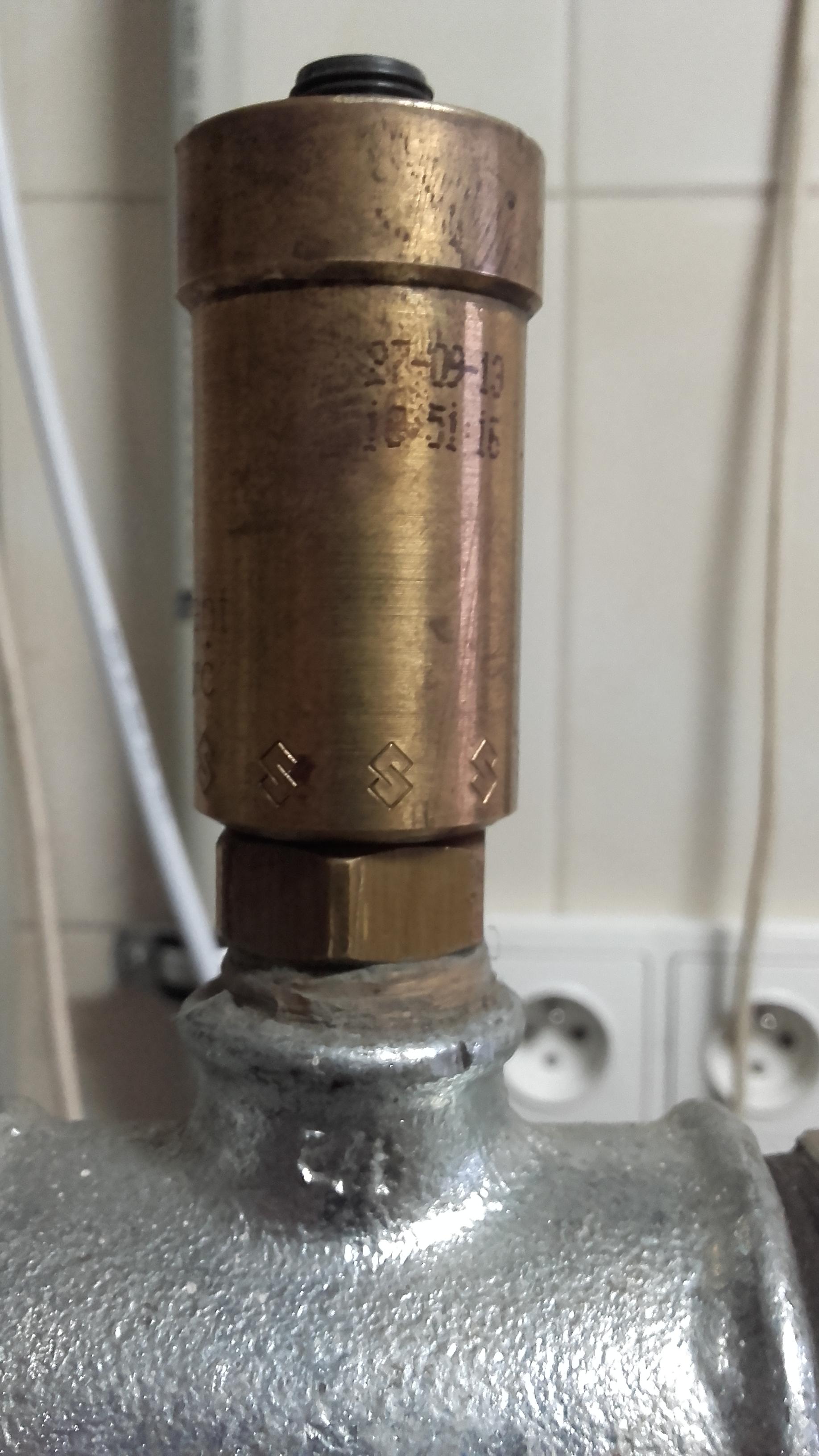

    OK thanks. Heniu. I will do it tomorrow and write the effect. At the highest point I have a breather valve and maybe it's too weak and it's not enough to replace it with a regular closing valve ... thanks.

    Thanks Stallone. I will do it too. In the end I have to find a mistake. pozdr

    Drain some water, open the venting valve and then extend with a hose and fill it up listening for air leaks.

    Hi. Sorry that I did not speak but after the fault I had to leave immediately. The topic is completed. Thanks to Heni for the simple hints and I used it. The stove works like this doll. Thanks also because it really is puzzling but after installing the valve as Henio 65 described everything is ok. In the spring after the season I will do as Sstalone wrote. Wife doesn't complain, the oven doesn't cook. Thanks for you .... Regards.
