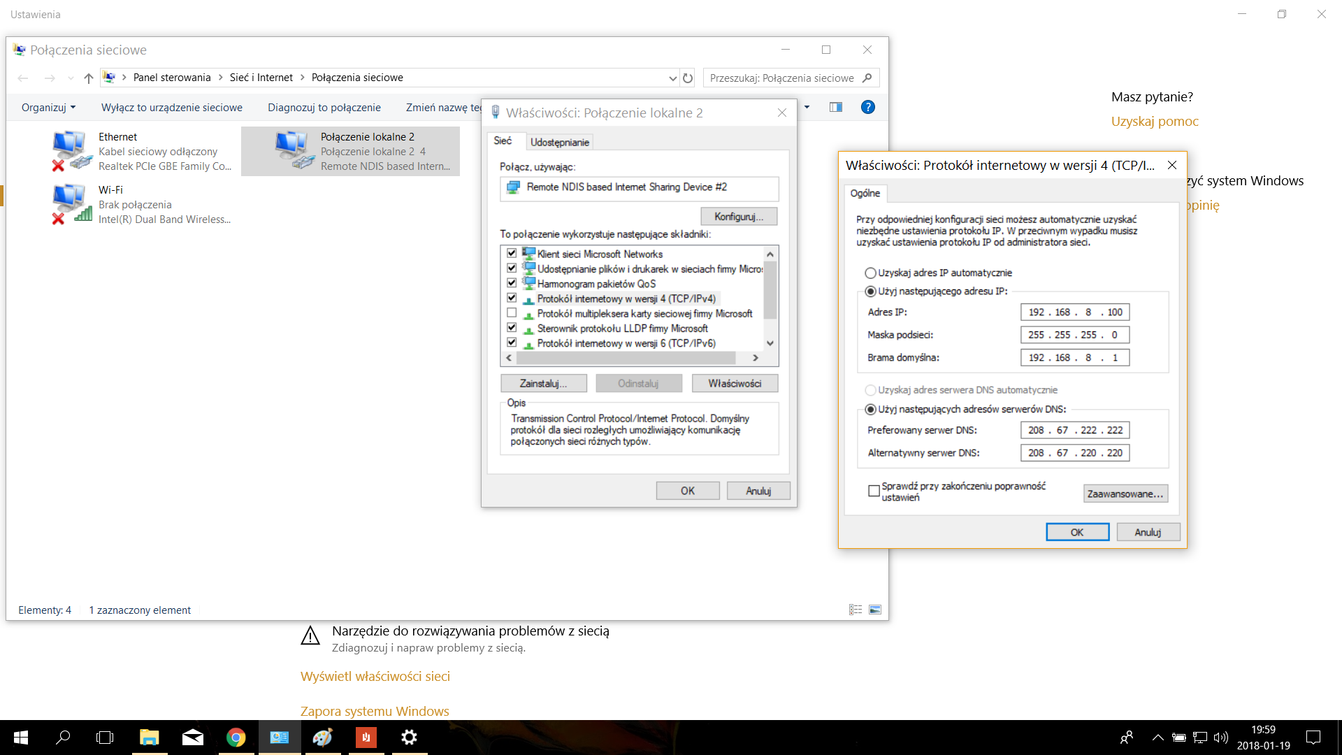

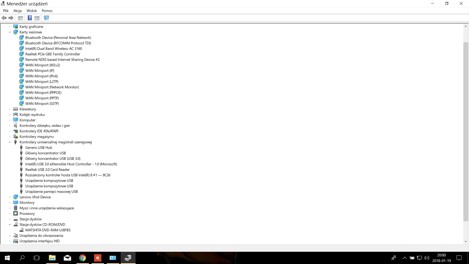

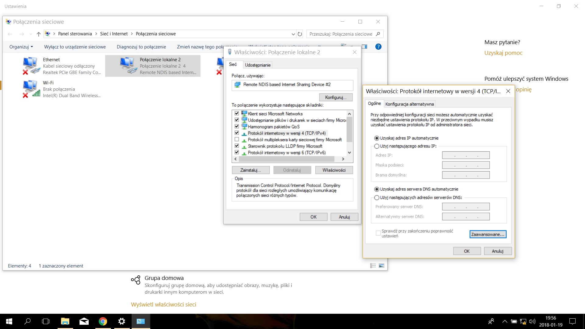

    Hi,
    I overpowered the entire internet in search of a solution to my problem and nothing. You are my last resort and I believe that thanks to you I will be able to fix the situation.
    Problem:
    I have a laptop Lenovo 50-70. During the update, the flap was closed - some file was lost, windows fell. Thanks to the Lenovo partition, I returned to the state immediately after buying 8.1 wines. A moment later I converted it to win10 (from a disk I made hastily at work).

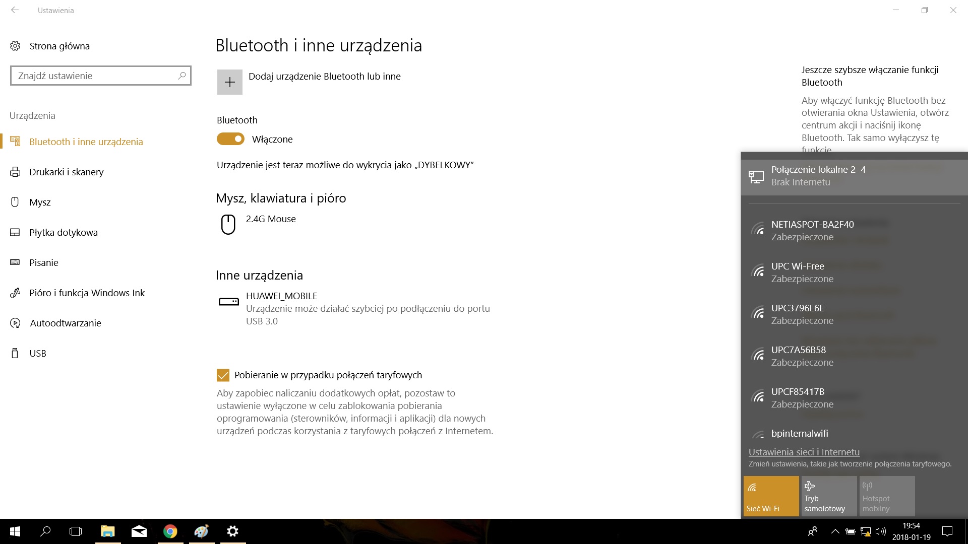

    After running the computer through the whole process I found a naked man without a head - the Internet. I plug in a modem - it detects it as a Other device.
    Of all the repair methods, only one is effective - rewriting the appropriate IP and the rest of the configuration in the Internet Protocol window but it is an action that slows down the network to max 1mbps upload and is temporary - each time after removing the modem I have to enter it again . After entering all this, the HiLink page opens and everything blinks as it should.
    I would like to point out that before the "format" the internet was pounding without problems and complications.
    I don't have USB saving enabled (I think) - I haven't dug up this option.
    Win is activated.

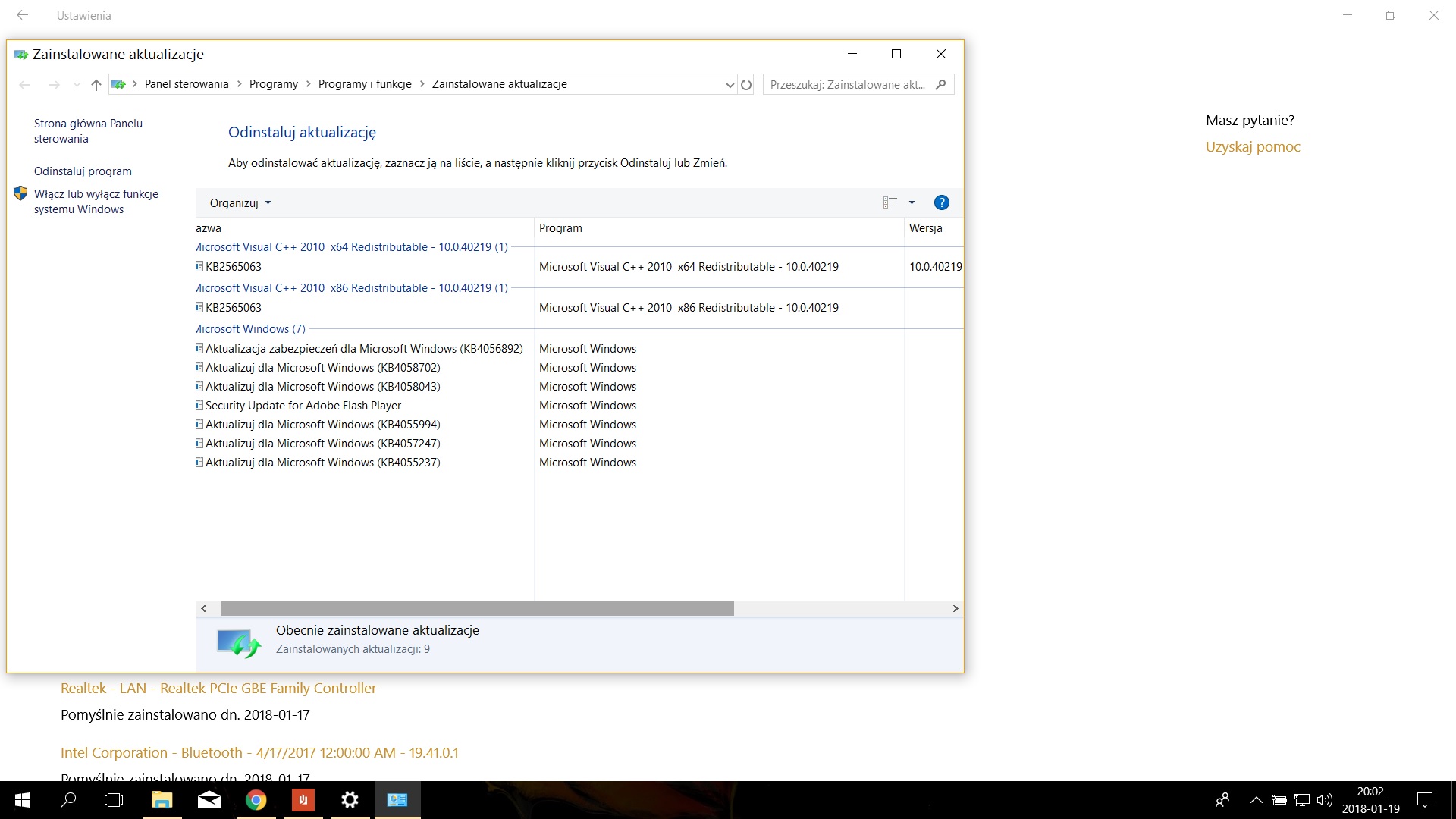

    I tried to install the update that was supposed to eliminate the problem (windows10.0-kb4051963-x64), but I get the message that it does not apply to this computer.
    I tried to uninstall devices (including usb) - I still install them the same way and do not add Huaweia as a modem in the device panel.
    I tried to install device drivers - to no avail.
    I also tried to update the controllers of the bus controllers appropriate for the modem - this way it used to work on 7cca unsuccessfully.
    edit- I don't see the modem in My Computer as a device plugged into the computer or external disk or CD-ROM
    I don't have the strength to do it anymore. Today a woman from the delegation is coming back. If I don't play her show, it will kill me.

  • #3 16973771
    kostuszko
    Everything is great, only now I have a grounded modem on one USB socket. We return to the starting point when connecting to another one. Should I set it to USB RNDIS everywhere?
  • #5 17998625
    kostuszko
    You need to install the software that is on the device as Storage (Play app) and then run the app.
    After installation, a pop-up window will appear that a modem has been detected.
