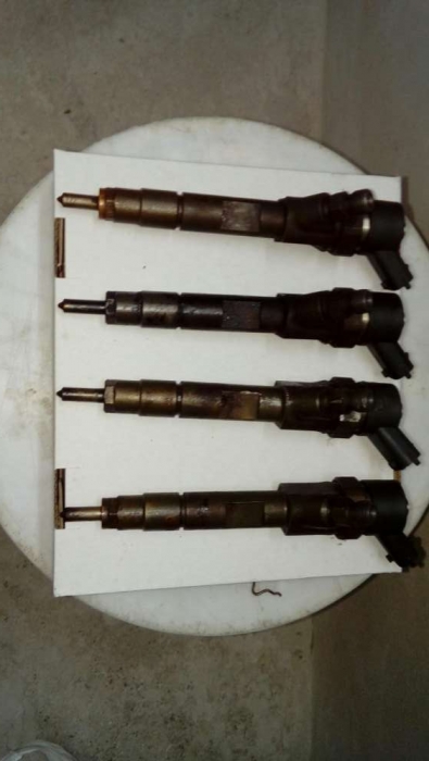

    Hello, I have to replace my injection in vivaro 1.9DTI 2002. 1.9 CDTI I bought used good injection molds or will I have to code them after replacement. It mechanics a bit and I mean if it will be replaced or the car will run without injection molding. Will he possibly start and get to the mechanic who codes them. I also don't know the order in which they were installed in the previous engine, in which order should I mount them now? I am asking for advice

    You don't need to code anything. This is not a Common Rail system and they are not electromechanical injectors.

    In the 1.9 dTi engine, direct injection was carried out by means of an electronically controlled rotary injection pump and mechanical injectors.

    you install, vent and smoke, that's all.

    But this is a camon rail. And the injections are electro-mechanical because they have a plug, in the photo attachment of these injections

    then you have CDTI, not DTI buddy
    but nothing changes is to smoke after replacement.

    The car after replacing the mega for a long time did not want to start even on the cake, every now and then errors popped up, so I disconnected the battery clamp from time to time to reset the computer, after an hour of such fun the car fired like new but did not enter high speed, I reset the computer again and I left the car on for 15 minutes and everything normalized. After replacing the injections, the symptoms are very strong smoking in black when adding gas and a long mole that fires stopped.

    Gentlemen, in the year 2002 (even probably until 2006) and 1.9 engine Opel used the DTI mark (at least on the flap / door described it) so the author of the topic marked it well.

    Right. The 101HP F9Q760 had the DTI designation and is on CR. It doesn't change the fact that you don't have to code.
