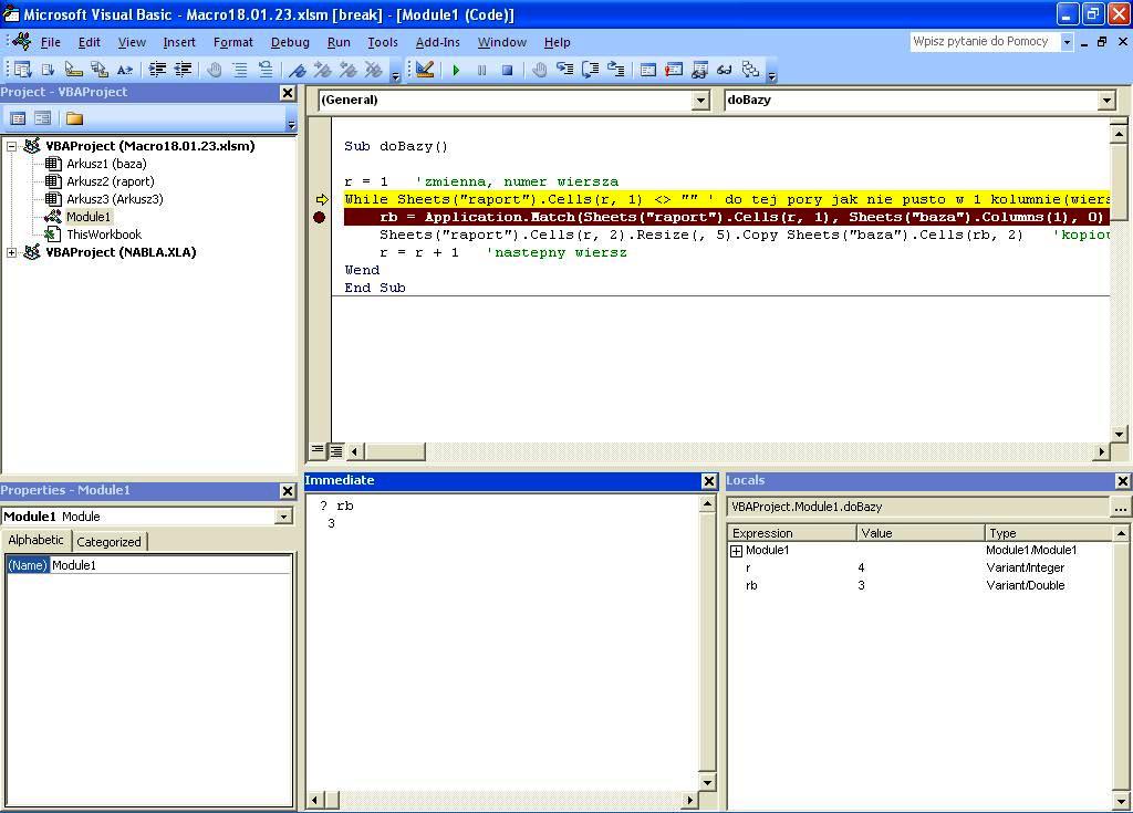

    First step - in my opinion :D - open some xlsm sheet and press Alt + F11 keys . This will open the MVB editor Beginner's Guide: Learning VBA Excel Step by Step - Tips, Examples & Department Transitionvba.JPG (97.52 kB)You must be logged in to download this attachment.
    and here you need to spend some time to learn how to fully use this basic tool for creating and testing VBA code :idea:
    In a very "light" form about VBA scripts you can read and learn a lot based on detailed explanations from Microsoft TechNet, e.g. link
