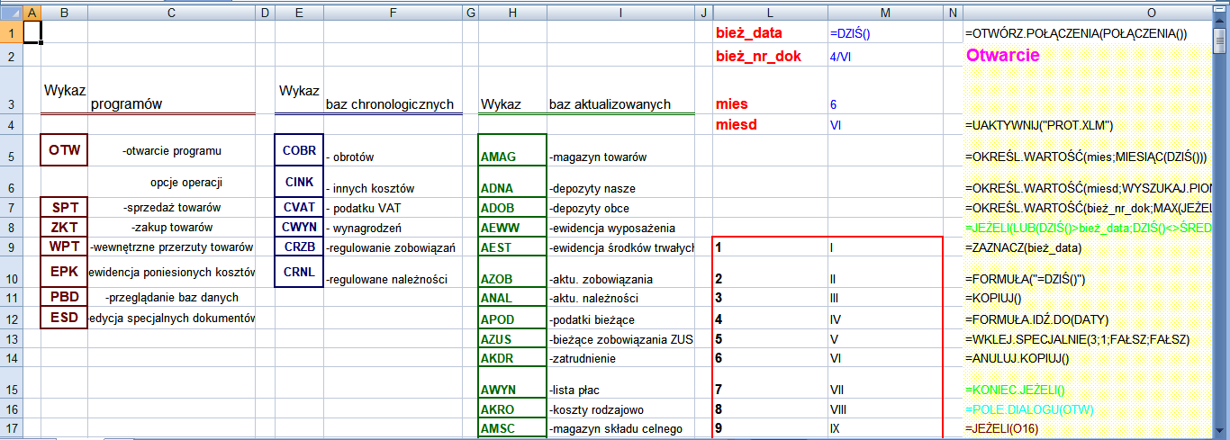

    For starters, please note that this code and the entire application is not at all perfect - especially for the specific requirements of your application, e.g. it only covers the quantity register :!: and pseudo assortment (in commercial practice the same product from another supplier or purchased at a different price - must be separately registered :wink: ), sheets "Shipment", "List", and macros that support these sheets, etc. are not needed in it
    If you want to seriously approach this project, start by making a mock-up of your application - prepare designs for all sheets that should be included in it (main warehouse, records of goods issued to employees, etc.) - You know best what has to be there. They do not have to be "instrumented" in any formulas and macros in this model - but they will be the logical - substantive basis of the whole project. Each of these sheets with tables or functional forms try to describe - what they are to serve, what data will be included there and in what forms or macros will be used.
    In a similar application of a commercial magazine, I created, apart from the basic "Magazyn" sheet, a number of other auxiliary ones, such as "Accounts" (suppliers and recipients), "Deposits", etc. I still have a model of that project from saved files.
    Excel magazine for the club - A simple warehouse program is needed2017-11...png (87.1 kB)You must be logged in to download this attachment.

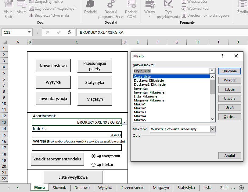

    gienek1939 wrote:
    entering alt + f11 opens VB but there, for example, I do not see the possibility of editing the first Menu tab
    This entire storage file solution is based on the so-called sheet forms and several macros
    Excel magazine for the club - A simple warehouse program is needed2020-09...png (62.96 kB)You must be logged in to download this attachment.
    which are assigned to individual buttons in these forms :idea: :D
    It is not enough to unlock a sheet and modify it freely :cry: because you have to analyze everything if the change does not affect the names used in the file and other macros :?:

    gienek1939 wrote:
    just me 1 wondering how to edit everything that is in the menu sheet
    You can edit and change entire sheets (including this Menu) after they are unlocked (these sheets :D ). After unlocking the sheet, in the Excel tab Developer you press (turn on :!: ) Design mode , you select RMB the button or other object you are interested in :arrow: and from the tool header you press View code :idea: :D
    This way you can view the VBA code assigned to each button (or other object) :ok:
    Almost all of these codes are stored in module 1 and you can modify them all with the MVBA editor :arrow: adapt to your needs :spoko:
    However, I suggest at the beginning :idea: read some basics about programming in VBA, and then after each elementary change make copies of the file version and thoroughly test if your modification did not blow up the "code" :D - if so, you restore the last working version and keep trying :please:
