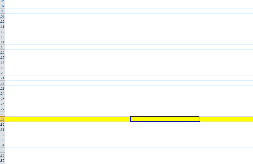

    Hi everyone, I have 2 small problems with macro for selecting rows.
    1. The first macro adds a border to the selected row - in this code I would like to add the range in which it is to operate (only within the table) From row 42 to 305.
      If w > 0 Then
        With Rows(w)
          .Borders(xlEdgeBottom).LineStyle = xlNone
        End With
      End If
      With Target(1).EntireRow
        w = .Row
        With .Borders(xlEdgeBottom)
          .LineStyle = xlContinuous
          .Weight = xlThin
          .Color = RGB(217, 217, 217)
        End With
      End With
    2. This macro adds a row fill color to me - How do I make a row selection color (from VBA code) overlap an existing fill from conditional formatting? at the moment, it doesn't work with color-filled cells.
    Rows("42:305").Interior.ColorIndex = xlNone
    If Not Intersect(Target, Rows("42:305")) Is Nothing Then Selection.EntireRow.Interior.Color = RGB(249, 249, 249)
    Can you help?

  • Macro to highlight selected row and clear previous within 42:305
    #13 16629542
    mpodciwinski
    Posts: 20
    this is how the macro should work:
    1. In the range of lines '42: 305 ', selecting any cell is to call:
    a. complete the entire row, with the cell marked, "some color" (no matter what at the moment)
    b. putting a line border (at least on the bottom edge)
    c. removing the fill from the previously selected line in the range '42: 305 '
    d. removing the border from the previously selected line in the range '42: 305 '
    2. out of range nothing happens.
  • #14 16629857
    lanzul
    Level 30  
    Posts: 1023
    Help: 199
    Rate: 123
    The sheet code below:
    Code: text
    Below is the "possible" code to paste into "ThisWorkbook" if you wanted to experiment with the unlocked comments in the code above and see how it works in various "layouts":
    Code: text
    You can still "dress" it with the "With ... End With" construction, but then everything will become "longer" and may be less understood.
    Ps: This is my "understanding" of the topic, other colleagues from the forum would certainly do it differently, probably simpler and better, so if I missed it, wait, maybe a friend will say: JRV . adamas_nt . Prot , others I haven't mentioned ...
  • #15 16630856
    mpodciwinski
    Posts: 20
    You could say it works with one exception. After clicking on another place, a light blue border from the top and bottom is left whose color is not even in the code.
    Selecting VBA Excel Rows - Macro to Add Borders and Row Fill within Table Range (42-305) & Overlap
    And I have a question, what is a "diary" that refers to cell A1?
