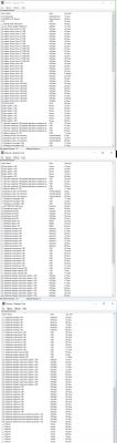

    #5 16990111
    thegrafiti12341
    safbot1st wrote:
    Try using DeviceCleanup.
    I downloaded this program, but I don't understand what to check. Can I have some clarification?
    I will add a screen, it may be useful.
    Windows 10 - Sound Issues in Games, Logitech Driving Force GT & Euro Truck Simulator 2

  • Remove unused USB devices and reinstall headphones
    #6 16990134
    safbot1st
    Posts: 21951
    Help: 2719
    Rate: 1585
    thegrafiti12341 wrote:
    safbot1st wrote:
    Do these Steelseries Siberia headphones work properly on another PC?
    It is hard for me to say because I did not check them in games on other computers, because I just do not have how to check them on them, but if I watch a movie on them it is all right.
    Indicates a power problem when too many power-consuming USB devices are connected.
    The solution will be to use an active USB hub or use mini-jack headphones.
    You remove unnecessary USB devices from the registry (which you do not use).
    Also remove the headphones and let them install from scratch.
