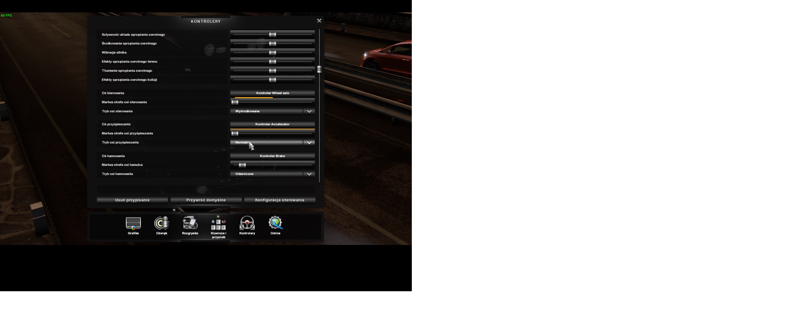

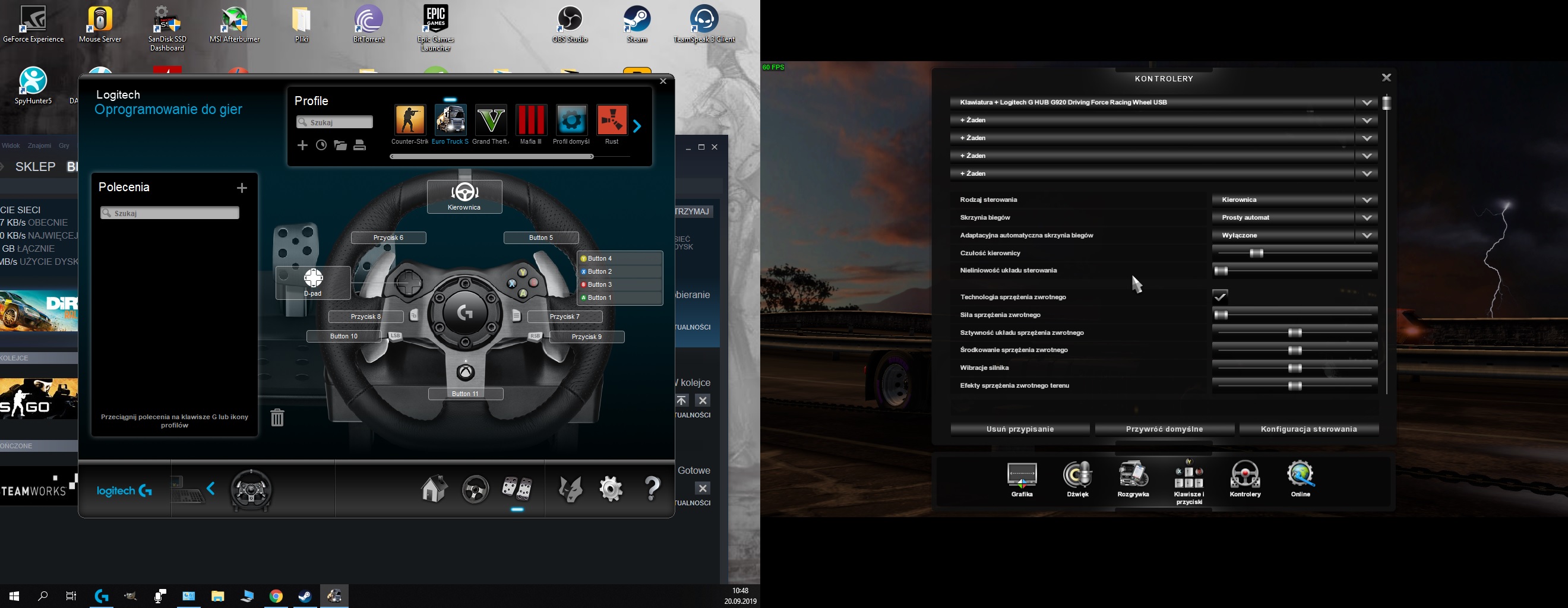

    Hello, for a few days I have been in the possession of the logitech g920 steering wheel, which I connected to the computer, at the beginning everything worked fine, unfortunately since yesterday I have problems with feedback and the gas pedal in games is pressed all the time, as for the feedback compression I have set in the game and in the logitech program gaming software set to "0" unfortunately the steering wheel still has maximum resistance, the software is the latest unfortunately I played a lot in the settings to fix it, but without your help I will not be able to do it.
    PS. I am throwing some screenshots of the settings.
    • Logitech G920 Steering Wheel Issues: Feedback, Gas Pedal & Calibration on PC - Help Needed logitech ustawienia ets2.jpg (224.07 KB) You must be logged in to download this attachment.
    • Logitech G920 Steering Wheel Issues: Feedback, Gas Pedal & Calibration on PC - Help Needed logitech sprężanie.jpg (444.56 KB) You must be logged in to download this attachment.

    I solved this topic, the problem was that for each game I had to create a separate profile in a dedicated program, in this case "logitech gaming software", for example for Euro Sruck Simulator 2, I had to create a separate profile in the program and set everything in the program as I wanted , then launch the game and do the same in the game settings, it was simple, but it was hard to find a tutorial on this topic online.
