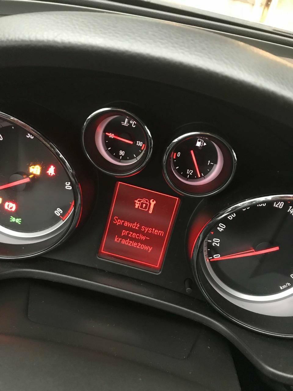

    Has anyone encountered this message? Check the anti-theft system ?? I mention that first it happened with one key, I changed the batteries, but unfortunately nothing helped. We started using the second key and for about half a year everything was fine, after which it has been appearing again for two days. Sometimes, after hard trials, I manage to fire, but I do not hide that I am afraid that one day it will not fire.
    After suggestions from colleagues from another group, I bought a new battery, but that's not it either.

    Make diagnostics, there should be errors.

    You've got the sc code card

  • Fault traced to a bad immobiliser coil at ignition
    #6 21521091
    jan pietrunko
    Posts: 8
    Rate: 9
    Hi. I had the same problem with my Astra J5, I also found nothing on the internet, all the ideas and suggestions from forum members helped nothing, and none of the car repair shops
    in my area didn't undertake the repair, while there was one workshop further afield, however, after the stories of its owner (scams) I started to dig into the subject myself.
    Based on reading various forum members and a godson of a car mechanic, I came to the conclusion that no one had mentioned the immobiliser coil located at the ignition. I took apart the relevant part at the steering wheel (it's quite difficult, there's a description on YouTube) and replaced the coil itself, the module with the chip has to stay as the
    computer of the car "sees" it through the bus and with another module will show an error. It turned out that the resistance of my car's coil and a good coil (easy to buy on Allegro, I gave PLN28)
    differed by about 1 ohm. After fitting the coil I bought, everything works fine, the message disappeared too.
