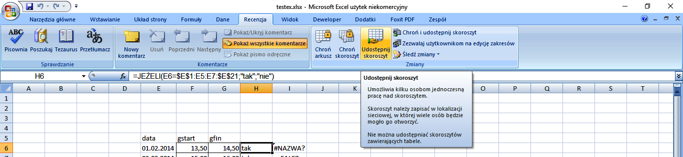

    I have a problem, namely on network FTP I have excel sheets enriched with macros that copy and paste data from a table into a table in another tgz sheet. Main. Because saving the macro saves and closes both sheets, but it happens that another user can view the main sheet and have it running at that time, when you try to save, we get the message:
    [EXCEL] - Sharing Sheet with Macros & Tables on FTP Network: Overcoming Save Errors & Message
    Then the sheet is closed and there is a situation that the data has not been overwritten in the main sheet because another user had it fired.

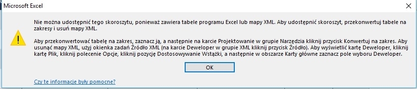

    I wanted to share a workbook, but it contains tables and gets the following message:
    The question on my part is whether it is able to bite somehow differently to be able to share such a sheet?

    My suggestion is related to the test analysis:
    Prot wrote:
    I propose to do a little experiment:
    open two instances of Excel on your computer in each of them open the same test file xlsx try to change anything in this sheet in one instance and keep these changes
    In a normal system this is impossible :cry: however, even theoretically, it is possible with the "workbook sharing" setting on the network server :D
    [EXCEL] - Sharing Sheet with Macros & Tables on FTP Network: Overcoming Save Errors & Message2018-02...png (82.2 kB)You must be logged in to download this attachment.

    That's right, but when I try to share the spreadsheet in the above-mentioned way, she gets the following message:
    I use tables and pivot tables in the worksheet.
    In my opinion - either convert the table to traditional Excel ranges (then sharing should do the problem - although this is also not certain), or transfer the data to the Access database.
    andie
  • Convert Excel tables to ranges or use Access

    As the authors of Offica indicate feature-information-shared-workbook Unfortunately, this feature has serious limitations, including pivot tables :cry:
    I see you have a newer Offic - you can verify the new sharing mechanism there :idea:

    Unfortunately, I also use pivot tables in the worksheet, I cannot convert them to traditional ranges.
    So it looks like the project would be best done as a relational database? Excel, unfortunately, cannot cope with this type of topic
  • #14 17338238
    Darekstw
    Posts: 88
    Excel is not able to cope with this topic, please use a relational database for this type of situation.
