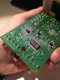

    Hi,
    I have a problem with the GP PowerBank Rapid 2 charger.
    The problem has always been there, but now I have more batteries and it's a waste of time to charge with the old charger since I have this one.
    I put the rechargeable batteries into the charger (the same company as the charger, if it may have any significance) and the batteries are not charged, the dyad flashes red. The manual reads:
    "5. When the LED flashes, it means
    that it has been placed in the charger
    alkaline, zinc carbon, lithium battery, rechargeable battery
    alkaline or damaged battery. In this case, charging
    will not be started. "
    and from the battery we read that its type corresponds to the charger. In addition, in the old / slow charger, the batteries charge normally and work as expected after charging.
    I sense a trick here. The message about the battery failure should encourage me to buy new ones. Except that they only work with this charger. The new batteries in this charger are charged normally.
    Is there an option to bypass this miracle security? I unscrewed it and there is the D3673904 IC. Maybe some of you know something more or have had an adventure with this charger? It was quite popular at one time. Charger - flashes despite working batteries - planned obsolescence?

    harry37 wrote:
    is there an option to bypass this miracle security
    There is - it is enough to buy batteries that are not worn out and do not have some cosmic internal resistance (new, good cells). This type of charger distinguishes between rechargeable batteries and batteries just by Rw.
    The fact that some simple charger charges them does not mean that they are in good condition ...

    You cannot bypass the protection, because it is also a measuring method of the charging process.
    For a colleague, the best solution will be to stick to the old charger, which probably has only a two-half rectifier and a resistor inside, without any logic (so it charges any rechargeable batteries, and you can even charge the batteries with it (don't try!).

    #10 21959127
    EricRobette
    I have the same problem: a red blinking LED when I try to charge any AA or AAA batteries with a GP PowerBank Rapid 2.
    Batteries that have been stored for a long time are no longer charging.
    The funny thing is that my old GP PowerBank charger can charge the exact same batteries.
    I imagine the old GP charger doesn't perform any complex checks; it just sends electricity into the batteries to charge them. And the supposedly "bad" batteries come back to life.
    Using rechargeable batteries means that you are aware of waste, so it makes absolutely no sense to throw away perfectly good batteries just because the charger doesn't work properly.
    I really don't know if this is a kind of "planned obsolescence", but it really looks like it!
    So I recommend using older and more basic chargers instead.
