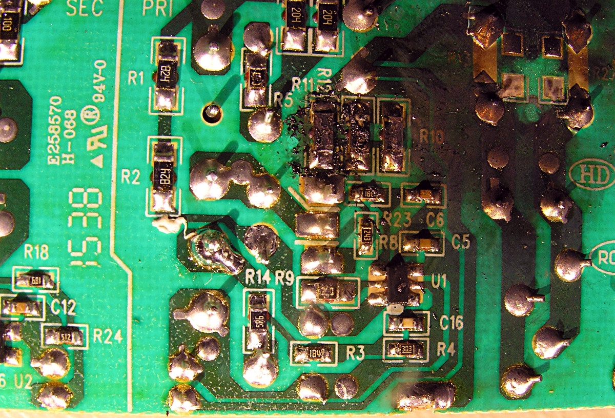

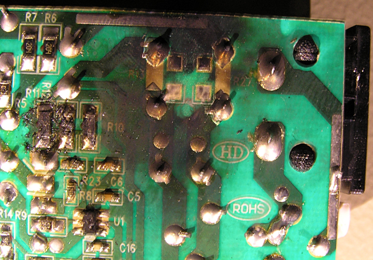

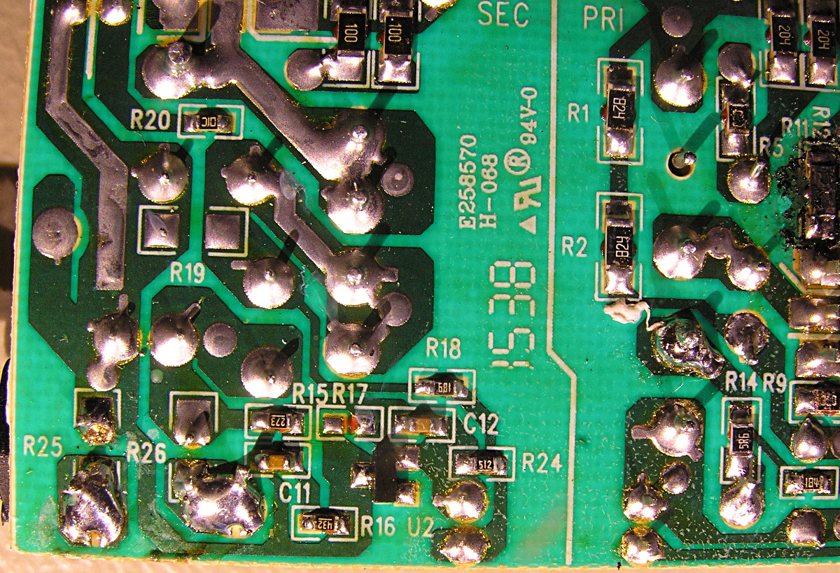

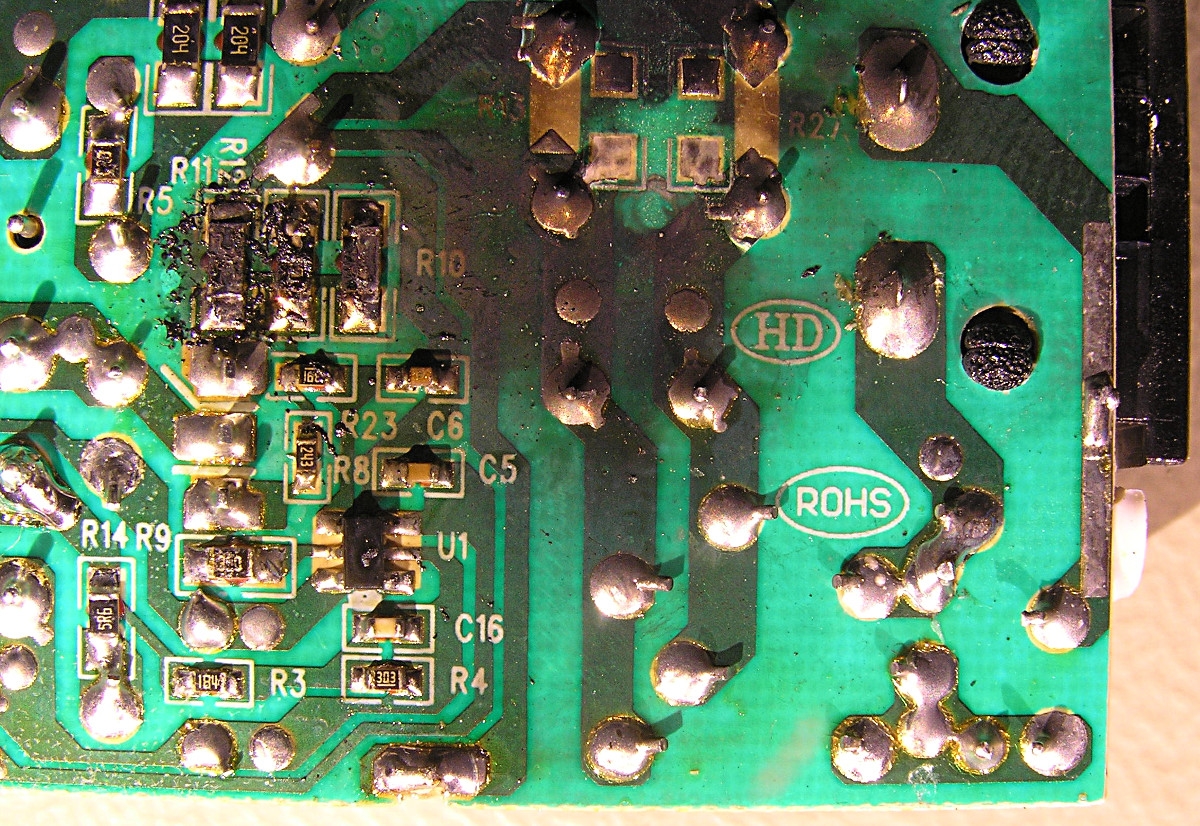

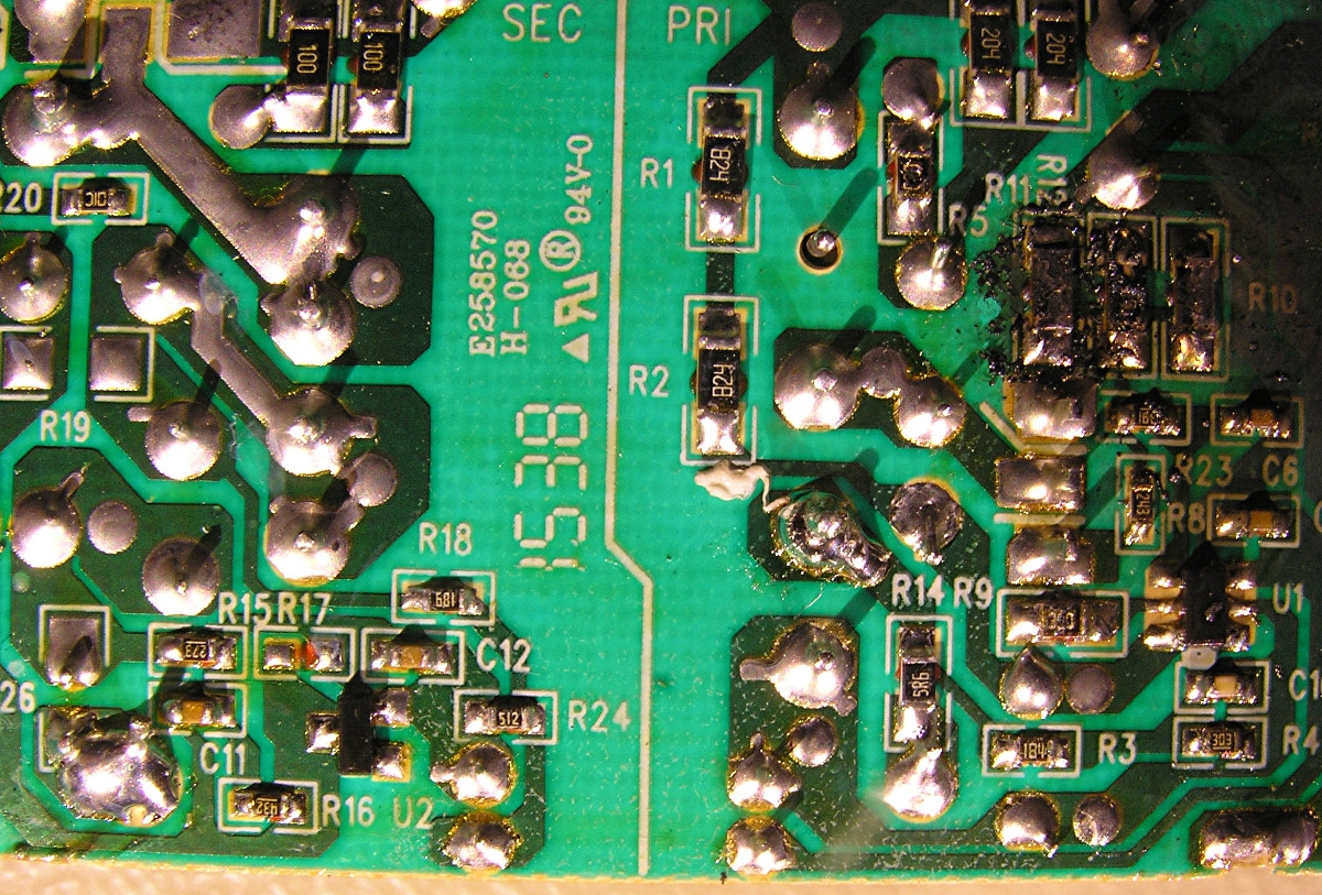

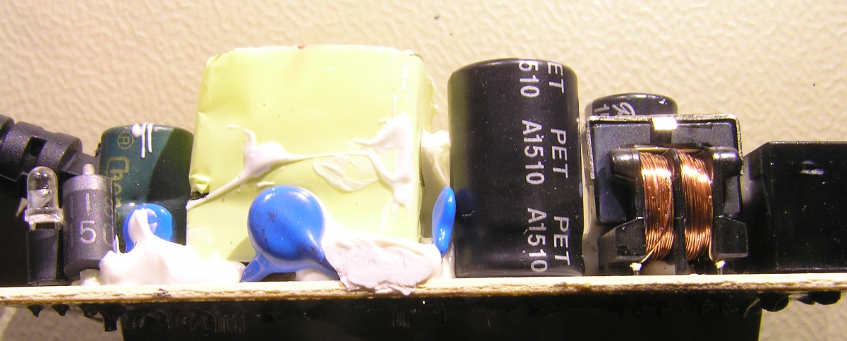

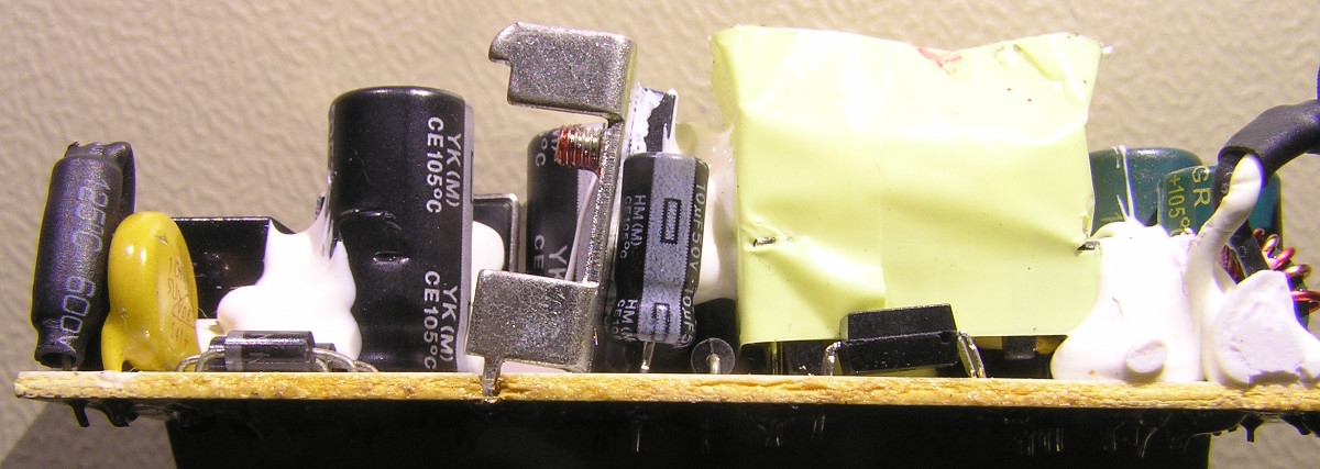

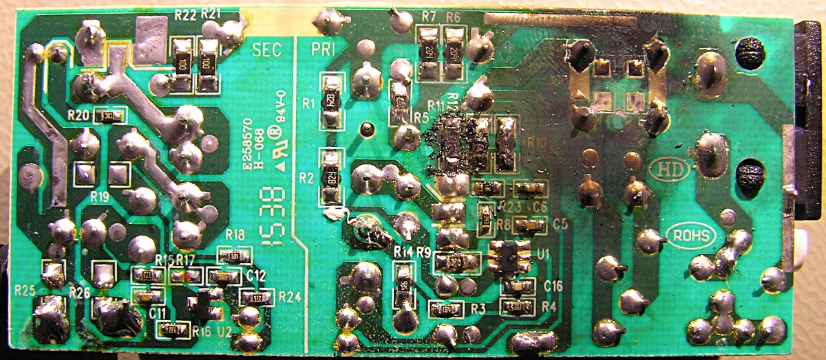

    The power supply is dead, you can see the parameters and the extent of the damage in the pictures below. Visible dark spots were created due to the melting of a thin layer of black sponge, which was the "padding" for PCBs. I know that it is the cheapest to buy another such power supply with given parameters, but maybe someone has knowledge and experience and will help in the repair of this miracle.

    As with any repair of the inverter - it starts with checking the control and keying system. Then the surge protection system, capacitors ... I do not know how difficult this white adhesive will make it difficult for you. Depending on the type, it can go away from the plate and the elements very easily, and maybe so that you have to sweat a lot to remove it ...

    It fell because it was Chinese, although signed with the Soundcraft logo, there is nothing to ask. I have already solved the subject of power, thanks to Colleagues from the forum I have transformed the power supply from Dell. Also, the forum is useful :-) Maybe somebody will someday put the schematic of this Soundcraft power supply, it's worth expanding the knowledge base. Greetings!

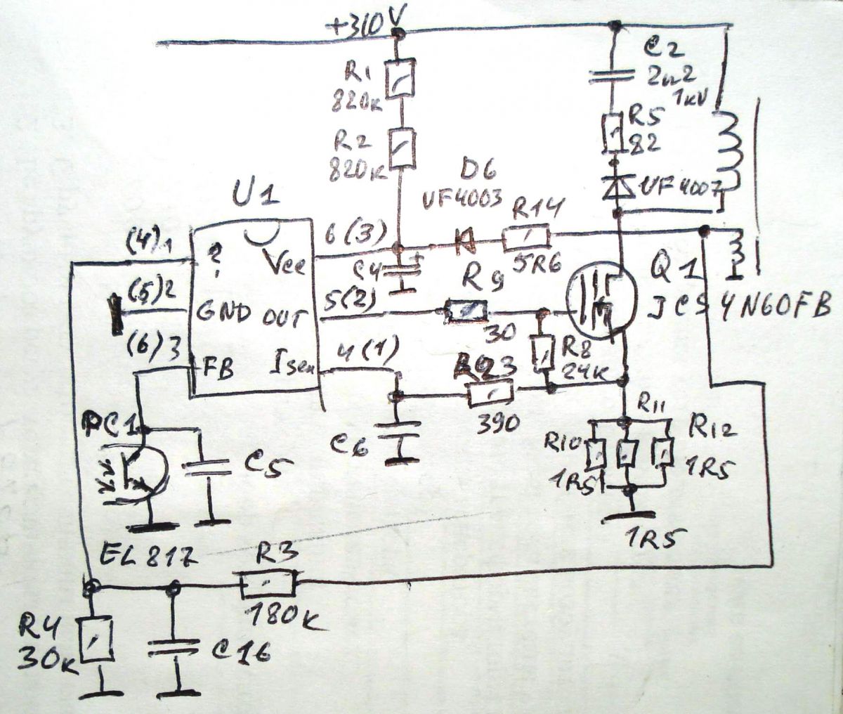

    dersp
    Posts: 9
    Guys, what about the PWM controller at 6 feet and the mark on the casing:
    61F38d
    27A
    Recommend replacing the PSU with 18V 1.5A unit

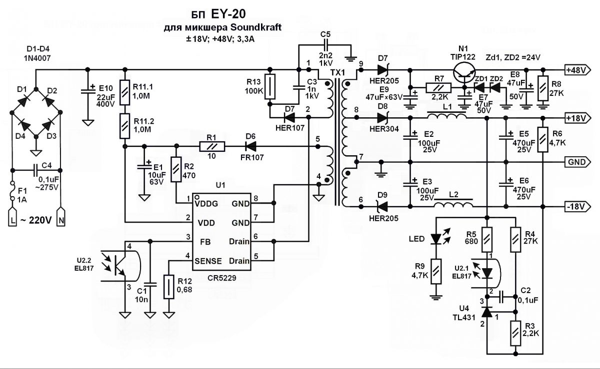

    #12 20073287
    dersp
    Posts: 9
    EN

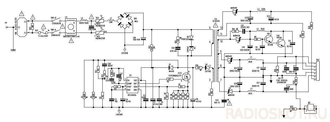

    I once repaired such a power supply and drew a primary diagram, but I have 2 more diagrams in the Soundkrafr folder. I am attaching all 3 files, maybe one of them will suit you.
    EN
    I once repaired such a power supply and drew a diagram of the primary, but I have 2 more diagrams in the Soundkrafr folder. I am attaching all 3 files, maybe one of them will suit you.
