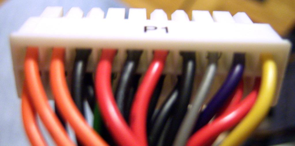

    If you have any basics in electronics, I would be tempted to repair this power supply.
    Create documentation in the form of good quality photos, especially the original page and the 20pin output pins on both sides. As it seems to me that this model has normal terminals compatible with the ATX standard.

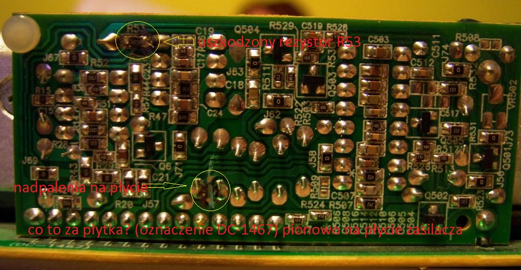

    More accurate inspection shows that two transistors Q1 and Q2 have been dropped, varistor TH1, Resistors R3 and R4 and resistor R53 on the PCB designated DC-1467 - see pictures.
    I have no scheme, and if someone has one or the like, please post. After that, there are tacks on the DC-1467 PCB and on the metal casing and you can see that there were punctures.

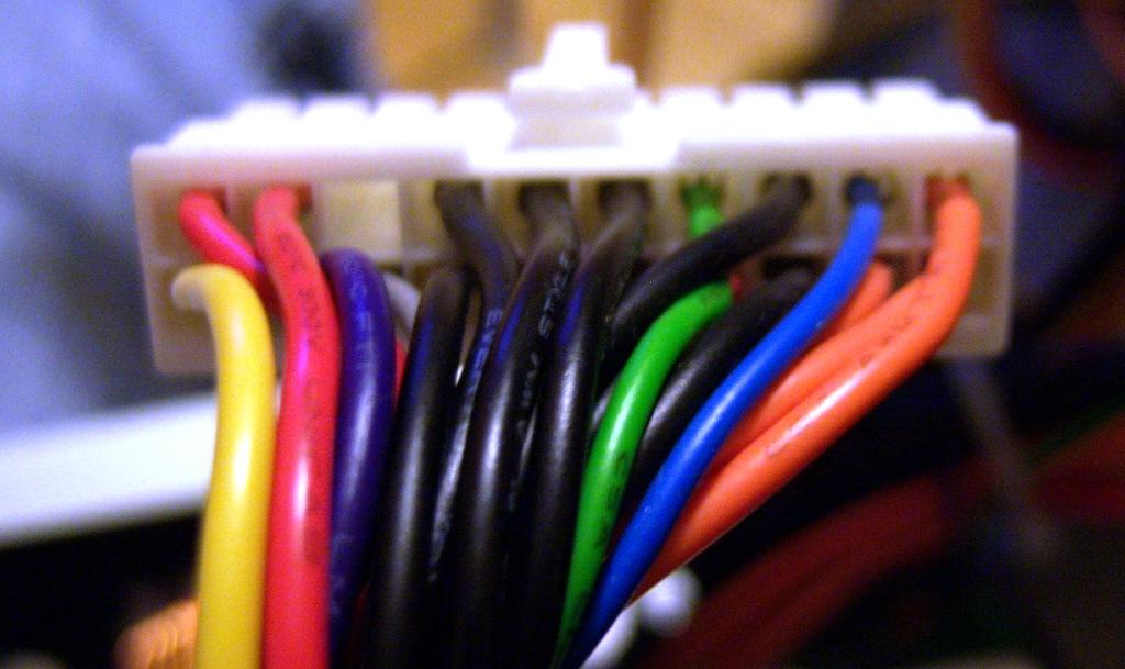

    When it comes to outputting:
    Black - mass, yellow - + 12V, orange - + 3V3, red - + 5V, green - PS_ON, violet - + 5VFP, blue -12V, gray - POK.
    In the plug green is 4 from the right (from below) precedes it: orange, blue, black, green (see photo).
    I for help in repairing - because I can not find such a power supply.

    You know what, but after what you wrote, you do not take it that way, or drop in right ...
    However, the problem is complicated because the power supplies:
    DELL model NPS-100BB A
    DELL model NPS-180BB A
    They have a completely different design, and the mentioned vertical board in the SMD version, and its damage are only readable from the original, and it's rather aPFC on it ...
    There is no scheme for this model, but what are the markings of these integrated circuits on this board and the burned transistors?
    Maybe I can find something similar ...

    The integrated circuits on the board are: L6561 K13351- 8 feet, LM358N, 3L3 1001DL

    You can easily connect another ATX power supply, in this case Dell used the standard, because it is probably GX270 or GX280?
    Dell uses several models of power supplies depending on the model.
    :arrow: Such a power supply?
