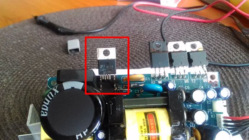

    Hello, I have a question about the layout and I mean the symbol of this layout, it is burnt and cannot be read accurately
    This is a Behringer ub-spsu2 power supply from a Behringer mixer
    Behringer ub-spsu2 Power Supply Burnt Chip - Seeking Layout Symbol Identification & Help

    TOP245

    I'm not quite sure which TOP245 or TOP246 was there
    How much power consumption is written on the mixer housing?

    100-240v 50/60 Hz 40W
    FUSE T 1.6 AH 250V

    TOP245Y at 99% (and in the photo as if it was TOP250Y), I once repaired the UB-SPSU2 power supply, TOP246Y was there, I don't know why, maybe there are some versions of this power supply.
    There is a capacitor on pin 7 of this system and diodes on the primary winding, it needs to be replaced, if something is not there, this system is failing.
    The rectifier bridge also needs to be checked.

    After replacing this system, it does not start !!! One red led is lit at + 48V on the mixer panel, I did not mention anything else, you write about additional exchanges, I am not too much of a specialist in electronics, and exactly what elements do I want to replace?

    The power supply has started, check its output voltage + 5V, + 12V, ? 15V, + 48V
