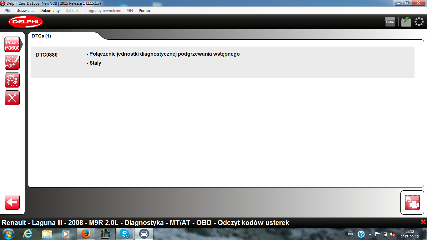

    Witam.Laguna III 2.o dci 150 km 2008 year glow plugs do not heat.
    I checked the candles by unscrewing and giving voltage to the heat, I replaced the candle heating controller - they do not heat any more, I checked the fuses in the engine compartment. And I do not know what is the only error what is true, not from the clip but from Delphi, as in the photo. Maybe there is something more the way will tell someone maybe someone has a diagram.

    Check the relay in the candle heating system, apparently it may have voltage all the time (jammed) and ecu turns it off at the start and sometimes also the module for replacement which controls this relay, zonk

    Vogelek1. You know which relay it is

    Relay, after 1 .. After Delphi 2 clip

    I'm not sure
    1 Under the left longitudinal member
    2 Near the coolers is also mounted
    3 remove the disc from under the engine, look here from the front of the car but more to the left

    Do you have a plus, weight and control on the candle driver?
