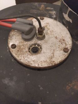

    Hello, I bought a karcher HDS 895 from 1995 and it worried me that using only cold water in the window on the boiler you can see a jumping spark. Therefore, my question is whether the transformer should give a spark all the time or only when switching the switch to 2 stage (hot water)
    Maybe someone tells me exactly where the transformer should be connected, maybe you connected it wrong?

    Hello, I'm not sure exactly where to look for auxiliary contacts 13.14?
    In the photo I have marked the places where the transformer cables come in. Maybe someone will send photos of connections in my washer when I will Karcher HDS 895 (1995) Water Heating Transformer: Sparking Issue, Connection & 2-Stage Switch grateful.

    Gray and brown from what you see.
    Do not move yellow green because it is a protective conductor.
    Well, why do you do this if it's in accordance with the manufacturer's documentation? Do not disconnect the magneto. Due to the fact that it works non-stop, the electrodes dry. When the machine works on cold water, there is a condensation of water from the air and the electrodes can mist up. There may be a problem with the fuel ignition. It will flood the boiler and kick like a locomotive on worn tires ;)

    Thank you for your help, I still asked in the service and they also said that the spark is always given when the engine is running.
