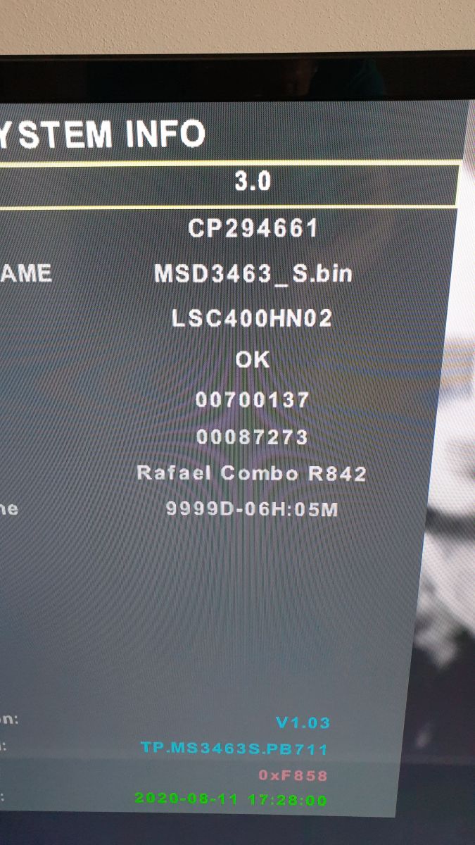

    billobirillo wrote:
    ionut31 wrote:
    Hello, sharp LC-40FG3142E....can help me? with a update firmware
    i have ver 1.02 year 2018
    serial no: A40CF3142EB34S 381616802C3144
    V1.03 (2020.08.11)
    I flash this fw and TV is now corruptt and the image is inverted and only 6 bit. :(
    EDIT: I changed the settings in the service menu (panel settings item) and everything is ok.
  • Service menu panel setting fixed inverted image

    uiqjirka wrote:
    Need Sharp LC-40CFE4042E Firmware v1.03: TP.MS3463S.PB711 Motherboard - Satellite Tuner Issue
    billobirillo wrote:
    V1.03 (2020.08.11)
    obviusly! this file is for the panel LSC400HN02
    your tv mounts a panel, most probably, JE400D3HD1UX

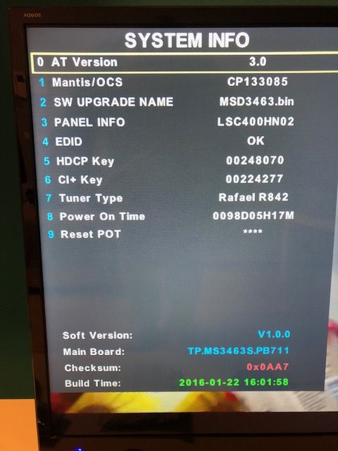

  • #33 19147115
    uiqjirka
    My panel is LSC400HN02. Fortunately, everything is fine and it was enough to set the preset panel ID and color bits.

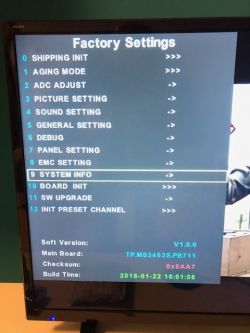

  • Confirming software version V 0.01 after reset

    kjhjkljl wrote:
    So now the version of the tv software (that I can see in settings) is: V 0.01
    Is that correct?
    most probably is correct
    I don't know the version, because the file is named 0xAA7 (version not reported)

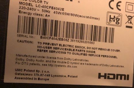

    can you write the serial number of your tv?
  • #43 19274309
    skab
    Of course, this is the serial number of the TV: B40CF4042EB08Z 36119260201093
    Here is also an image:
    Thanks for your help

5. MSD3463.bin vs MSD3463_S.bin – which one?
Use MSD3463.bin for USB updates. MSD3463_S.bin is for external ROM-programmer work only [Elektroda, 19276396]
6. The TV shows inverted picture after upgrade—fix?
Enter service menu (MENU 1147) → Panel Settings → select your panel ID or “Init TV”. This solved flipped 180° images on v1.13 [Elektroda, 19144970]
7. What if only a ‘K’ or factory text stays on screen?
Run MENU 1147 → Init TV. This single action removes the overlay permanently [Elektroda, 18633356]
