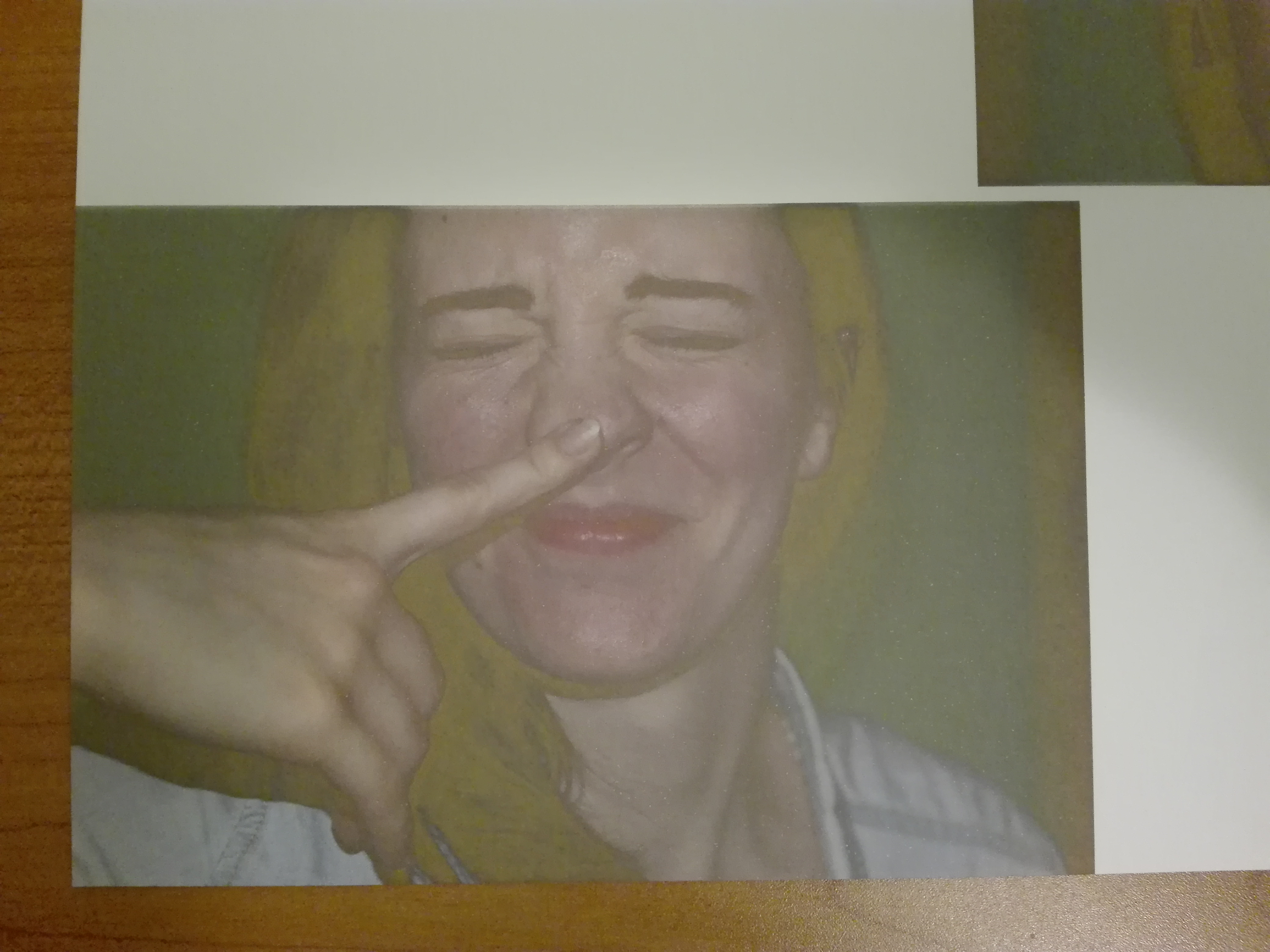

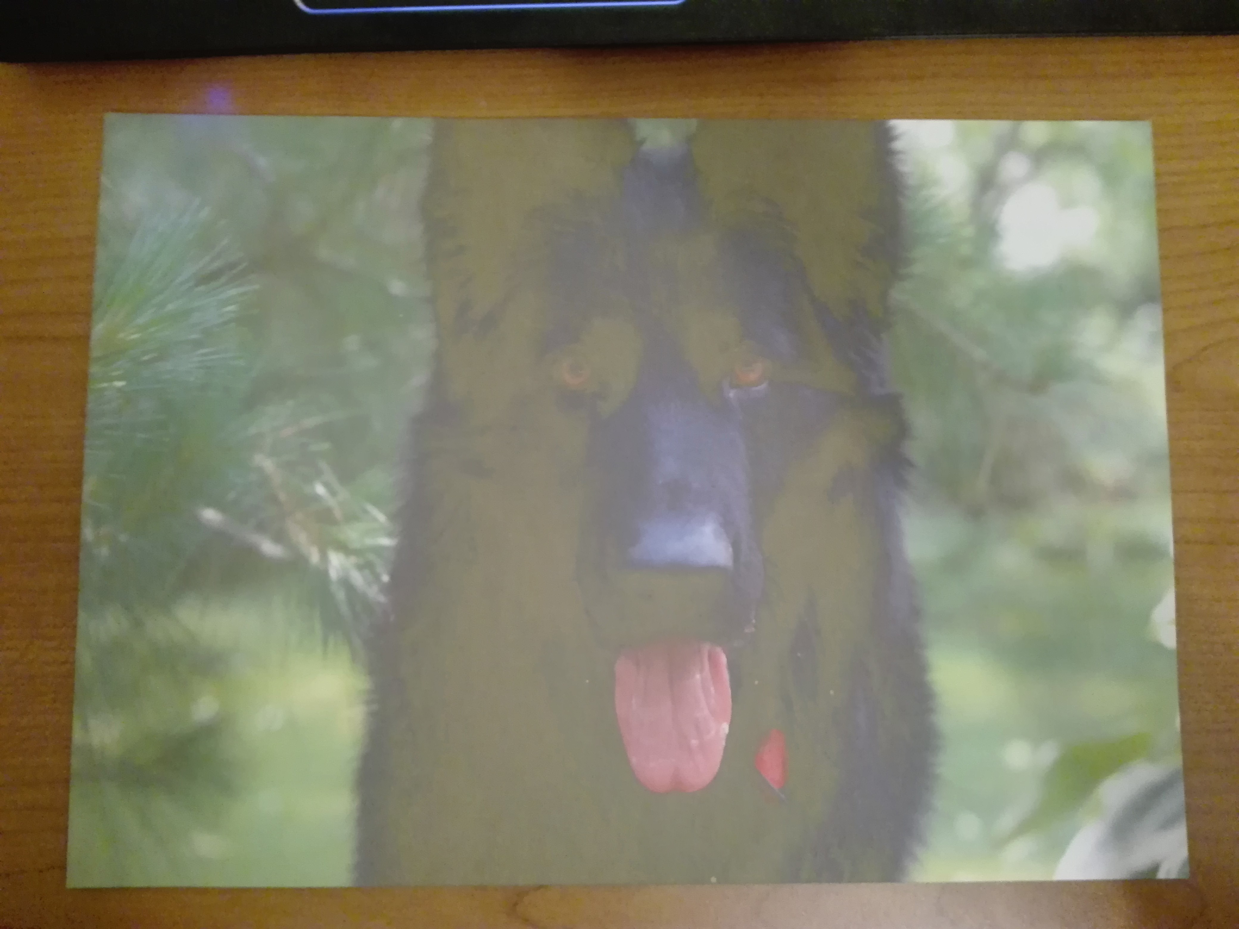

    Hey, I bought a new printer a few days ago. Printed photos are different from photos. I don't know how to describe this error myself, that's why I enclose the printout and the correct photo.
    • Epson XP-342: Mismatch in Printed Photos Color Representation - User Experience IMG_2602.JPG (6.86 MB) You must be logged in to download this attachment.
    • Epson XP-342: Mismatch in Printed Photos Color Representation - User Experience IMG_20180201_003401.jpg (2.57 MB) You must be logged in to download this attachment.
    • Epson XP-342: Mismatch in Printed Photos Color Representation - User Experience IMG_20180201_000336.jpg (1.34 MB) You must be logged in to download this attachment.
    • Epson XP-342: Mismatch in Printed Photos Color Representation - User Experience IMG_2686.JPG (6.11 MB) You must be logged in to download this attachment.

    #7 17004983
    fifek62
    Posts: 458
    Help: 66
    Rate: 288
    Matte paper is matte photo paper. You probably print photos from Epson Easy photo print where there is no option to select plain paper. Print photos from the Windows Photo Viewer. There, at the bottom right of "Options", then "Printer Properties" and uncheck "Borderless" and select plain paper. Only then will it print in normal colors. Choosing photo glossy or matte Paper, and printing on plain one results in just green photos.

  • #9 17005421
    Megi94
    Thank you for your help, the colors are fine :)
  • #10 17005425
    Megi94
    I set "plain paper" and deselected the border.
