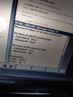

    I bought an E61 525D 177 hp 2004.
    After warming up the engine (on average after an hour, sometimes two hours) I started to throw a turbine actuator error, 3F57. Then the car goes into limp mode, no power. It helps to turn off the car, wait about 15 minutes and start again.
    Steps I've taken so far:
    - replacement of the exhaust manifold with a cast iron one (the old one cracked)
    - replacement of the wiring harness between the computer and the adjuster (no 12 V voltage on the adjuster)
    - replacement of all gaskets (at the turbine itself, at the IC, at the EGR).
    - checking the tightness of the intake (I have a problem here, because I hear a whistling sound somewhere, but I don't know if it is the turbine whistling slightly and giving the effect of whistling from somewhere else)
    - setting up another adjuster (same, adjuster error)
    - replacement of fuel and air filters, checking the pressure on the rail, it is OK
    - checking the geometry cable, it works loosely
    - replacement of the boost pressure sensor in the manifold and its test
    - removing the swirl flap - were nice, but I preferred not to risk it
    - performing the test of the controller in DIS - it walked about half an hour from left to right, never once hung up or stood still.
    When adding gas at a standstill, the adjuster almost does not move at all, and should it twitch?

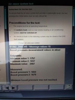

    I did some DIS tests today
    error number 3F57
    DIS shows that the minimum boost value has not been reached: (controller problem? or turbine problem?)

    First of all, measuring the top-up while driving.

  • #8 17024849
    DejayPablo
    Posts: 342
    Rate: 82
    I already know what's going on, VCDS has a calibration procedure for this adjuster, and BMW DIS or GT1 does not have it, maybe this function was simply not required in BMW.
    The case was solved, I replaced the capacitor in the adjuster, everything started working. I disassembled the turbine to be sure and glassed it inside, so that the geometry was loose, everything works.

  • #13 17272907
    DejayPablo
    Posts: 342
    Rate: 82
    The problem turned out to be the turbine, which had a baked geometry and thus threw the controller error, in addition, the DPF was clogged and therefore there were such problems.
