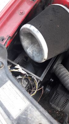

    Now I saw at all that I have a sponge filter so black, I will put in photos how to clean it because I heard that it is not exchanged.
    Well, the engine is in good condition, even in the old one, which is now no less, but you can see that it is old because it is dark as tar.
    if a sealed engine, pour in such oil link
    and as for the cone, it is not exchanged, it is soaked with an appropriate agent, e.g. link

    Something like how to clean it or embrace it, I don't even know if it's cleanable

    But what you have sent to some scrolls is, and this is the type with some sponge this filter, as you can see it probably does not do the same.
    in my opinion it is the same, here you have for sponge: "The oil was created for soaking wet air filters (sponge and mesh)" castrol link
