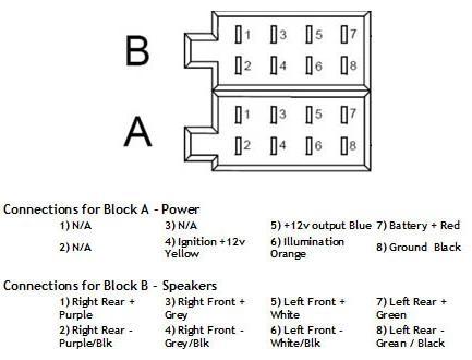

    I bought the Audi A4 B6 2004 station wagon last week.
    A chorus 2 radio is mounted in it. It was only in the evening that I noticed that there was no backlight on the panel buttons. The display works normally the same as the tiny TP button window. Is it possible to solve this problem?
    The problem is also that the radio does not turn on / off after starting / switching off the car.
    Thank you in advance for your reply and I apologize if there has ever been a similar problem discussed but I haven't found anything on the forum.
    Regards Kamil Kupiec

    On these radios, the backlight turns on together with the lights in the car. on the sixth pin of the power cube after switching on the lights must be 12V. Maybe someone was fumbling in the cables, you need to pull out the radio and check. It doesn't hurt to check the car's fuses.

    Chorus 2 has no backlight from the installation on a separate cable, neither the plus after the ignition. These signals follow Can'em if I remember correctly.
    • Audi A4 B6 2004 Wagon, Chorus 2 Radio: Button Illumination & Auto On/Off Issue - Kamil Kupiec IMG_20180207_080919.png (111.57 KB) You must be logged in to download this attachment.
    • Audi A4 B6 2004 Wagon, Chorus 2 Radio: Button Illumination & Auto On/Off Issue - Kamil Kupiec 3992307600_1503244804.jpg (49.83 KB) You must be logged in to download this attachment.

    Check first that no one has been processing power cubes, because people can do various wonders, this could be your whole problem.

    I'm a little green but it's about the A pin 4 from turning on the ignition and pin 6 from the backlight? I apologize in advance for lack of knowledge in this field ?

    Brown speakers, black power supply. Minus brown, plus solid red with a strip, the third wire is K-line.

    Is the radio sticker labeled? If it is as above (gray), then no. There should be a third cube.

    What will the pin give you, as no further electronics? Chorus 2 takes these signals from Can.

    You need a plus after the ignition switch, adapter for the third cube if there is an amplifier. Backlight is an option, depending on the radio model.

    • Audi A4 B6 2004 Wagon, Chorus 2 Radio: Button Illumination & Auto On/Off Issue - Kamil Kupiec oświetl.jpg (47.3 KB) You must be logged in to download this attachment.

    Subject to close? it turned out that there was no one cube connected, which hid behind the air conditioning panel. The backlight works, switching off after removing the key works. The current station and RDS are displayed next to the clocks.
    Thank you all for your help.
