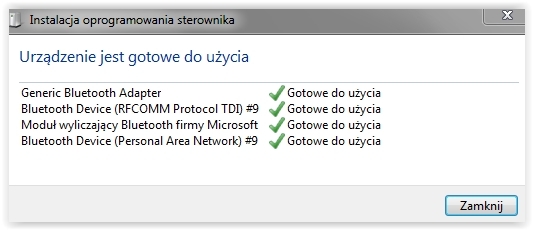

How can I completely remove the BlueSoleil virtual Bluetooth network adapter and restore Windows 7 x64 to its original public-network state after uninstalling the driver?
The BlueSoleil virtual Bluetooth adapter kept recreating itself, and in this case the only thing that finally solved it was reinstalling Windows [#17026224] Before that, the suggested cleanup steps were to uninstall every Bluetooth device and Bluetooth network adapter in Device Manager, including any Bluetooth-named entries under network adapters [#17020455] It was also suggested to disable or delete the connection from the Network Connections window, use Device Cleanup Tool to remove ghost devices like “Bluetooth (Personal Network),” and check services.msc for any service that might be respawning the adapter [#17020554][#17020749] Another suggestion was to manually clean registry entries for the equipment/manufacturer and remove leftovers such as the IVT Bluetooth driver entry `Btcsrusb` / `btcusb.sys`, after uninstalling Driver Booster/IObit as well [#17020658][#17021111] In the reported case, even deleting the registry entries in Safe Mode did not stop them from regenerating, so the system reinstall was the final fix [#17021264][#17026224]

    Most likely, the virtual network adapter driver has been installed - go to the device manager (computer -> properties -> device manager) and see if you have the Bluetooth section. As is, expand and on each device, right-click and "uninstall device", or go to properties and you will find the same on the driver tab. As mute or done, expand the network cards - see if there is anything with Bluetooth in the name. If it is, the same - uninstall.

    Falconett wrote:
    I would like to remove it, but it is impossible:
    How is that? And is the device listed in the device manager?

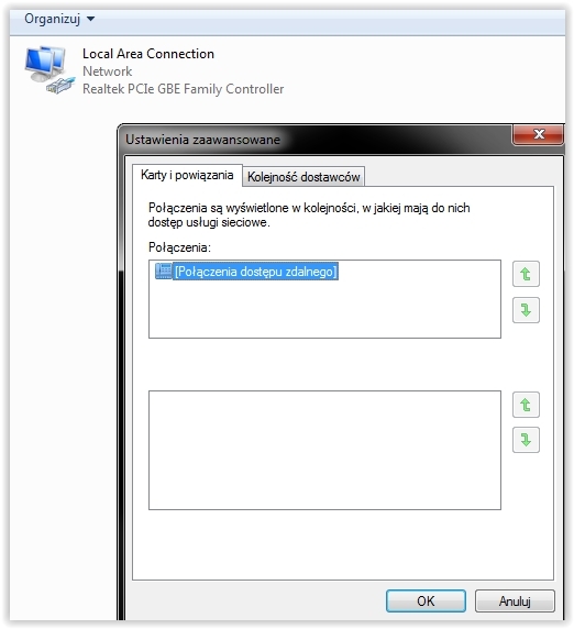

    Type in OS search "display network connections".
    Once you find this place (so perfectly available in XP), you can disable the connection - this will remove the network from the tray. You can also delete.

    Falconett wrote:
    there is only the desired combination.
    So it shouldn't be visible in the tray.
    Falconett wrote:
    after reboot, it returned and additionally a warning triangle appeared with an unidentified USB device.
    So he is physically absent? In that case, remove them, e.g. with DeviceCleanup:
    http://www.programosy.pl/program,device-cleanup-tool.html
