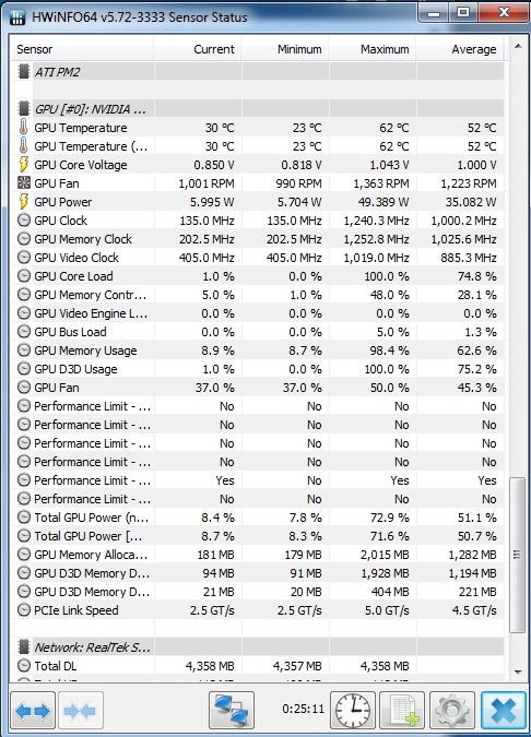

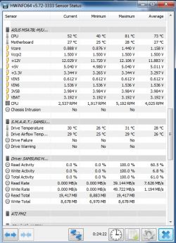

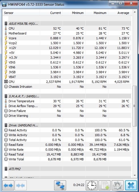

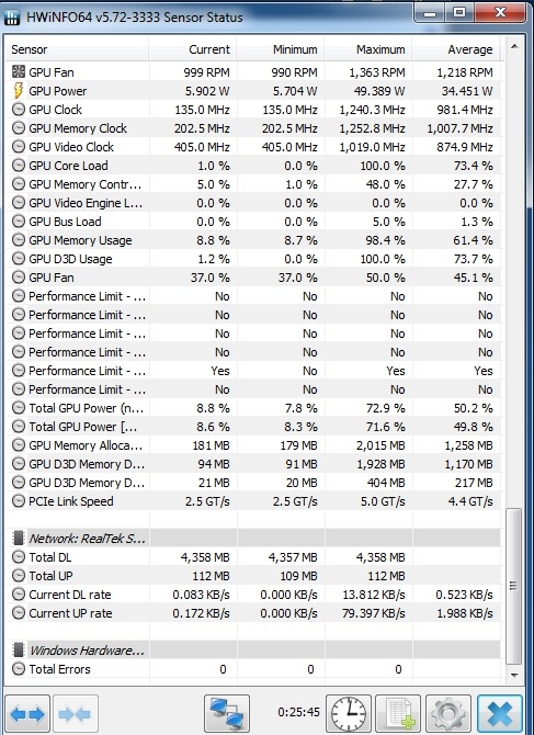

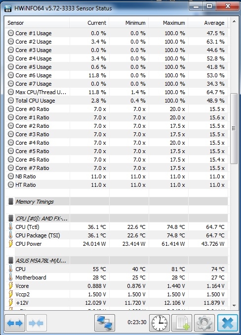

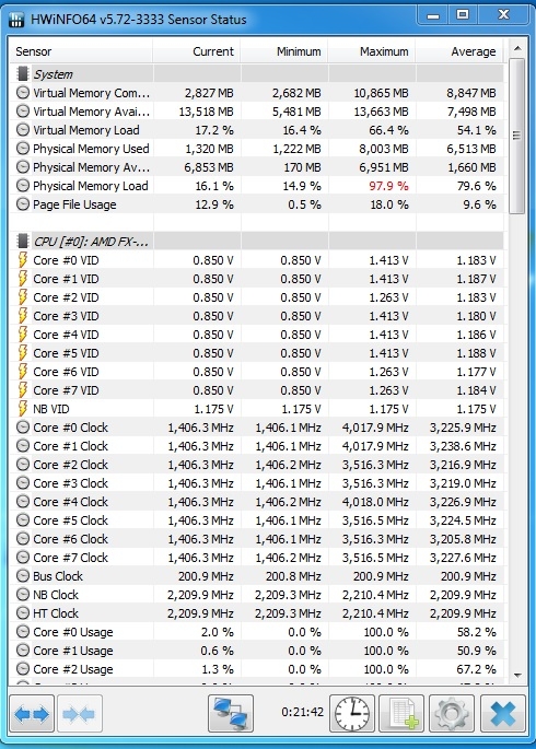

    Install and run HWiNFO in "sensors only" mode. Play a dozen or so minutes and send screenshots of all parameters. We'll see how much it heats, the paste can be replaced if it is old, if it doesn't make sense to move, unless someone has applied it too badly / too much.

  • #13 17041123

    Now I could test it because yesterday a few hours downloaded the game update and I could not do anything.
  • #14 17041147
    icosie
    Posts: 1908
    Help: 298
    Rate: 239
    Ram used 100%, you probably have traps in the game, see what programs use ram before launching the game and maybe get rid of them.
    As for the temperature, only the processor has over 70 ° C, so you can replace the paste as it is old. Although I would think about buying some better cooling.

    There are just no clipping, normally only a loud windmill is played. Maybe I will. There is also nothing like this that does not load the framework because the computer has a fresh format, only drivers, basic programs and origin + NFS.
    And when it comes to graphics card, what would be worth buying instead of this?
