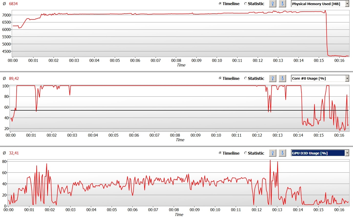

    What are the temperatures?
    Install and run FRAPS, install and run HWiNFO64 (sensors only) and turn on logging to the file (bottom right corner of the program window). Start the game, play for 20 minutes. and put the log from HWiNFO in the attachment (after packing).
    By the way, Process Explorer may be running in the background and give a screen from it.

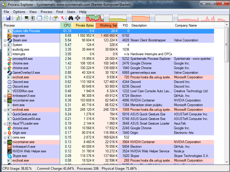

  • #4 16998672
    bnx1122
    Posts: 7
    Unusual 100% CPU Usage and Reduced 20-30 FPS in Games on AMD FX-4100 and Nvidia GTX 650 Setup
    I noticed that when something turns on, this application always takes 80-90%, and the System Idle Process shown in the picture is also present and takes up a lot of CPU. And there is something weird on the HWiNFO log because it only reads 1 Cora and my CPU is Quad-Core. What do you think about it?
    • Elektroda.rar (26.87 KB) You must be logged in to download this attachment.
  • Only one core detected; enable all CPUs in msconfig and BIOS
    #5 16998751
    Kasek21
    Posts: 45667
    Help: 4981
    Rate: 3549
    Yes, only one core is detected.
    WinKey + R: msconfig [enter] -> tab | Boot | -> Advanced options -> Check Number of CPUs and select 4.
    If that doesn't help, check the BIOS setting to see if all cores are enabled.
    Plus high memory usage.
    This process means the opposite, i.e. free resources.
