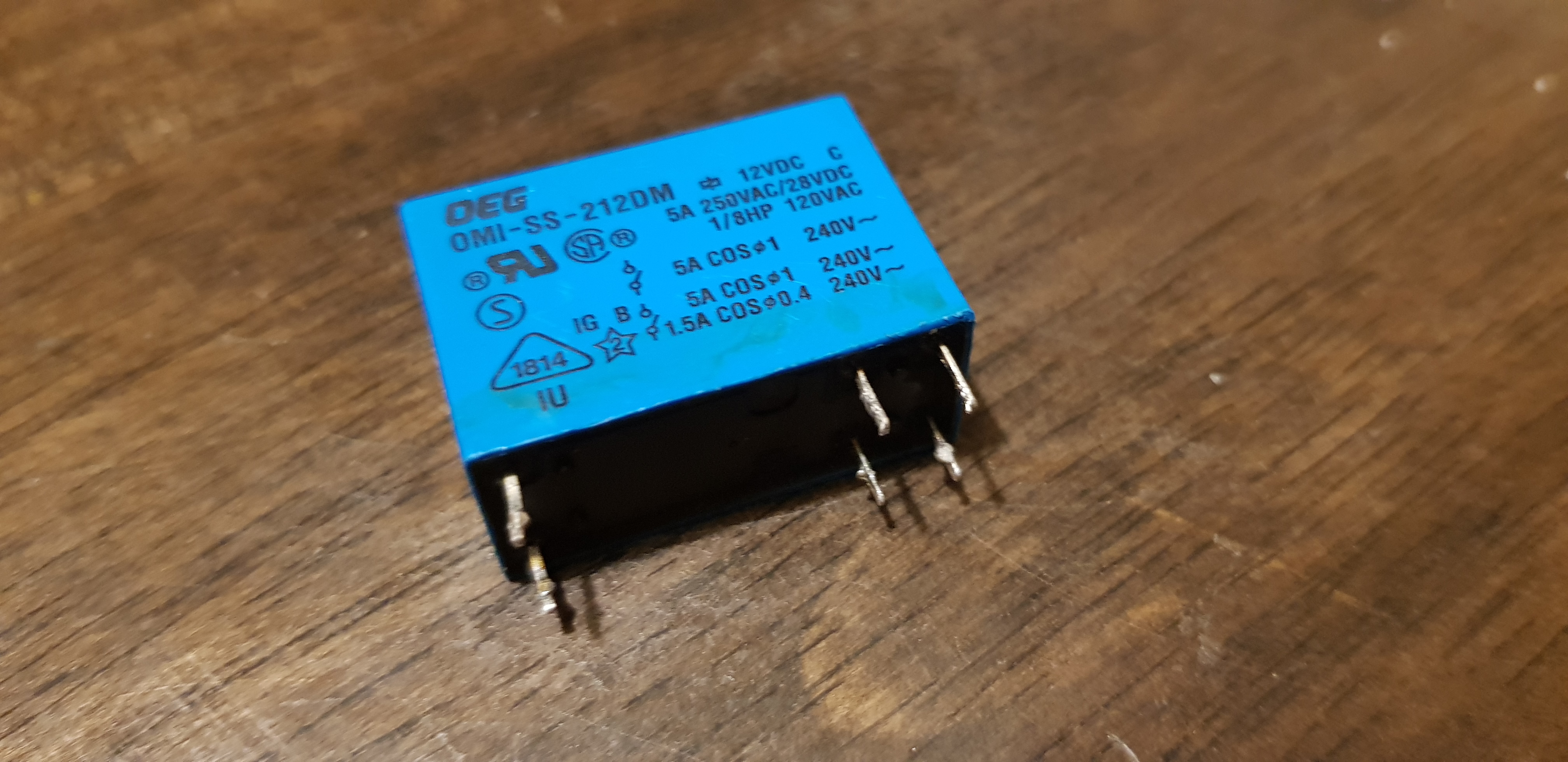

Can I assign the standard terminal numbers 30, 85, 86, 87, and 87a to this relay?
You cannot label this relay as 30/85/86/87/87a because the pictured part is not a changeover relay with an NC contact; it has two coil pins and four contact pins arranged as two normally open pairs, so it will not fit a diagram that needs NC contacts [#17022955] [#17022952] [#17023783] The two single pins on one side are the relay coil, and the other four are the switching contacts [#17022955] [#17022961] The exact numbering cannot be given without the specific relay pattern or datasheet [#17022961] You can verify the coil by measuring resistance between the two single pins, and confirm the contact pairs by measurement [#17022961]

    Hello, I have a relay like the attachment. However, I need to mark his contacts (30, 85, 86, 87, 87a). Please, tell me - can I say in this relay?

    I'm afraid that my friend "MBB94" has the mark of the normally open and normally closed relay and in the picture there is a 2 x normally open relay and it will not fit

    Two separate contacts on the left (in the picture) are powering the relay coil. The other four are make contacts - in pairs - the pair closer to the center are moving contacts, distal / extreme fixed. On the one hand, you have two contacts (movable and fixed) of one pair, and on the other, a similar pair to switch on the second circuit. What else do you want to know?
    This numbering colleague took from a pattern, we do not know from which and we can not answer this question without knowing this pattern.
    These two single contacts are probably a relay coil (between them should be some resistance, to measure with a device)
    The other four contacts are from the contacts of the relay, with which it switches on, it can also be confirmed by measurement.

    I think so exactly. But as the diagram has, the above picture with the description should help.

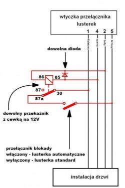

    mbb94
    Posts: 14
    Yes, I have a diagram for which I need this relay. That's him: Designating Relay Contacts: Identifying 30, 85, 86, 87, 87a on Attached Relay Model

    Well, the diagram shows that we must have a relay with NC contacts, so the one in the picture will not come

    Ok thank you for help. All clear :)
