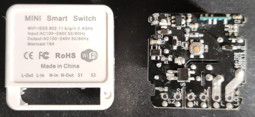

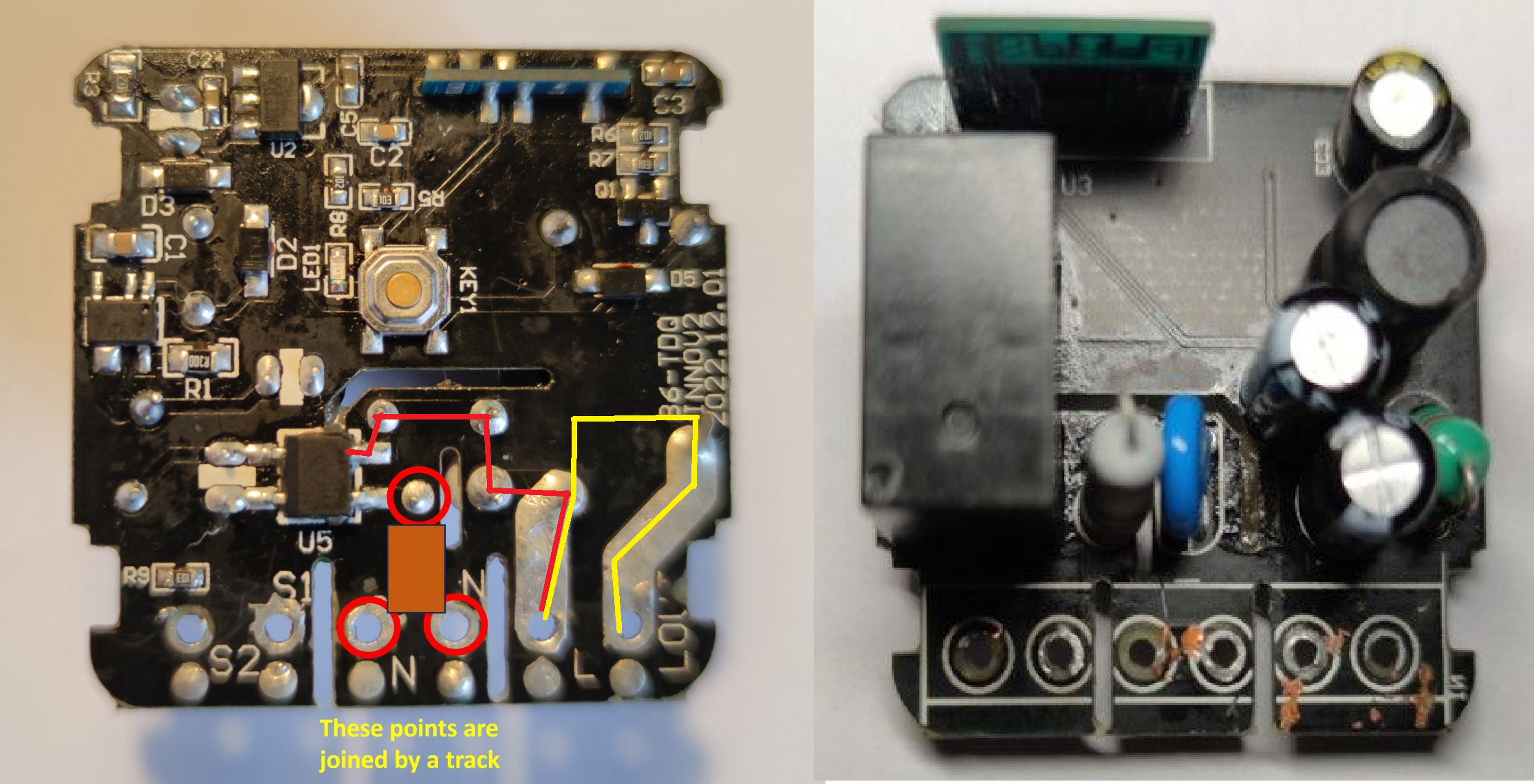

    Hi everyone.
    This is my first post on this site. I am a beginner and I ask for your help.
    I have the following Smart Switch model [86-TDQ INNOV2 2022.12.01] and I would like to understand where and how to intervene on the PCB to create a dry contact.
    Thank you
    Close-up of the interior and casing of a MINI Smart Switch.
  • #2 20826139
    Posts: 14771
    Rate: 12914

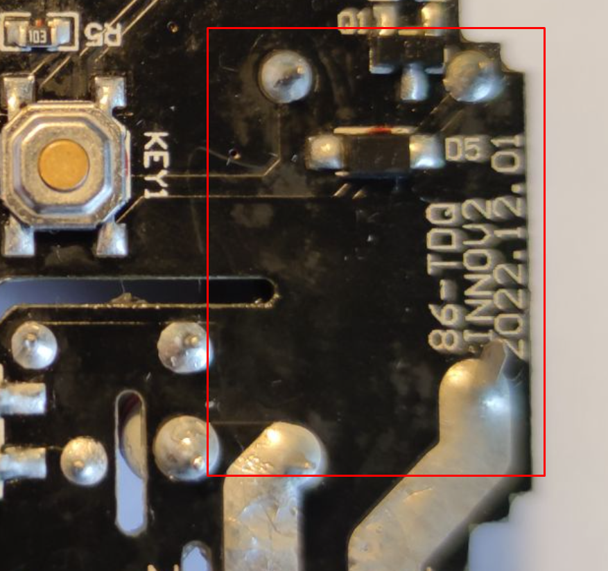

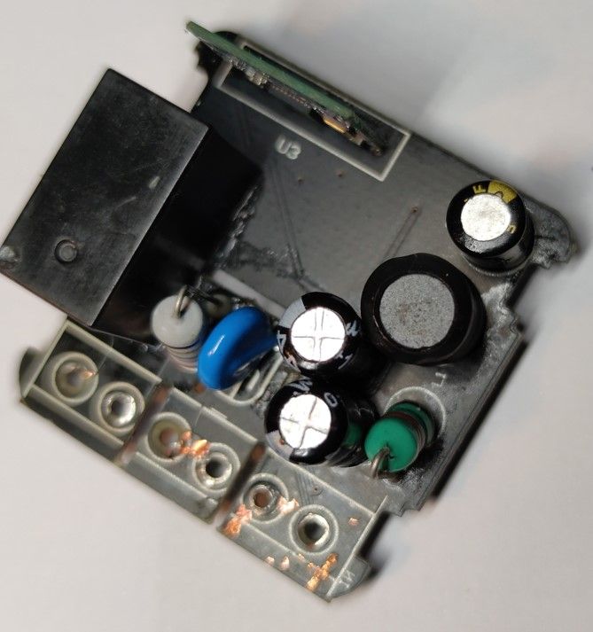

    Hello, the following photo is low quality and it's hard to tell where the traces go. Can you post a better quality picture?
  • #3 20826162
    fedon55
    Posts: 8
    Thanks, I'll do it right away. I hope it goes well.

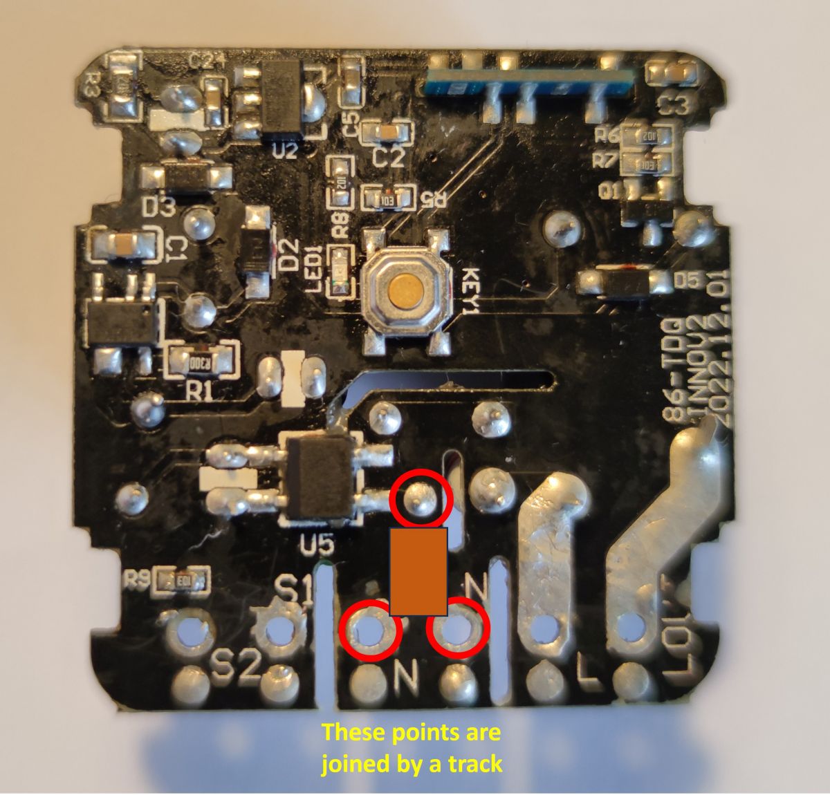

    View of a circuit board with various electronic components and circuits.
    These points are joined by a track
    Close-up of a circuit board with three points highlighted in red circles, connected by a path.

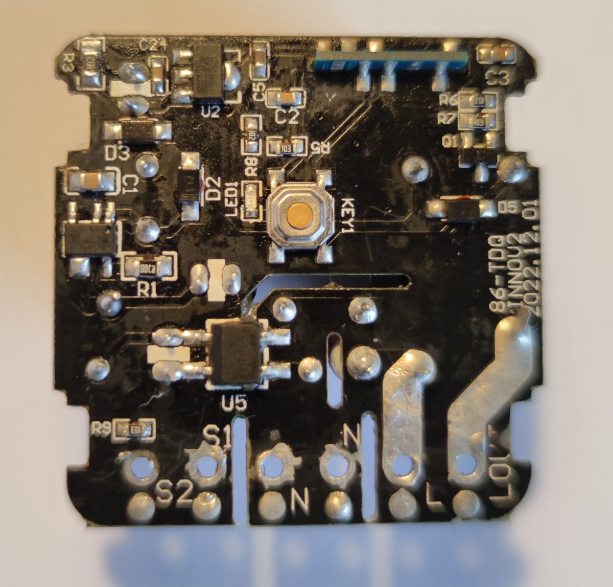

  • Need top-side board photo to trace relay contacts
    #4 20826785
    Posts: 14771
    Rate: 12914
    I know that in the past I have shown how to do it precisely in Paint on the picture submitted by user, but in case of your picture, I can't see exactly how are the traces routed. It seems that contrast is insufficient or the black soldermask makes it less readable.

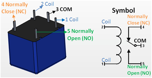

    The general rule of thumb is that you need to:
    1. find out where the relay contacts are (normally closed, normally open, and common):
    Illustration showing a relay with contact and coil labels and a relay symbol diagram.
    2. find out how 230V (or 120V, depending on your country) goes to the power supply circuit (full bridge rectifier, etc)
    3. find a way to cut out totally the mains power from the relay contacts but still route them out so they can be used as a dry relay. Depending on the board design, it may be problematic and require making an extra route with an isolated wire
    Maybe posting a top side of the board could help with locating the relay, but still you'd need to track the traces correctly.
    Maybe is relay there?
    A section of a circuit board with visible traces, electronic components, and a black solder mask.
    If that's where relay is, then you might need to cut L in such a way that it is still connected to the power supply, but does not connect to relay, but you would still need to somehow route out the second wire from relay...

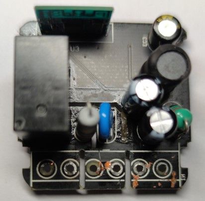

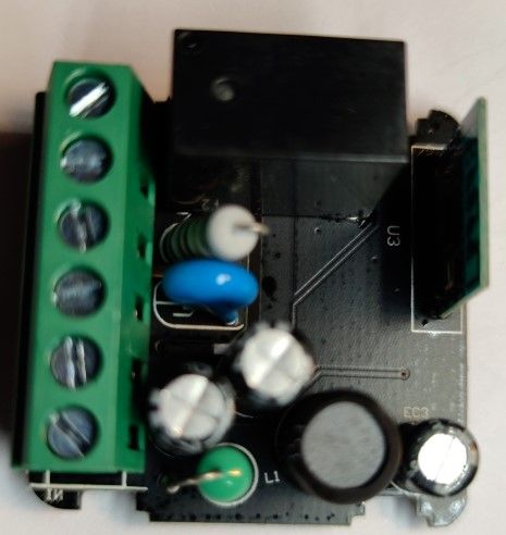

  • #5 20826974
    fedon55
    Posts: 8
    Sorry
    I didn't see your reply
    Circuit board with green connector and various electronic components. Close-up of a circuit board with electronic components.

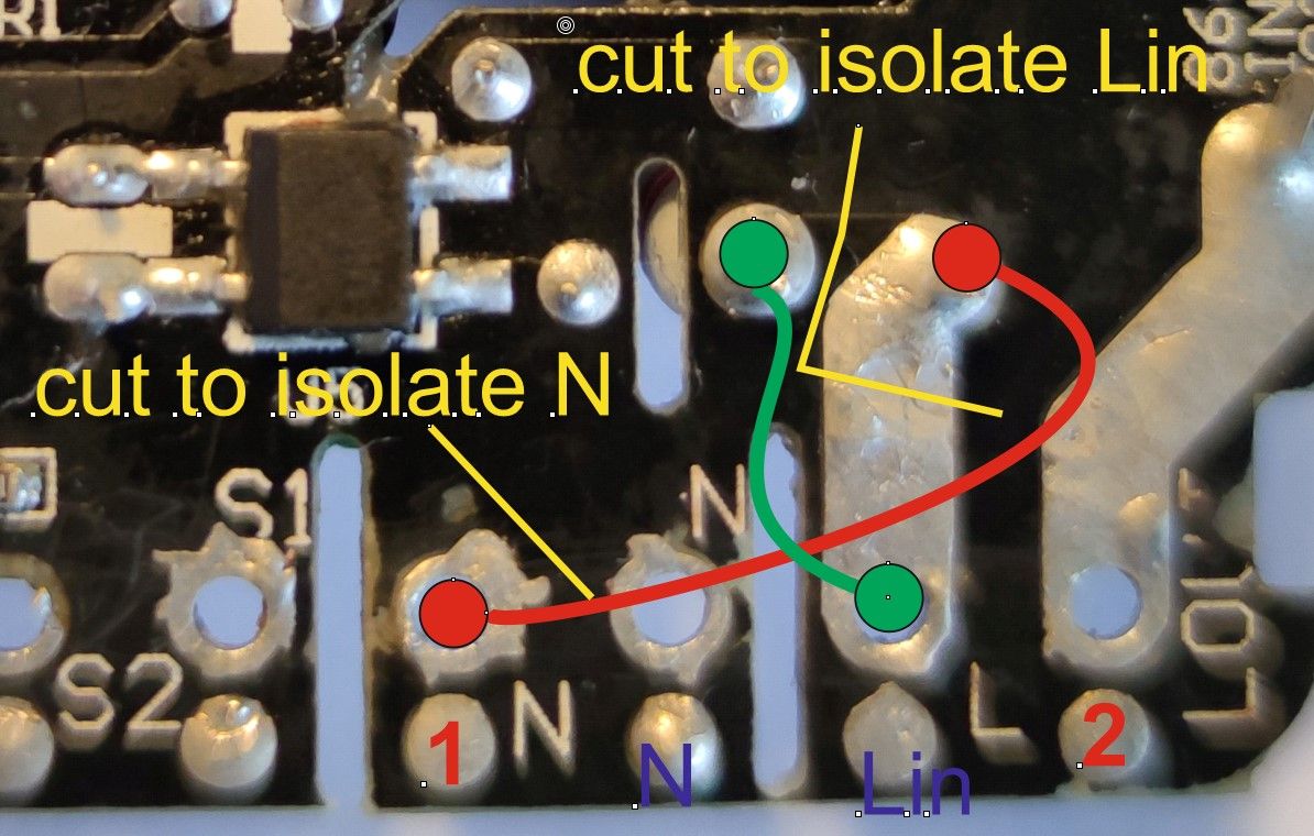

  • #6 20826994
    Posts: 14771
    Rate: 12914
    Yes, but in the linked topic, I could clearly see the copper traces under the purple soldermask, and on your photo, I am not sure if I can see it.
    Can you make a photo showing the board from above?

    Please take all my suggestions with a grain of salt, because I may be wrong, it's hard to do that remotely, but here is how I see it:
    View of two circuit boards with marked current paths; one path marked in red, the other in yellow.
    The red path is the current path for LIVE wire that goes through the fusible resistor to the full bridge rectifier.
    The yellow path is the path that current takes through relay when it's closed.
    The problem is that one of relay pins is on the way....
    If you want to have a dry relay here, you need to:
    Close-up of a circuit board with annotated paths and marked modification spots, such as relay and additional wire placement.
    The very important problem is that mains is very, very dangerous!. If you really want to do it, you must make sure that there is at least of few milimeters gap between live side and dry side! You should really consider twice whether you know how to do it in safe manner. If you do it incorrectly, you may later get a short that will put mains on your dry contact.
  • #9 20827040
    fedon55
    Posts: 8

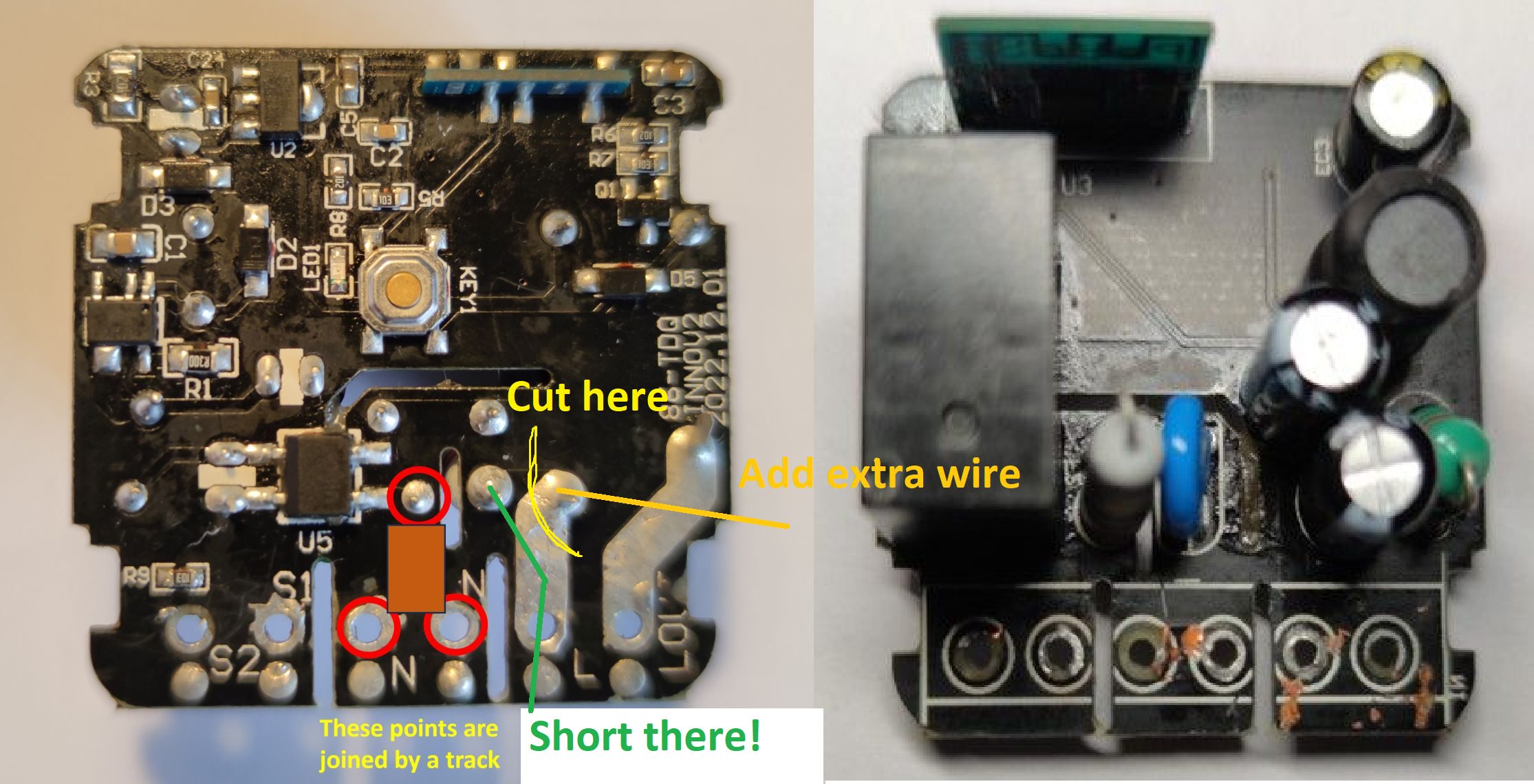

    We can summarize:
    1 - Shouldn't I cut the track with "N"?
    2 - Which contacts will be "Lin" and "Nin"?
    3 - Which "1" and "2" are dry contacts without power?
    Thank you.
  • Dry relay mod requires extra wire and clearance

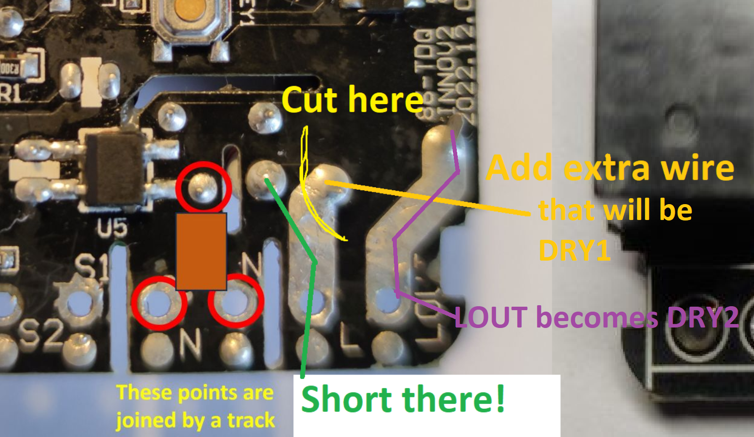

    #10 20827048
    Posts: 14771
    Rate: 12914
    Unfortunatelly there is no easy way to reroute the existing N contact. The board design was not made with a "conversion to dry relay" in mind.
    If you follow my suggestions, then each terminal will keep it's role, except the "Lout" will be "Dry 2", and the extra wire you will solder to second relay pin, will be "Dry 1".
    Close-up of a circuit board with markings for modification.
    The extra wire will not be routed to any of existing terminals because I can't see a clear way to do it, but it can be routed out of the board.....
    When you do this modification, make sure to keep a proper distance between live and dry terminals.
  • #11 20827093
    fedon55
    Posts: 8
    If I understand correctly, I can use the terminal block contacts in this way:
    Close-up of a circuit board with marked cut and connection points.
    Added after 16 [minutes]:
    Hi p.kaczmarek2,
    If that's correct, I can close the topic and thank you warmly.
  • #12 20827151
    Posts: 14771
    Rate: 12914
    Well, you can indeed use one of two N terminals for that, but you need to do it in such a way that you can ensure a proper distance between mains lines and low voltage rail.... one milimiter of gap will not be enough.
  • #13 20827591
    fedon55
    Posts: 8
    I'll be careful.
    Thanks again and see you next time
