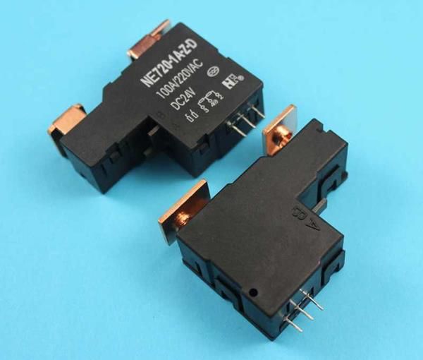

    And then there is our defective hero of the episode. A small relay in a black housing. Mounted on a PCB, this is the module from the car. Pressing the momentary tact switch visible on the right switches on the relay's operating contact, which applies 12V to the module's output. Another press switches it off. I deliberately do not show the whole circuit, how it is controlled etc. as I want to show, on this particular example, the operation, behaviour of the damaged relay itself . The green LED does not have any meaning here, please do not be confused by it :) .
    Close-up of a black relay mounted on a PCB, highlighted by a large red arrow pointing at it.
    We start the test, module driven, multimeter connected at the output, like a receiver. When switched on, full voltage appears, as if everything should be working. Voltage a little below 12V because the whole circuit was powered from just such a voltage.
    UNI-T UT33D+ multimeter display showing a DC voltage of 11.31 V.
    Well, maybe a more expensive multimeter will detect some anomalies? Check out the video to see what it looks like with the Sanwa.
    Everything looks as it should all the time...
    How about an old analogue multimeter?
    None of the instruments showed any abnormalities....
    LED with resistor? In the video below, the green LED on the left connected in series with a resistor, plugged into the output, as a receiver.
    Nothing of the methods so far has caused the relay to fail. And let me remind you that it is faulty! :) .
    And an ordinary 12V low-power bulb?
    A car light bulb and its socket lying on a white background.
    In this case finally something starts to happen, The output voltage drops, it does not reach 12V, the bulb does not light up completely, it dims.
    UNI-T UT33D+ multimeter display showing a reading of 3.95 V DC.
    Only the last test showed the damage. The working contacts of the relay may be responsible for this symptom, which qualifies the relay in its entirety for replacement. This article was intended to show that sometimes just checking with a multimeter or suggesting the LED indication is not always correct. In a case like this, the test must be performed under load. Traditional incandescent lamps with a voltage and wattage adapted to the component under test are ideal for this purpose.Sometimes flickering, dimming, incorrect operation of the receiver can be observed immediately. The use of too high a load can only do harm here; too low a load will not always reveal the fault. Finally, I would like to remind you that we were operating at around 12V here, so you can afford such experiments; if you are checking components at e.g. 230V, do not do such tests for safety reasons!

    This is a somewhat conventional issue. There are 70A relays in cars and they are not called contactors. The circuits in my house switch 100 - amp bistable relays (they are sold as such) such as the one below in the photo only with coils for 12V.
    Two black bistable power relays marked NE2101-A1-5D with copper terminals and pins, lying on a blue background. .
