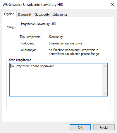

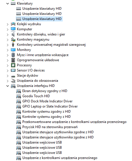

    Acer One 10: Dock Keyboard & Touchpad Issues, BIOS Entry, Win 10, Input & Ribbon Check, Drivers
    In the device manager without changes - I have a hub connected and on it a USB keyboard and mouse from here an additional keyboard and 3xusb
    in the keyboard header I have:
    Acer One 10: Dock Keyboard & Touchpad Issues, BIOS Entry, Win 10, Input & Ribbon Check, Drivers Acer One 10: Dock Keyboard & Touchpad Issues, BIOS Entry, Win 10, Input & Ribbon Check, Drivers
    So as you can see the drivers are available.
