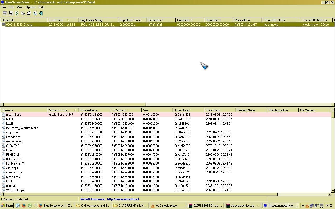

    After booting from sleep, it shows blue screen like below, no symbol on it:
    Win 10 Acer 7741 - Blue Screen after Sleep, Error Code & Decoding Minidump File Needed
    The error code can be read from the minidump file, but something goes wrong. Will someone decode?
    • 020518-8093-01.zip (161 KB) You must be logged in to download this attachment.

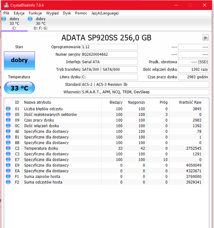

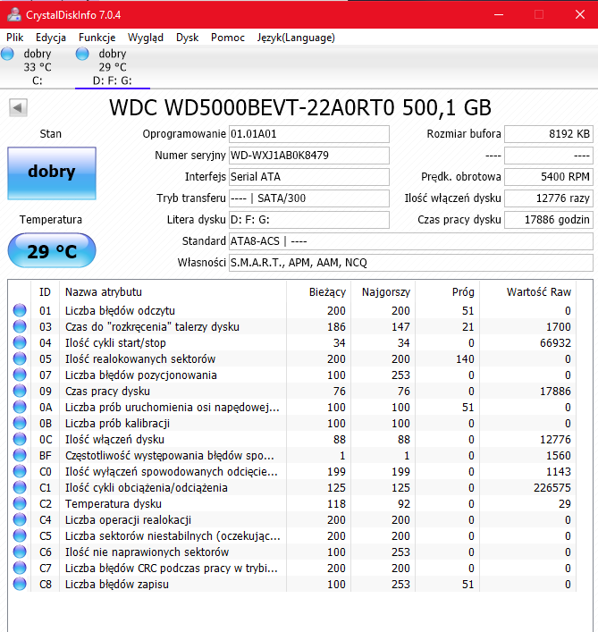

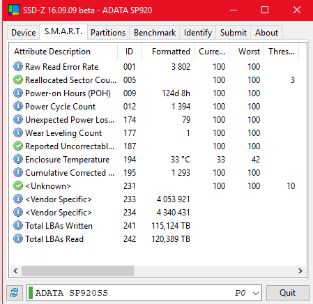

    SMART:
    I updated the bios from 1.18 to 1.26.
    Two memtest runs and zero errors.
    In the event view from the time the minidump file was saved, the following appears:
    "Critical 02/05/2018 11:47:49 Kernel-Power 41 (63)" The description says that "The system was restarted without a clean shutdown first. Possible causes of the error: the system stopped responding or crashed, or unexpected power loss.

    From today after 11:00. Neuter - ntoskrnl. Nothing to say, power failure.
    SMART D: F: G: pass with also from Crystal, and from ADATs from SSD-Z.
