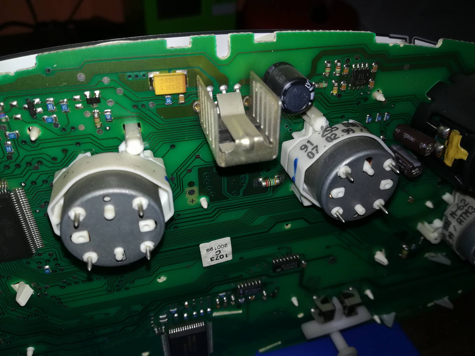

    Hello. I checked the liquid temperature sensor in the Golf IV 1.9 TDI and it turned out that I made a short circuit that went to the meter and thus the fuel and temperature indicator does not work and the indicator light from the coolant level flashes. I changed the gasoline meter and everything works, but unfortunately the immo blocks the start .. is anyone able to say what is damaged in this meter? Alternatively, mark it in the photo and describe how to check it with a meter, if applicable. I would like to replace this damaged part because I can solder and buy the part by product numbers, but at the moment I cannot afford a new meter and immo programming .. I would be really grateful :)
    • Golf IV 1.9 TDI - the fuel gauge does not work, temperature and the indicator li 27947083_1035626633242812_756167433_o.jpg (276 KB) You must be logged in to download this attachment.
    • Golf IV 1.9 TDI - the fuel gauge does not work, temperature and the indicator li 27990727_1035626626576146_61532817_o.jpg (205.7 KB) You must be logged in to download this attachment.

    Hello. Integrated circuits need a stable 5v power supply (most). You could have damaged the stabilizer that powers them - in my eye it is something in the bottom photo with a heat sink, in the middle in the upper part (I'm not sure, because I repaired an older model) It could be, for example, LM 7805. There are electrolytes nearby. Start with verifying this circuit, check the voltage of the chips.

    This is how I heard that the stabilizers fall with such a thing, but I do not know which stabilizer it is ...: / in my opinion, part 1 or 2 was lost. Golf IV 1.9 TDI - the fuel gauge does not work, temperature and the indicator li

    Check part 2- it should be a stabilizer.

    I will buy a new one and solder it :) I will write if it helps :D

    Counter to be replaced. Remove and at the back you have the numbers, look for the numbers on the Allegro so that they match and for the electromechanic to code the immobilizer from the old meter. I mean, when you go to him, you have to go on the old meter, otherwise you will not start the car and then it will connect to the car, download the entire code from the old meter and install a new one, and then re-encode ;) here you have a video of my authorship what happened to me. I made the car at a friend's and only the meter cost me PLN 45 with shipping and after a short time I sold the car for 2,000. because he had other faults and no one could figure out the cause ;) https://www.youtube.com/watch?v=GSBTFiNYZTc

    The sensors are not powered from the meter, so do not write nonsense about the stabilizer in the meter. Have you checked all the fuses for good morning?

    I had everything checked and only after switching the counter, even from a bora or some old seat, the tips worked, but the immo blocked the ignition of the car, so I bought the same and a friend transcoded me ;)

    daro_p wrote:
    You may have damaged the stabilizer
    How? Can you explain it somehow?
    And there the counter, replace the car immediately.
    I know that my colleague polonez15 is kumaty in these matters (I do not remember exactly but I associate some help when I was learning myself), so I will tell my colleague that in VAGs the meter is a "fuse".
    In newer counters (something after 2009) they solved it like this:
    So much better, but according to the manufacturer, the counter must be replaced in such a case, because it is not a "repairable" part.
    For posterity, the author of the topic shorted the common ground (sensor ground) to the power supply, while burning the "fuse". Unfortunately, the fuse is a meter here, so it is not enough to just replace a fuse (5 seconds of work) and you have to solder (20 seconds of work).
    And advice for posterity - to fix something, you must first understand how it works (the case here is about 10 minutes of thinking for someone who does not have much knowledge in the field of electronics).
