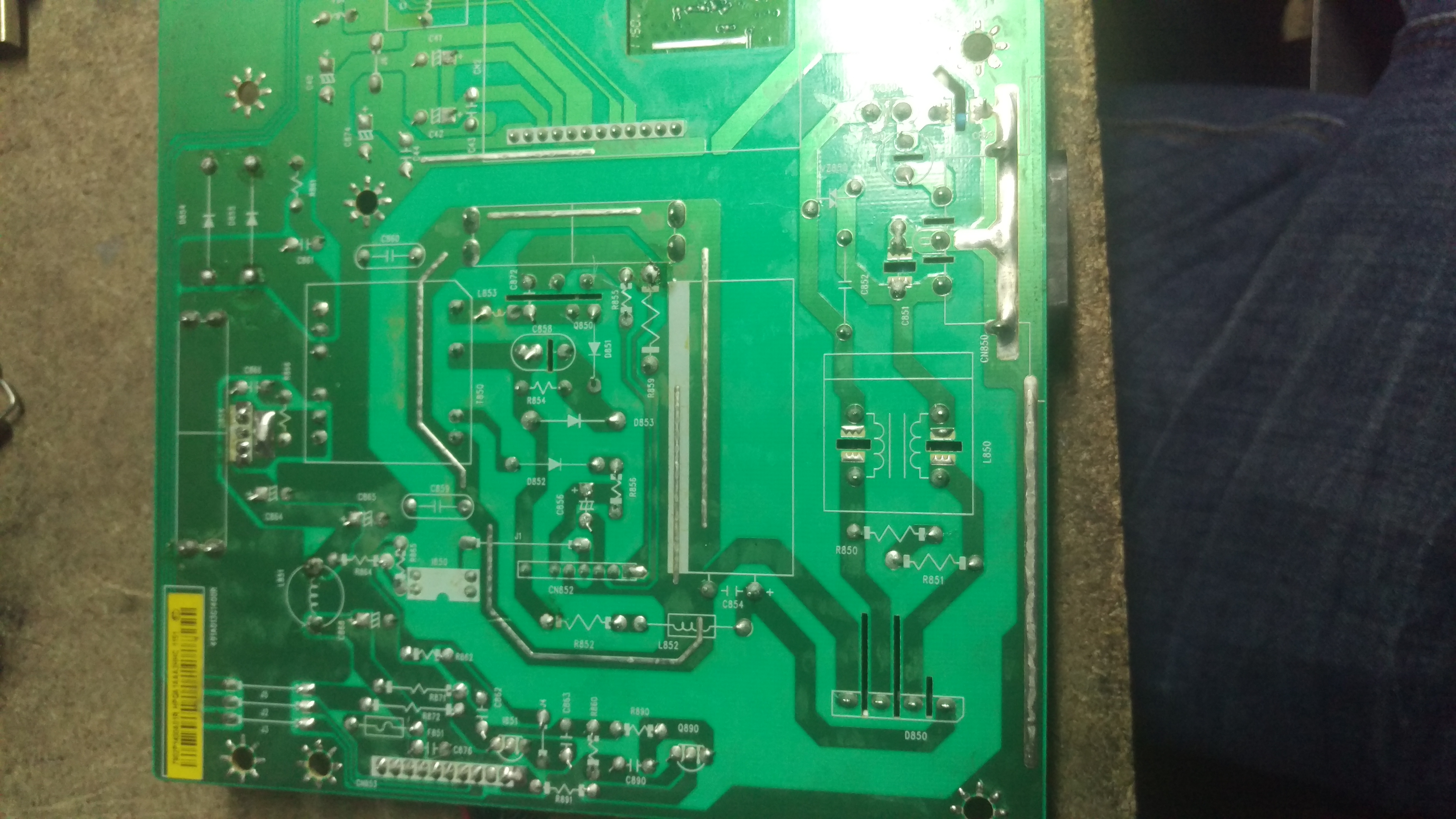

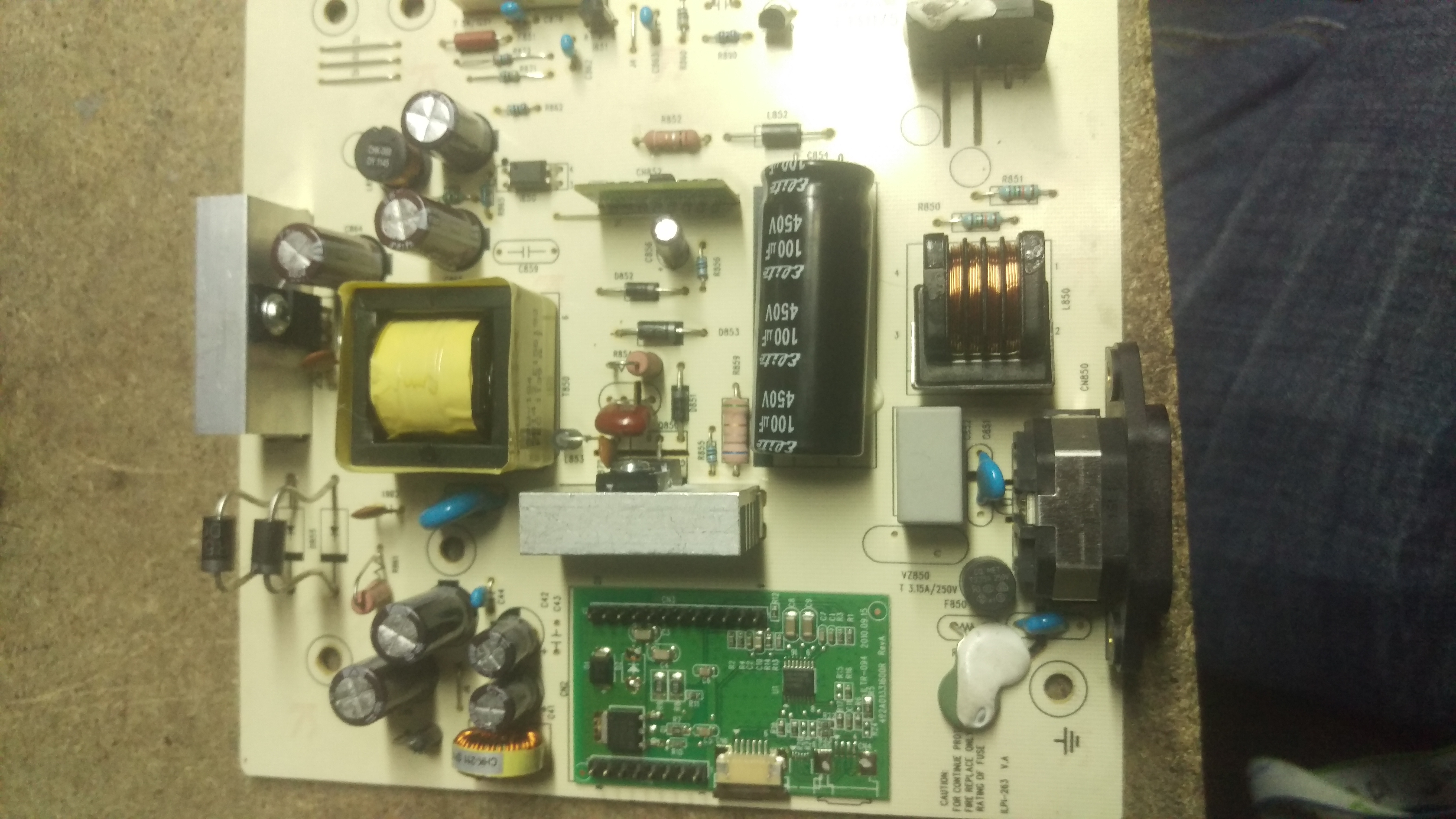

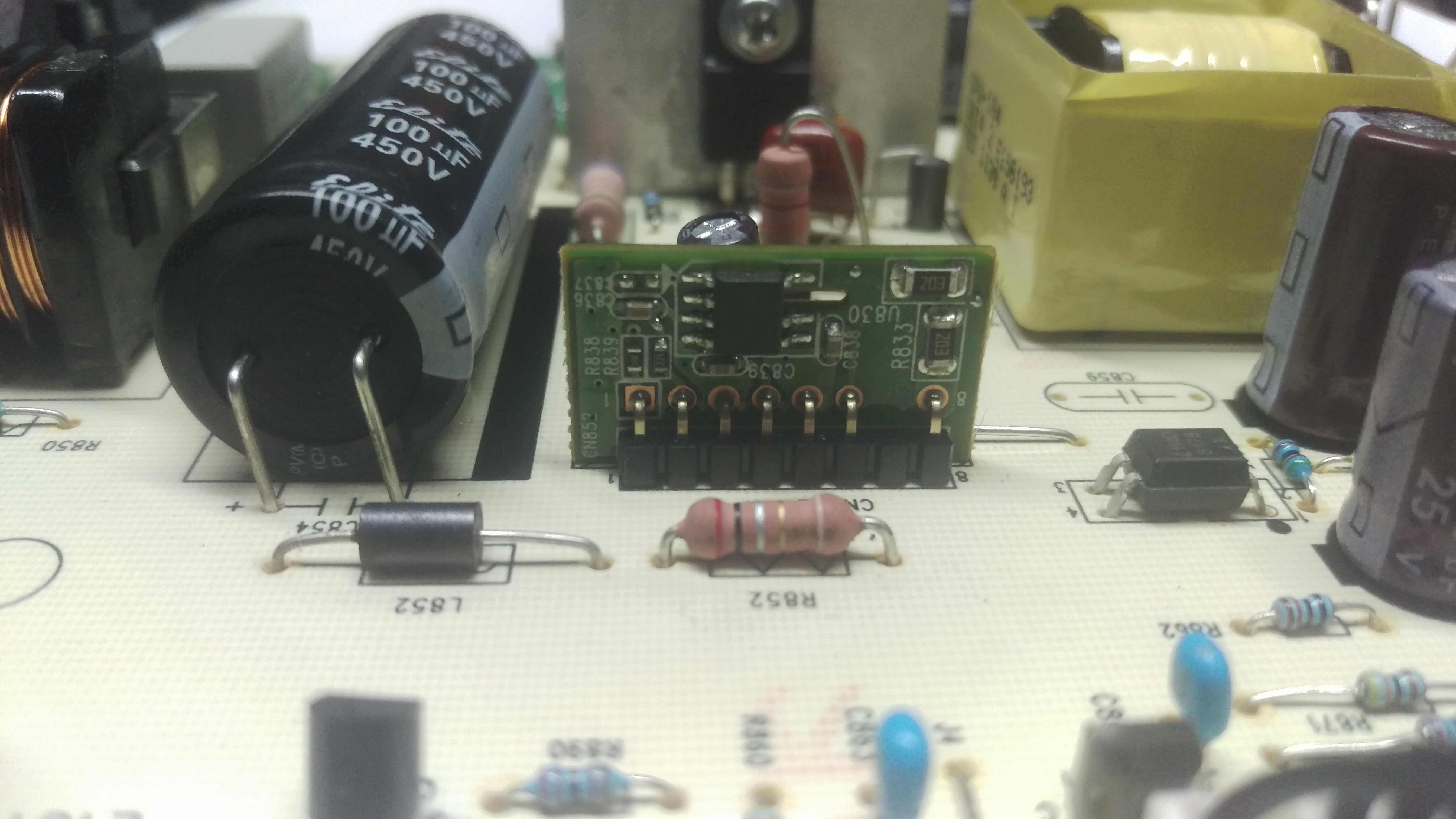

    Hello, I have a monitor as in the title to do that does not turn on.
    After checking, it turned out that one Schottky diode (shorted) with the designation SR520N FIN is damaged and that they were next to each other, I have already replaced both. Maybe someone will tell you where to look further or what measurements I would have to check.
    • HP LA2306X monitor does not turn on, does not respond to power IMAG0882.jpg (3.42 MB) You must be logged in to download this attachment.
    • HP LA2306X monitor does not turn on, does not respond to power IMAG0880.jpg (3.14 MB) You must be logged in to download this attachment.

    MOSFET transistor controlling the converter, working? Control board, checked components?

    In one of the places there was a Schottki diode screwed to the heat sink, no short circuits and the conductivity in one direction is not the other way, so I conclude that it is working, as for the 2764AA mosfet, and I do not know how to check it exactly, between G> D there is no conductivity on the meter and on D (-) S (+), the meter is set to "squeak" 528 ... There are moments that between D / S squeaks like a short circuit. If I am doing something wrong, please be understanding

    OK. There is a diode between D and S. AP2764..pdf (58.49 kB)You must be logged in to download this attachment. Check the optocoupler is it still working?

    One way DS is 528 set to beep.
    The optocoupler is not short-circuited.
    Added after 15 [minutes]:
    After turning on the power, the two LEDs show 2.6 V is it not enough
    in the marked points, if I give to red plus and to 5b or 6 pin minus. The power supply is fluctuating between 0.95 and 1.01V.

    It is operational. Are you looking for further check this module what is a small soldered laminate to the board, is there something damaged there? Have you checked the capacitors?

    Post to me all the photos of this power supply from the elements side and from the print side with good resolution?
    At the marked points, the cable goes to the control board. I do not have a diagram, but in my opinion the voltage is low there and it should be constant and not fluctuate

    There should definitely be at least 5V for the motherboard's power supply.

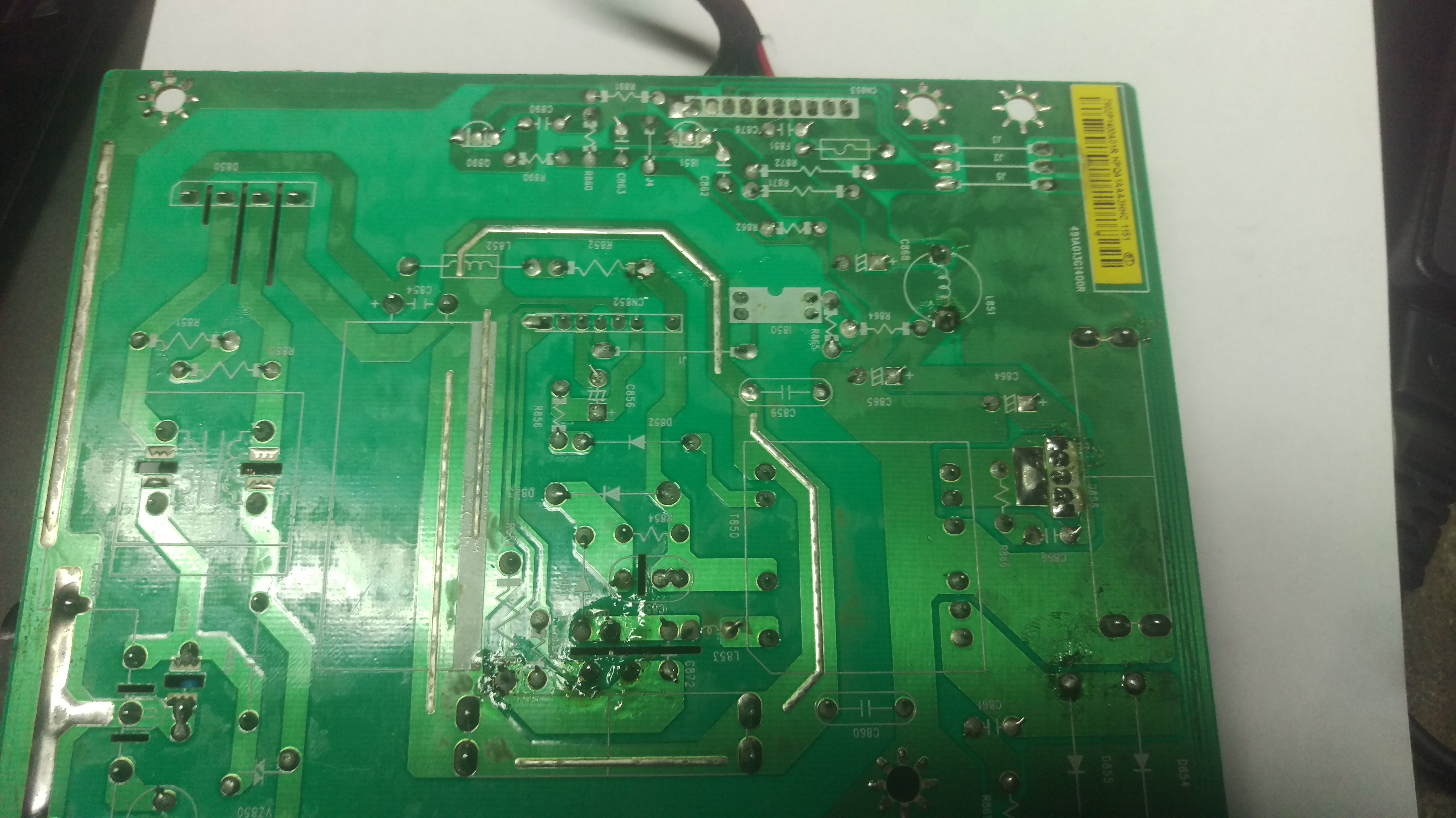

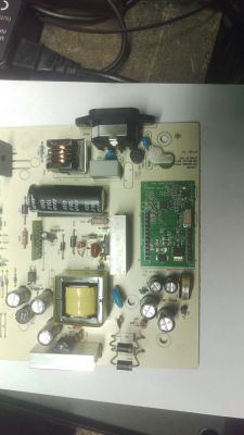

    Please, this is what I managed to do
    HP LA2306X monitor does not turn on, does not respond to power HP LA2306X monitor does not turn on, does not respond to power HP LA2306X monitor does not turn on, does not respond to power HP LA2306X monitor does not turn on, does not respond to power HP LA2306X monitor does not turn on, does not respond to power HP LA2306X monitor does not turn on, does not respond to power HP LA2306X monitor does not turn on, does not respond to power HP LA2306X monitor does not turn on, does not respond to power HP LA2306X monitor does not turn on, does not respond to power HP LA2306X monitor does not turn on, does not respond to power
  • #14 17037265
    Pedros050
    Posts: 17915
    Help: 2471
    Rate: 3927
    Check on this board Q1, D1 U830 what is this inverter driver? There are no cold solders on the connections and the optocoupler is operational? I851 is TL? and there was also a transistor, check it out?

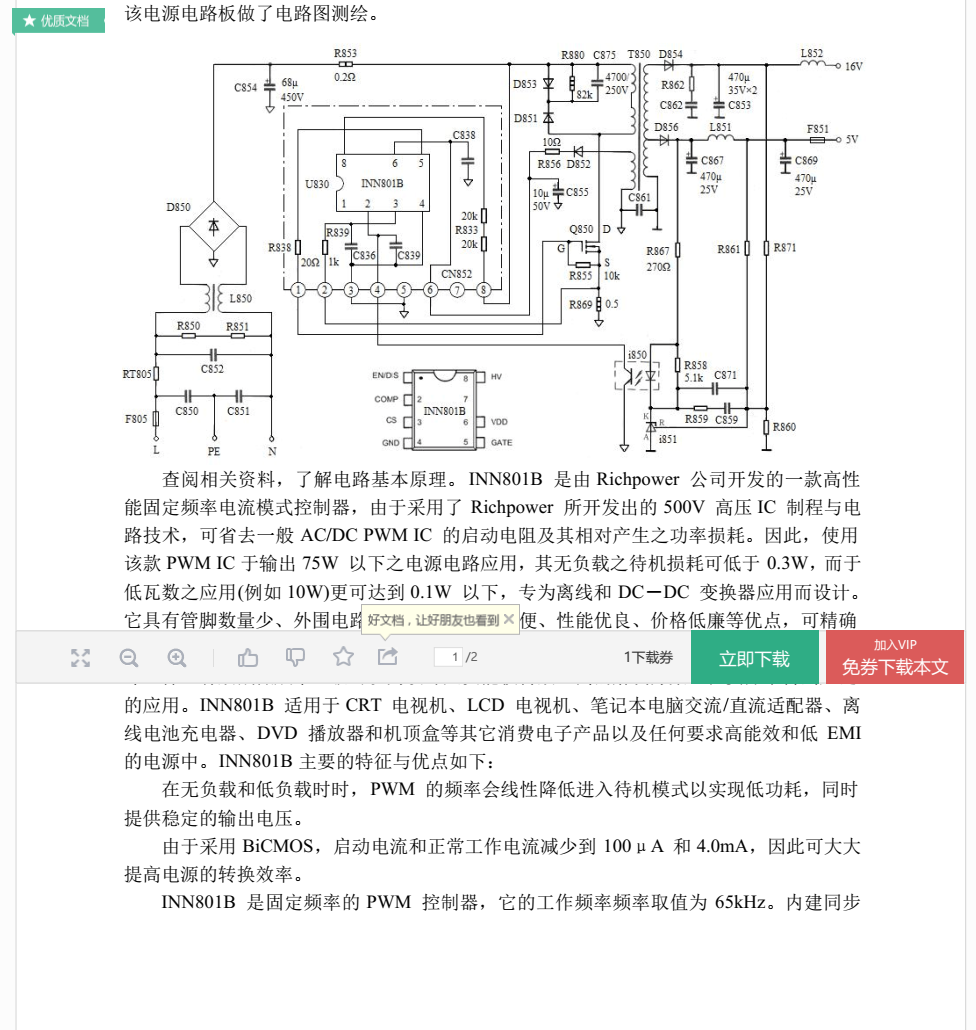

    There you have a LED backlight module on U1 INL859RN (INL859) 16-pin
    - After the pins, it resembles OZ9998B, something was written on the forum (monitors or TV service) Link
    * operating principle OZ 9998LN (QFN24)
    The correct power supply is on the module (pin) with the U830 (INN801B) 8-pin (pin 7 cut), which controls the field on the heat sink.
    It produces + 5V and probably + 15V
    The layout must be drawn on a piece of paper and then see maybe there is an equivalent (analog), e.g. using Link
    There, the power supply from + 300V, after the diodes should go through resistors on the pin, probably (8), ..
    You have opto feedback. and TL431, excl. gives on the pin.FB of the chip
    Replace them (or check them out)

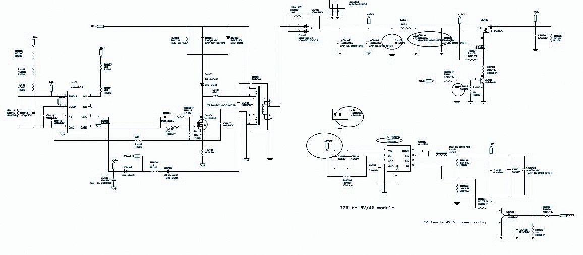

    ps
    In the enclosure there is a hand-drawn diagram inv. under the LED (there may be errors)
    The one in the power supply may be something "ala
    or (from Philips stby system) / sorry, the quality is not as it should be

    Welcome back. The message is that the monitor has been repaired (replacement of the converter, resistor, capacitor and diodes, PLN 88 in total). the repair cost is high, but it may pay off somehow if the monitor lasts another 3500 hours .... hopefully
