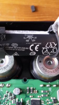

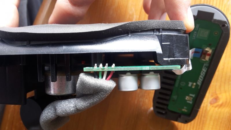

    Hello all. I have a question for you, I have a Bose Soundlink color speaker that does not work, namely. After turning on, detecting the device via Bluetooth and pairing, the speaker does not show any signs of life. I read on the forum bose that when it is unused for a long time, it must be restarted, which I did, unfortunately it did not help at all. Then I undressed this speaker thinking that the battery is for replacement. The battery voltage is 3.7 volts. My question to you is what I can do to help me repair this speaker?

    Hello - please put a photo of this cell (and its parameters) and connect
    to the charger and RECHARGE up to 4.2V

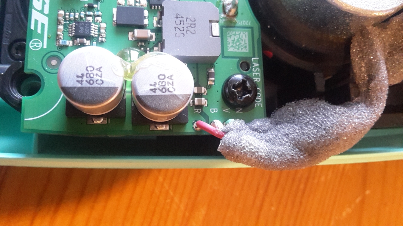

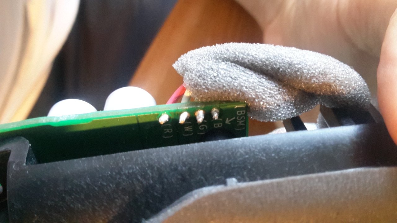

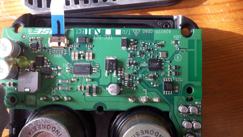

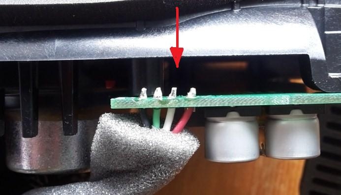

    It is also worth checking if there are sometimes cold solders.

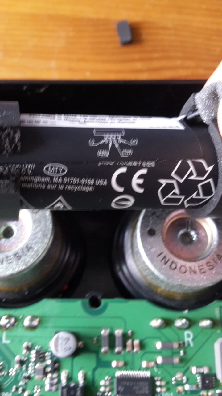

    for charger and RECHARGE up to 4.2V

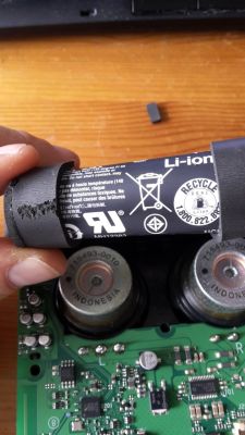

    Thanks very much for the answer to the link I put a photo but parameters read from the snow I can not under the pink there is no info

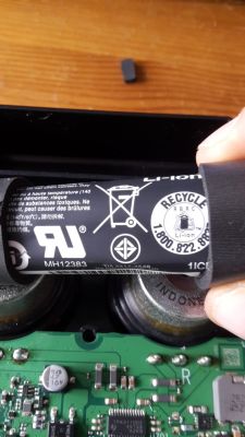

    It is a cell (or battery) Li-ion. Please, post a picture of this fragment
    tiles (from above)

    wojtek 9007 wrote:
    This is a cell (or battery) Li-ion. Please, post a picture of this fragment
    tiles (from above)
    Added after 56 [seconds]:
    BOSE Soundlink Color 2 Speaker Not Working Despite Successful Bluetooth Pairing
    The loudspeaker, after correcting the soldering points and slightly pressing the plate, started. Works :) just what the LEDs have turned off since turning on and switching between bluetooth and aux

    Thanks very much for the answer to the link I put a photo but the parameters read from it I can not do it under pink there is no info
    He is, but he does not want to look more. Even after entering the type of link in Google, we receive information.
