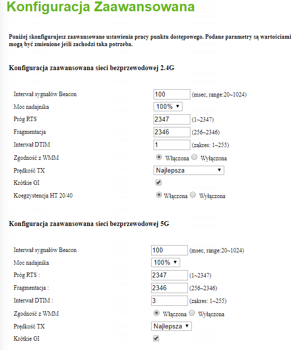

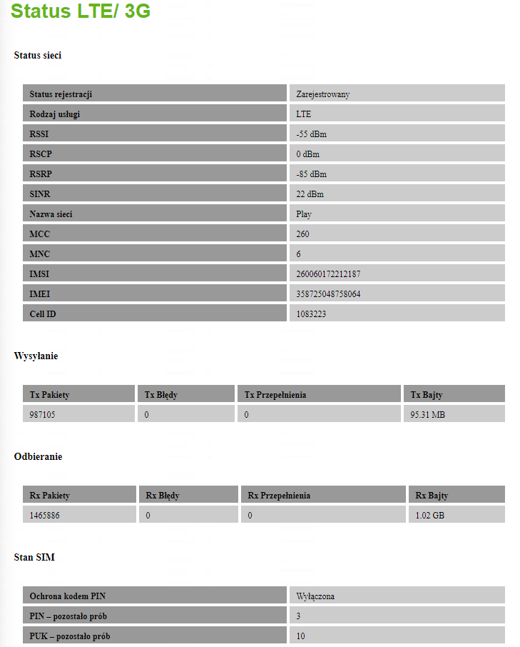

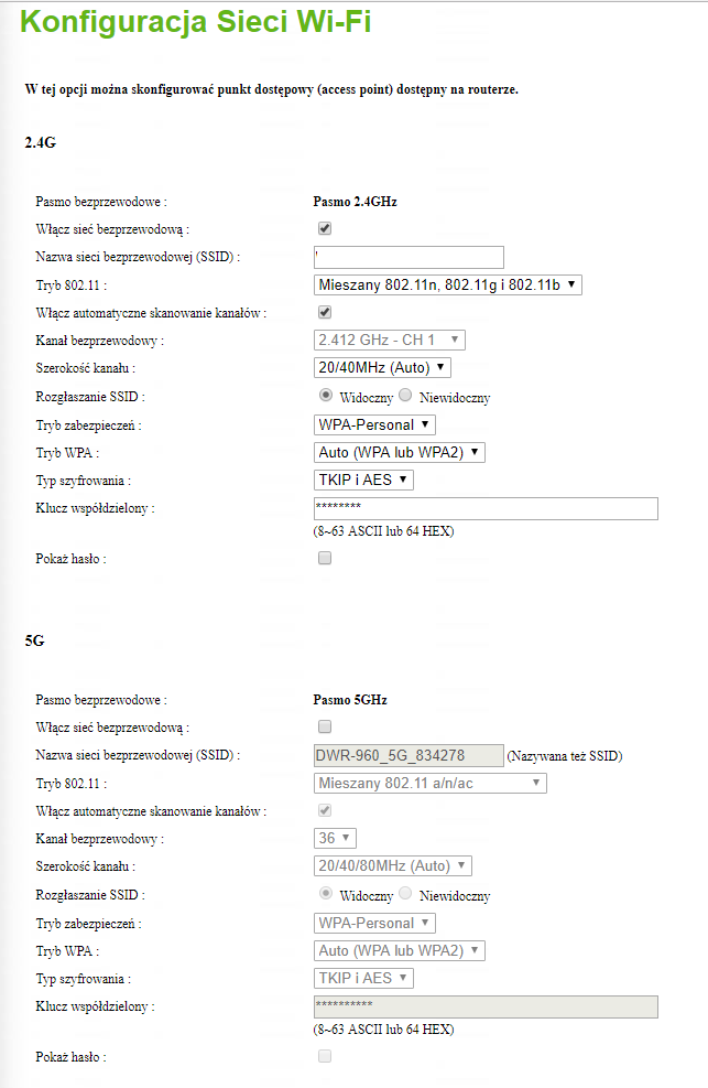

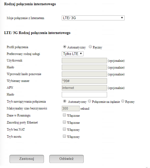

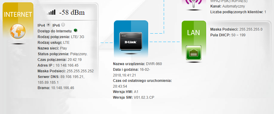

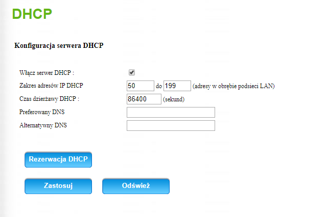

    Witajcie
    Problem jest tego typu iż rozłącza się co jakiś czas router z internetem LTE.
    Porównując do b315 b593-s22 to ten ssie strasznie. Rozłącza, skaczące pingi są, niestabilne połączenie z nim. Sprawdzałem za pomocą dwóch kart wifi i na każdej jest to samo ...
    Oczywiście jest najnowszy soft. Ten router tak samo stoi jak tamte i taki jest awaryjny ...

    Dziękuje za zainteresowanie się tematem
    No właśnie też mnie dziwią DNS goglowe
    MultiWAN wyłączony
    Załączam konfigurację

    it looks like a bad router setup ...
    You did "reset" the device to the factory settings and reconfigure it - it would be appropriate to set everything "manually", i.e. as few automatic settings as possible, especially those responsible for 3G / LTE and WIFI connection ("LTE / 3G type of internet connection" -> connection profile manual , I do not know the menu of this router but the point is to connect to a specific BTS on a specific frequency; Wifi -> uncheck "Automatic channel scan" and set the channel manually = GUIDE ; in the DHCP tab fill in the fields "Preferred ..." and "Alternative DNS" with addresses that are now downloaded automatically, ie: 89.108.202.21 and 185.89.185.1 and Apply changes)
    Do you have the device from new or did you buy a used one? Google's DNS as "hostaddress" could appear in the device's NAT settings as a result of incorrect port configuration under e.g. PS4 -> see HERE .
    Search all options in the device responsible for Routing -> Port Forwarding, DMZ, uPnP, or static address or port forwarding for any entry in which the address: 8.8.8.8 occurs, as this may be the problem.
    Something is wrong with the setting of individual ports because:
    ... httpd: Create httpd thread fail! Retry. ...
    indicates that the internal server (Apatch) supporting the device's WebGUI has problems with getting to the port: 80 responsible for html communication.
    I would also not rule out errors in the manufacturer's software ... it breaks your connection after the command:
