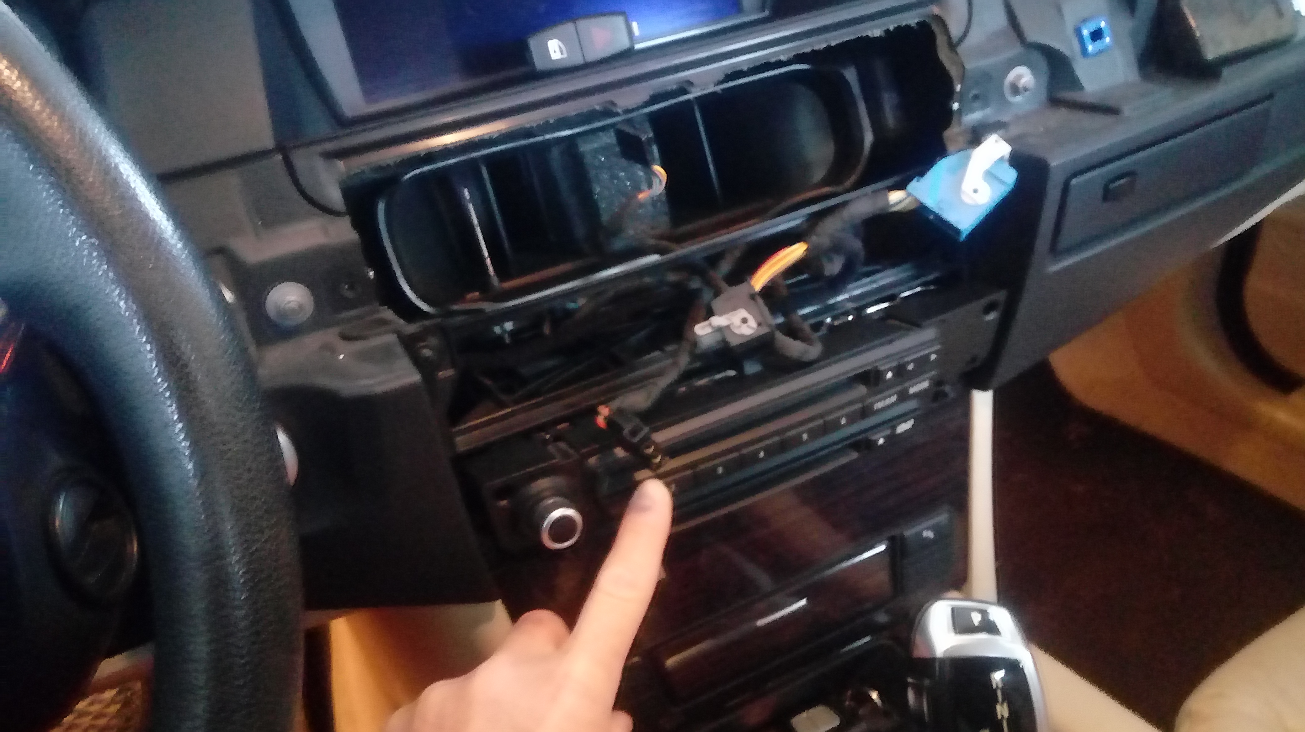

    When inserting the radio he touched the power cable of the panel from the switches above, ie air conditioning, etc. The entire panel without any functions dark. and winter is. I checked the fuses in the glove compartment and the trunk, I took it out and put it out. They are ok, there must be others, maybe those in the pit near the driver or maybe a relay, but where to look for it, I checked the current to the plug on the left, there is nothing on the way, it does not connect, but where will you help ??? best regards
    • Bmw e60 530d - Hello everyone, I put the radio on and made a small short circuit 20180215_131142.jpg (2.41 MB) You must be logged in to download this attachment.

    And you don't have fuses in your trunk yet?

    Woziowsky
    Posts: 16
    Start checking the fuses properly, find a Description, find the one responsible for the interior and replace it, sometimes if you look at it badly, you can't see it's blown

    Alonzobmw
    I did it and it is ok burned in the trunk, best regards
  • #6 17048307
    Alonzobmw
    Added after 3 [minutes]:
    I checked the fuses again, I don't know how, but I missed one in the trunk, although I checked five times thanks to everyone.
