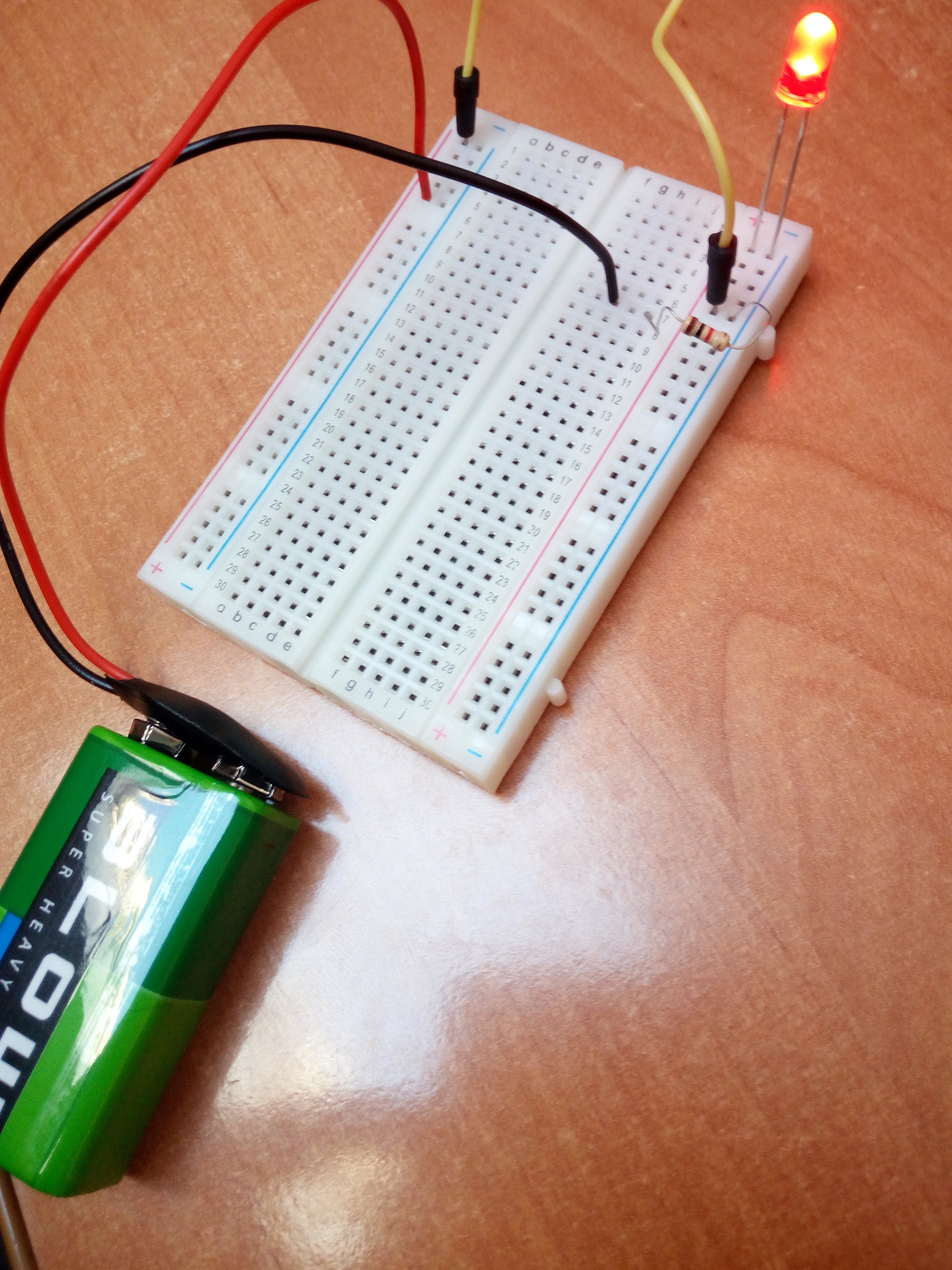

    I asked for a resistor, not a photo of the package ... if someone put 100 ohm resistors in the package by chance, then what?
    By the way, show us how you assembled this circuit. Maybe you made a diode short?

    All in all, right, here is the photo, although on the Internet I found the specifications of this diode and write there Working parameters:
    Current If: 20mA
    Voltage Vf: 2.0 - 2.3 V

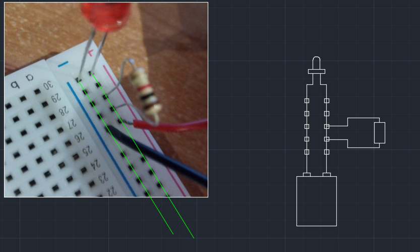

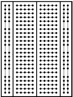

    The barcode resistor is 1kom +/- 10% (measure this with a meter).
    So now show us how you connected it:
    You made a diode short.
    These lines along are one common wire.
    The contact plate looks like this (the longitudinal lines are galvanically connected to each other):

    I do not understand why there was a short circuit, the current flowed through the entire resistor and flowed from the diode from the ground?

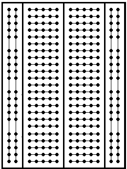

    It is easier to explain:
    The resistor is short-circuited in these inputs, and the diode short-circuits + and - from the battery.

    Skip the PCB first and connect these elements without the PCB. Then take the meter and check in what combinations on the board you have a short circuit and try to understand it according to my post # 33.

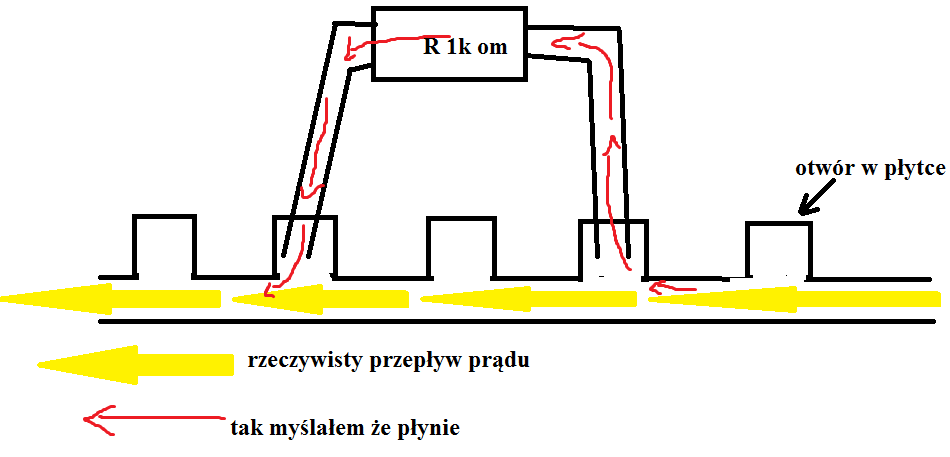

    Okay, sat down a bit today and figured it out. So in my connection (because the current always flows with the smallest resistance line), the current flowed from the positive to the diode, neglecting the resistor (the current flowed after the galvanic connection in the board, instead of the resistor). So it turns out that I tatted the diode with horrendously high intensity. Here is a "diagram" of how the current actually flowed and a picture of the correct connection.
    Calculating Apparent, Reactive, and Active Power for Receiver with I=5A, Pn=1000W, Un=230V Calculating Apparent, Reactive, and Active Power for Receiver with I=5A, Pn=1000W, Un=230V

    Hold_on1 wrote:
    line of resistance
    The line of least resistance.
    Hold_on1 wrote:
    the current flowed through the galvanic connection in the board, instead of the resistor
    You start to use pretty vocabulary, but a galvanic connection is nothing more than a metallic connection. I guess you still don't know why.
    And it is not entirely true that the current flows only along one path, because the current is appropriately divided into individual sections.
    It flows as you thought, but in this case it is in the branch with a resistor ("red") that flows VERY, very, very small current, incomparably smaller to the branch, let's call it "yellow".
    All of you have already written it and know it, diagrams are unnecessary for us :) .
