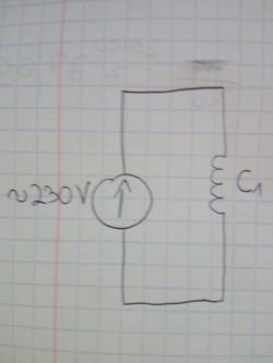

    Under the term "substitute diagram" is an ordinary drawing? Is it something like that?

    Not really. You have a contradiction in the descriptions of the source. On
    resistance gives off only active power, so .... where is the calculated reactive ???
  • #19 17052592
    Hold_on1
    Posts: 152
    Rate: 20
    So I understand that the calculations are good and the diagram is wrong.
    What contradiction do you mean?
    "Only active power is emitted on the resistance, so ... where is the calculated reactive power ???" - how to draw this reactive power, I don't understand anything, someone will explain to me?
    Yes. You have drawn a DC voltage source (battery symbol) with +, - and next to it you have written:
    ~ 230, suggesting an alternating voltage. One contradicts the other.
    Hold_on1 wrote:
    how to draw these reactive power, I don't understand anything, someone will explain to me?
    The power cannot be drawn on the schematic diagram! Items are placed on it. who can "give" or "take" this power. An ideal resistor, as it is in the diagram, "takes" active power, that is, the product of the effective values of current and voltage, when their waveforms are in phase!
    Read what causes reactive power and what elements "generate" it.

    jack63 wrote:
    Perfect resistor, and this is the diagram,
    I see an indefinite element in the diagram. It may well be Z (impedance).
    The author made the mistake of drawing a source of direct voltage, not alternating voltage. Hence the interpretation that it is resistance.

    Thanks for the answer, now is a good drawing?

    jack63
    Posts: 11792
    Help: 851
    Rate: 2822
    Unfortunately not. First of all, we mark the inductance, that is the coil around the world with the letter "L", and the capacitor "C".
    Secondly, an ideal inductive element only consumes reactive power, i.e. it basically shifts the current relative to the voltage in phase by a quarter of a period.
    There must be two basic elements connected to the voltage source.
  • #25 17053712
    kozi966
    Posts: 6922
    Help: 599
    Rate: 1288
    Better, but it's not C1 a L1.
    For this you need to know data such as the frequency of the supply voltage expressed in hertz, the inductance of the element expressed in henry and possibly the resistance of the element (if it is not ideal) to calculate the impedance and then the powers.
