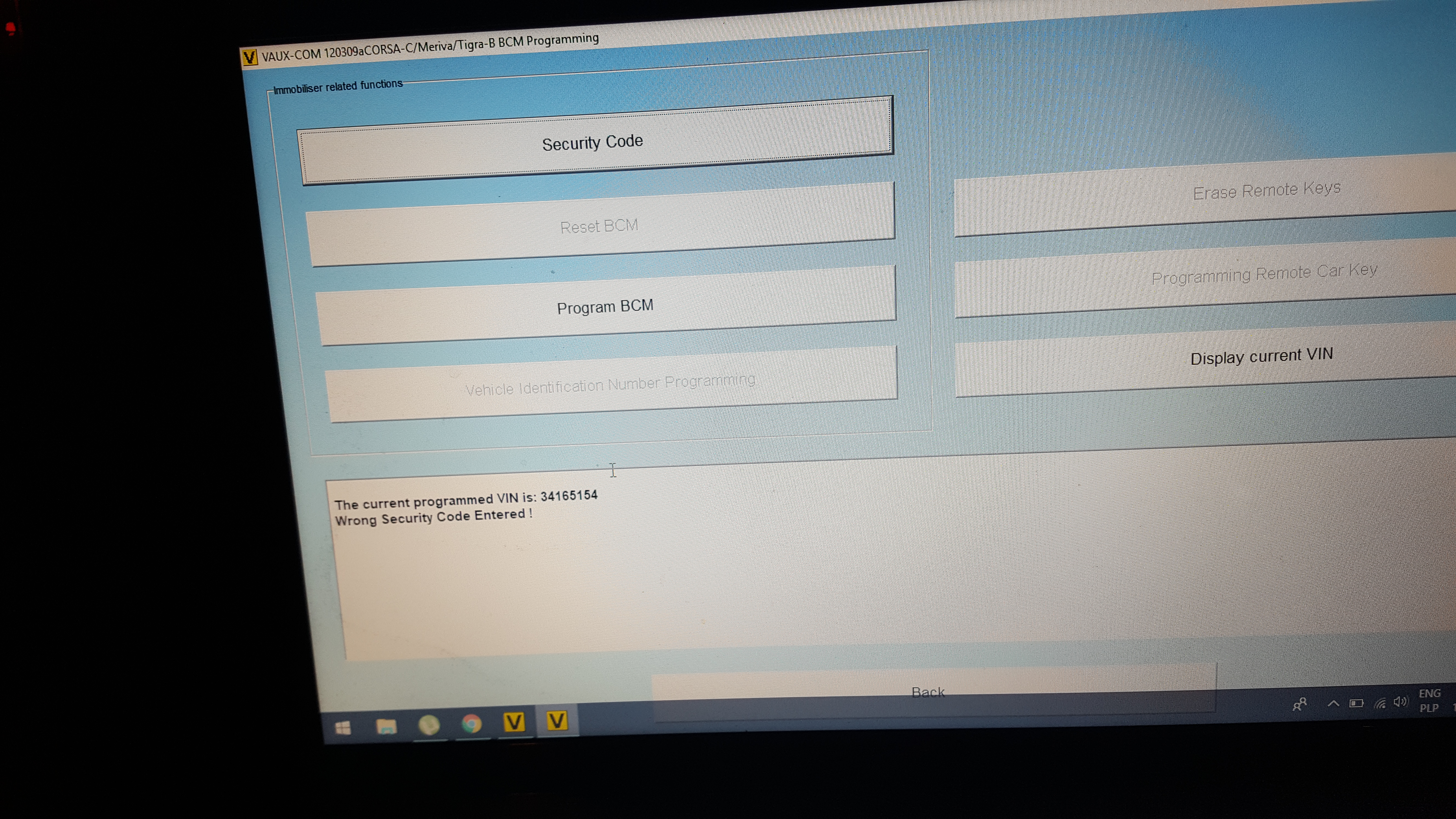

    I have a problem with programming the key. I need a four-digit Security Code, and I don't really know each one of them. I will be grateful for any help.
    • Obtaining Four-Digit Security Code for Key Programming: Opel Corsa C 2003 Model 20180217_183710.jpg (7.68 MB) You must be logged in to download this attachment.

    Counter, ECU, BCM.
    Possibly carpass.

    Drive to the "main dealer" with some proof that you are the owner and you will receive a code (for a fee).

    A colleague above wrote to you where you can read the pin, but you need tools for that. It won't be cheaper for sure.

    When you buy a car in a showroom, you get a CAR PASS (a cardboard box the size of a credit card) and there is this code printed on it ... so look in the papers / ask the owner.

    Thanks for the info. As for the papers, there is no chance. The seventh owner and just stood with him. No papers and it's good that at least the keys are there :) I will focus on the first hint and look for information on this topic and try to do it. I thought that with this software opcom I would be able to do it. Thank you for your help.
    You can do it.

    I think I figured it out. I will connect the computer in the afternoon and check it.
