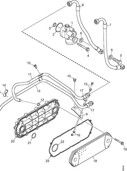

  • #3 17046246
    HADŻI
    Posts: 366
    Help: 87
    Rate: 441
    Check the oil in the gearbox. Maybe the box oil cooler has come off. It is on the right side of the engine under a cover behind the air compressor.
    Added after 9 [minutes]:
    Here's a drawing.
    • Scania R440 XPI E5: Creamy Slime in Expansion Tank, Corroded Pipe & Retarder Issues _ps_185461.jpg (47.35 KB) You must be logged in to download this attachment.

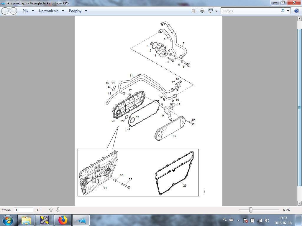

    Which year of production is it?
    To be precise, the gearbox oil cooler looks like this:
    • Scania R440 XPI E5: Creamy Slime in Expansion Tank, Corroded Pipe & Retarder Issues chlodnica oleju skrzynia.png (188.51 KB) You must be logged in to download this attachment.

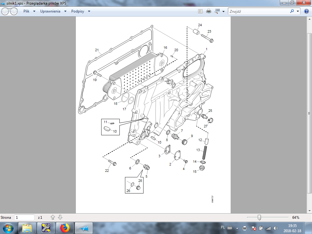

    Give me my chassis number.
    And here is the engine:
    • Scania R440 XPI E5: Creamy Slime in Expansion Tank, Corroded Pipe & Retarder Issues chlodnica oleju silnik.png (200.69 KB) You must be logged in to download this attachment.

    szaman108
    Posts: 1090
    Help: 199
    Rate: 905
    I corrected the photos, they are selected according to the vin number. They differ in a few elements, small but always different. For that you needed just the vin number.

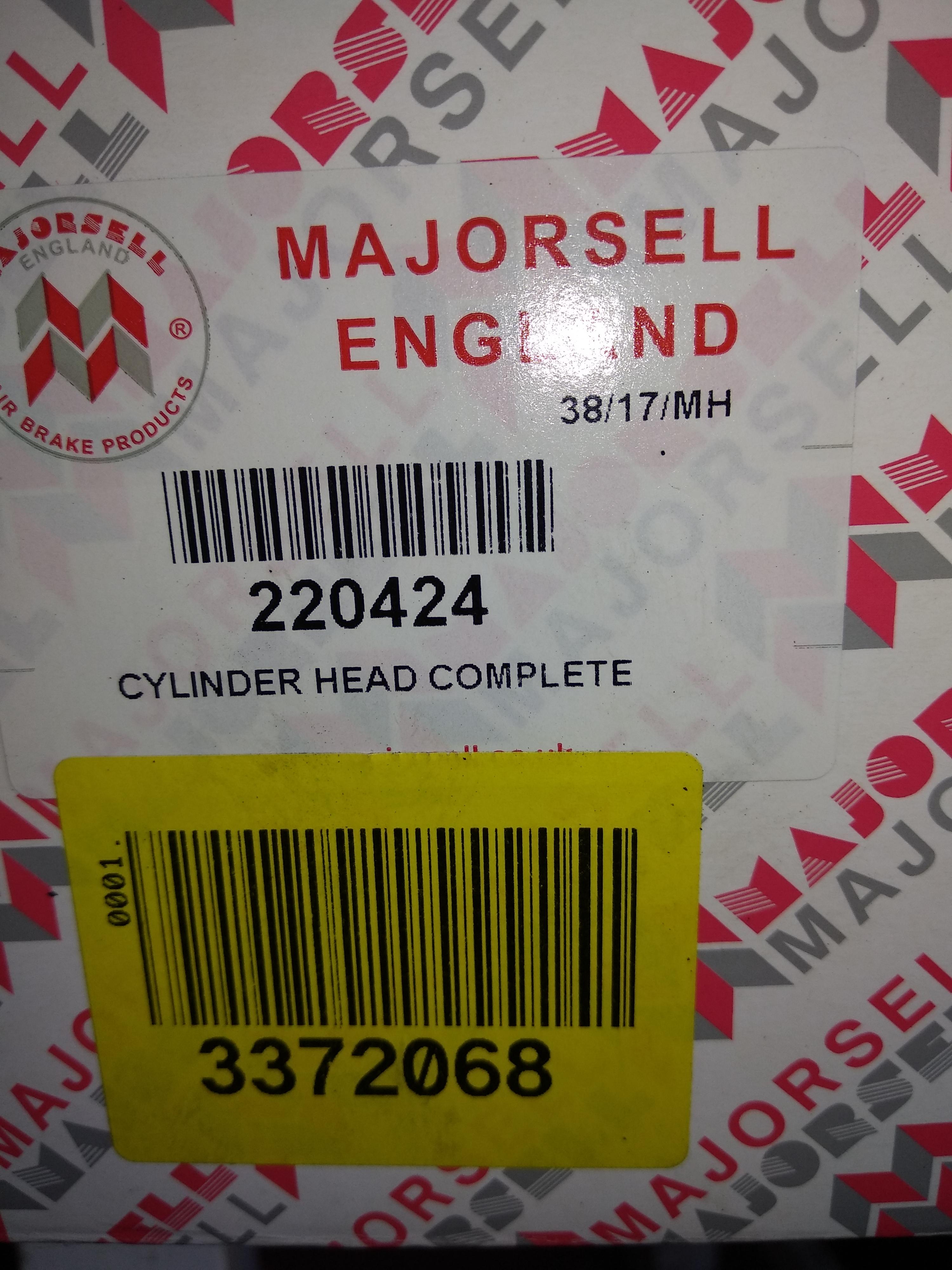

  • #15 17234296
    Edek Edek
    Posts: 8
    Hello. The problem is solved, I close the topic. It turned out that the compressor head was damaged, released oil into the cooling system, the next symptoms were too high pressure in the cooling system and fluid ejection after unscrewing the expansion tank cap, you could observe small bubbles on the running engine. To be sure that it was a compressor, I closed the coolant circuit bypassing the compressor, started the car, and stuffed foam from splashing soapy water into the hoses coming from the compressor head. Bubbles from both hoses confirmed its leakage. I bought a new head from Majorsell Skuba for PLN 950 net. After the exchange, it is fine. I regret a bit that I drank and did not buy a whole new compressor from this company for PLN 2600 net. I checked the retarder earlier for tightness and it came out ok. I'll throw some photos and videos, maybe they will be useful to someone. The head had a lot of pits and replacing the seals themselves did not help, planning it or new one could only fix the problem.
    Thank you for your interest and best regards.
