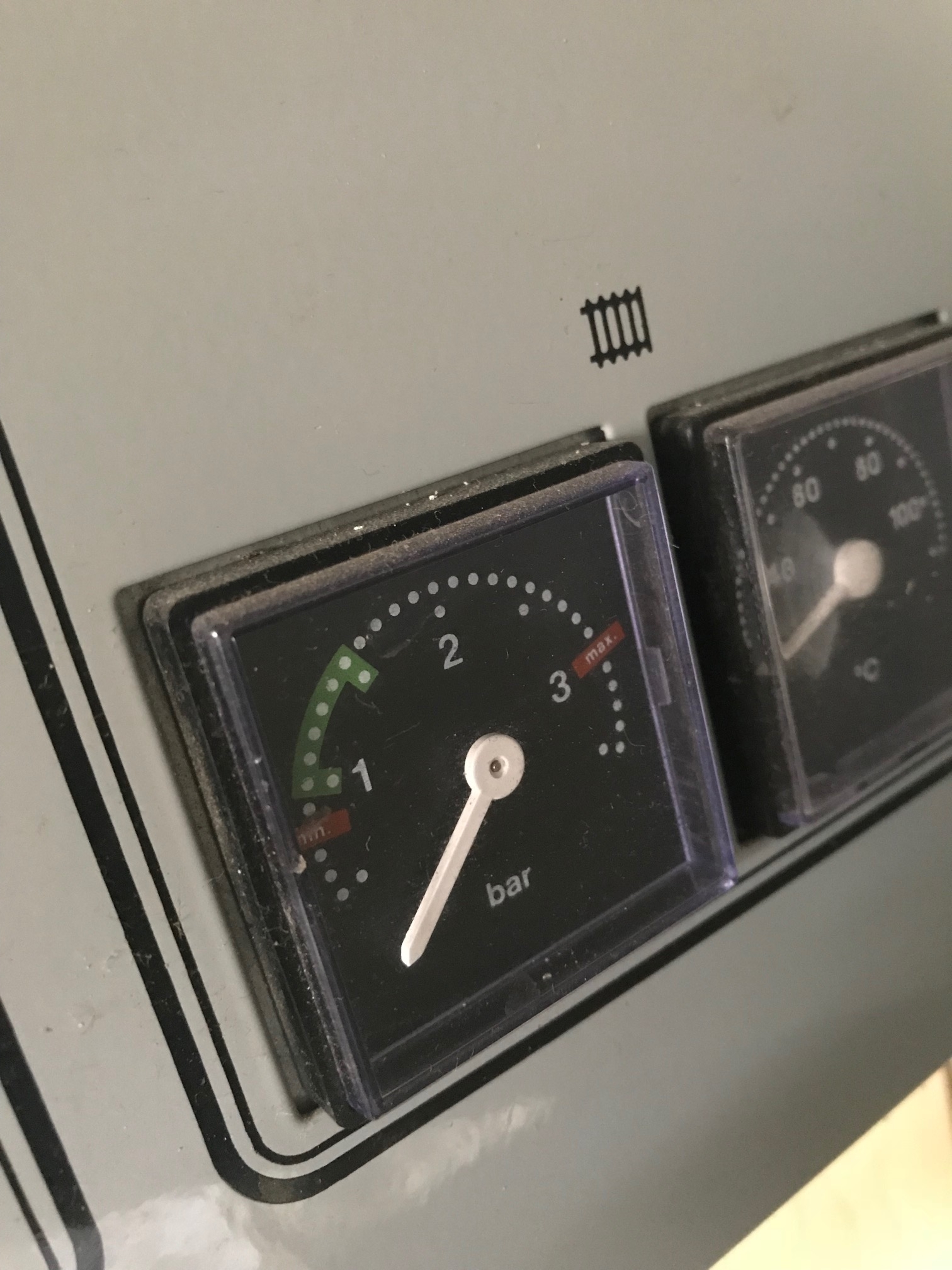

    will someone give me how to top up water to the Vaillant VC / VCW 789/0 gas oven? I see the red knob, but do not you need to unscrew a valve?

    What for? After all, gas furnaces do not have a water tank (they heat through). You can refill the water in the heating system by unscrewing the valve that is usually not on the stove.

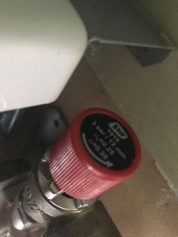

    And why is it a red knob for bars and a pressure gauge on the stove?

    This red is a safety valve. Check this white knob that looks like a used bottle cap.
    For what you wrote and not to top up the water in the oven, because as I wrote the furnaces which do not have a water tank, hence there is no such thing as water replenishment in the heating furnace

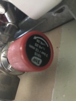

    This white knob is impossible to move, at least I did not manage.
    And if the counters indicate 0, does it mean something is happening? To call a professional or something I can try myself?
    This sentence formulates that you tried to spin the red knob but it did not work, so you are wondering what else to turn.
    This red knob is called a safety valve that opens automatically if the system pressure exceeds 2.5-3.0 bar and then the system water flows out into the drain to reduce pressure.
    If you tried to turn this knob, you just dropped the water from the circuit and the pressure on the boiler dropped to zero.
    In such a case, one should turn the knob further in accordance with the arrow, until the characteristic shot, then the valve closes, so you have to stop spinning quickly, because turning it opens the valve and you can turn only one way.
    It is worth to unscrew the hose from this valve and make sure that there is no water leakage from this valve.
    Zero bar on the pressure gauge means that there is no water in the system and there is no pressure required.
    The reason for this may be, for example, a water leak from the circuit that is not visible, and even a sudden air leakage from the membrane vessel, which is usually on the back of the boiler and the air filling valve is at the top near the exhaust pipe.
    You can try to check the air pressure in the vessel yourself, fill the water in the circuit and see if the pressure will be kept at the minimum level during the boiler operation, but you must have some pale idea of what you are doing.
    I do not know how to top up water in your boiler, since, as you say, the potential white knob does not stir, and there is no other filling valve.
    In this case, it can be difficult without a specialist, because you will damage something more quickly than you can fix.

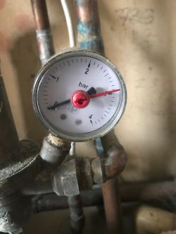

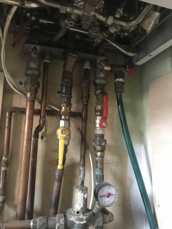

    In the boiler, there is a valve that allows water - as a colleague earlier described such a used white cap as from a bottle. Actually, it can be baked and you can not move it, you will sooner be able to break something.
    On your last photo you can see a pressure gauge and before it a strange bubble, or a pressure reducer connected to a copper pipe on the return of CO to the boiler. This is a water intake to the central. Somewhere before should be a regular valve that is probably closed. Try to find and open it. If not, take more photos of this installation or call a professional.

    The problem is already solved, thank you all for the answers. The main valve was located on the bottom of the bottom tube and it was only necessary to unscrew and top up the water. For the future, I am posting a picture with a marked valve, maybe someone will need it. Greetings.

    I have only one comment. The valve that you unscrewed is the cold water that is heated by the so-called boiler. CWU, but also lets water through the reducer into the CO system. This is called constant pressure regulating the constant pressure in CO. The problem may be when the safety valve (the one with the red cap) passes through the green hose, probably directly to the sewer. Then again the system is supplied with fresh water and again dropping etc. This can lead to the replacement of the boiler - its main exchanger. Check whether the safety valve does not leak water - from a green hose. It is best to take this hose to the bottle and then you can see if there are leaks from CO or not.
    The hose has a nut, so it will be easier to unscrew it, then we will have a direct view of the valve itself, which makes it easier to see even a dripping drop from the valve.
