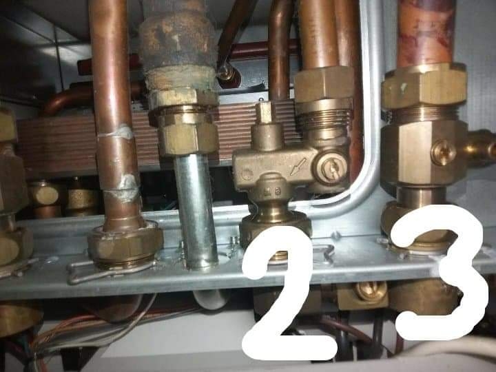

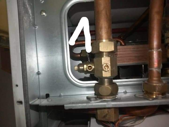

    Hello, I have a stove like in the picture of the Vaillant brand in a rented apartment - I do not know the model (maybe someone will recognize it), hence my question which of the valves (1, 2 or 3?) Can be used to top up water in the heating circuit? Can it be done when the stove is on or do you have to put it off?
    Regards and thank you for the answers.
    Tomek

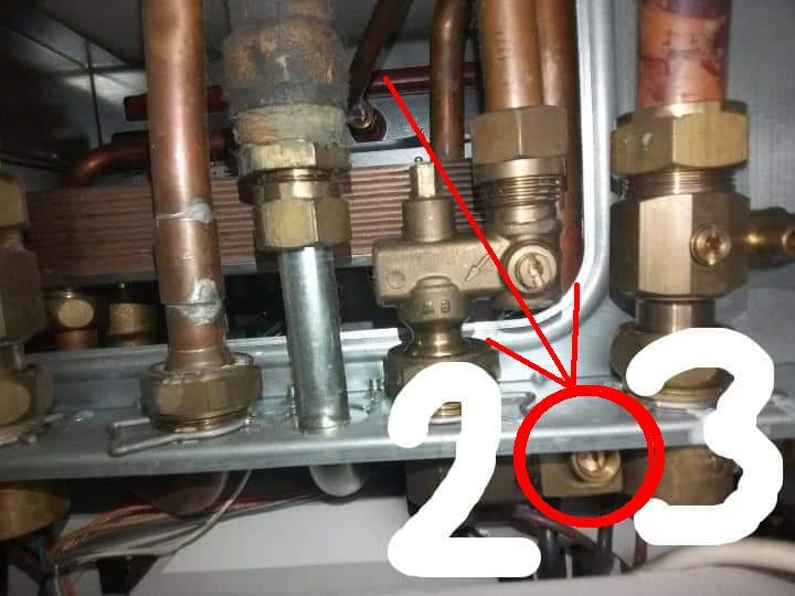

    None of these.
    Here you have a release valve in the red circle - a flat screwdriver.

    Is_78 thanks for the response, and maybe you know if I have to turn off the stove to add water? best regards
    #4 17565569
    ls_77
    Posts: 2441
    Help: 500
    Rate: 947
    It depends...
    But it's better to turn off and then refill.
