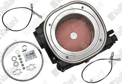

    I did not manage to say that it is a condensing boiler with a built-in tank - the so-called refrigerator - a combination of a hanging condensing boiler with a HUW tank loaded in layers by a plate heat exchanger.
    The reason for the F.75 error is most often calcification of the primary exchanger or, less frequently, an error of the pressure sensor, sometimes a seized pump, sometimes silting of the boiler. F.75 says that the boiler electronics did not read the pressure jump after starting the pump.
    Like most Vaillant condensing boilers, it has a primary heat exchanger (flue gas-water) made of stainless steel. Such a "flattened tube" wound in the form of a drum, where the flowing water flows up and down - like on a roller coaster. This is what he looks like:
    Title: Vaillant VP5 Stove Error F75 - Pressure Sensor Compatibility & DIY Descaling Guide Needed
    Alone at home, there may be a problem with descaling this exchanger. It is not very possible to flood it with some descaler, leave it and rinse it. There are too many nooks and crannies. A rinsing pump is useful, which constantly flushes out the sips that remain in the pump tank.
    You can always replace the exchanger itself instead of the entire boiler - product code 0020135129 according to the catalog - at our cost ~ PLN 2,100.
    You can also start with the pressure sensor itself - because the cheapest - product code 0020059717 according to the catalog - at our cost ~ PLN 90.
    Look for the boiler rating plate - a sticker with the serial number.
  • #12 17888690
    marekkamcia
    Posts: 11
    And what does this exchanger look like? Can you send me a photo of it? And can it be descaled, for example, with vinegar and without this pump?

  • #13 17888774
    ls_77
    Posts: 2441
    Help: 500
    Rate: 947
    I already posted a photo of the exchanger itself:
    This is the "black drum with stainless steel inside".
    Here are sample photos: link
    This vinegar (or any other descaler) cannot be descaled by yourself.
    You can add a cleaning fluid to the central heating system - pour it through a radiator - start central heating according to the liquid's instructions, wait the appropriate number of days, drain the water from the central heating system and the boiler, rinse thoroughly, sometimes a neutralizer or inhibitor should be added. That's the only way you can do it yourself.
    From fluids you have:
    FERNOX
    SENTINEL
    FERDOM
