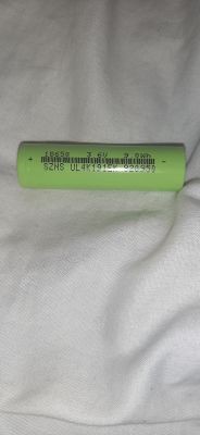

  • #12 19036404
    Lebdzio
    Hello, regarding the topic, I have the same problem, we have used up e-cigarette batteries on the Internet, I found that some of the powerbanks are suitable for me, such as in the picture, tell me if I can use them safely? Eleaf IStick Pico E-Cig: Safety of Using 2200mAh Power Bank 18650 Batteries & Charging Methods
  • LGABHG21865 cells recommended for 35 W load
    #13 19036432
    zjo
    Level 28  
    Posts: 1179
    Help: 144
    Rate: 276
    Hello. I have a double-heater tank, power supply max 80W, set 35, resistance of the heaters around 0.3 ohms, unfortunately batteries from damaged laptop cells cannot cope. I buy with stock, LGABHG21865 cells, a continuous discharge current, if I remember correctly over 20A, they calmly envelop ... The main question is what current the heater requires. Cells should have some reserve of current efficiency for safety, exploitation at the border or crossing it may be dangerous.
