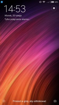

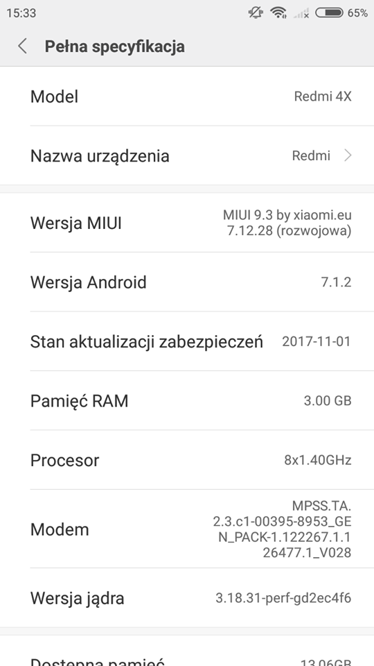

    Hello, I have a problem with coverage, I can not call anyone or anyone to me. I have already removed the SIM card, reset the phone and continue to do the same. Network - Orange

    I checked the card with another phone and it also does not work, additionally I took a different card and put it into the current phone - everything works beautifully, the range and the network immediately found

    Ask for a replacement card in the Orange salon. If you have the option, check it on another Orange card.

    I just checked another Orange card and the phone immediately detected the network and everything flickered.

    So go to the salon and ask for a replacement card or buy a new one.
