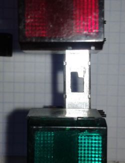

    For a specific example, I am posting a photo of isostat type switches with two dependent units and two buttons.
    What is it and how does isostat work?
    Looking at the picture, first there are two buttons (with visible stops), then two switches dependent on each other and then four switches dependent on each other. As you can see in the picture, the latter are even more spaced. In addition to what is also visible, isostats have different lengths but it is always a multiple of three pins.
    Springy plates in the right places.
    Ps. The round holes, which can be seen in the mounting rail of the individual switches, are used to mount the previously mentioned plates with rods to create independent switches. Of course, the middle elements are of a slightly different construction.

    Sorry that I am so inquisitive but explain to me how this strip with a particular switch works, or how it happens that if I press one it will pop out the other? This is a general question and does not refer to the photo you posted
    #10 17055157
    zybex
    Helpful for users
    Posts: 15920
    Help: 2094
    Rate: 2940
    There is a strip with holes inside, through which individual isostats pass. Each isostat of this type has oblique notches on the side. As soon as such isostat is pressed, the aforementioned slat (rail) is pushed to the side, which always returns to its place, thanks to this elastic plate on the side. It's a kind of latch.

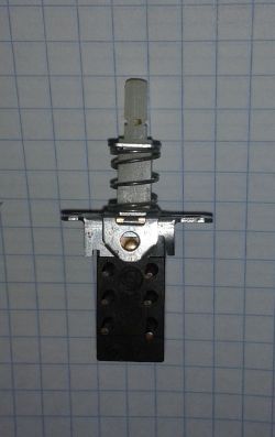

    The pawl, i.e. this inner rail, has a "tooth" which retracts when any isostat in the dependent unit is pressed.
    By the way, I found a single independent isostat here.
    Have more like this dependent Izostat.

    The difference between the independent and dependent slider is this.
    And a photo on which you can see the aforementioned rail for dependent isostats (left side at the top) and below, among others said rods (pins) and elastic plates for dependent isostats. Photo found on the net.
