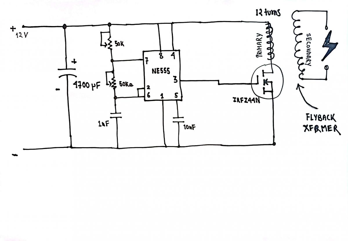

    How to modify this circuit in order to increase output voltage and increase reliability. Is it possible to connect an AUX cable input into the Control voltage (pin 5) of the 555 timer in order to create musical arcs, if so how to isolate and protect the music player.
    Circuit diagram with NE555 timer, IRFZ44N transistor, and flyback transformer.
    AI: Could you provide a schematic or detailed description of your current circuit setup with the 555 timer?
    The flyback transformer is from an old CRT TV, the primary winding on the ferrite core is of 12 turns
    AI: What is the desired output voltage level you are aiming to achieve with this modification?
    50KV or higher

    ujjwaldahal123456789 wrote:
    How to modify this circuit to increase the output voltage and increase reliability.
    These are generally conflicting requirements - don't count on reliability if you try to get 50kV. The transformer is generally tailored to the conditions of the TV it comes from.
