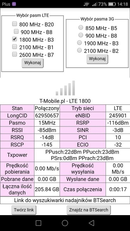

    I recently bought unlimited internet in T-Mobile with Huawei B525s router, but the signal is quite weak. I established that the router connects to the BTS 2 km away (Świdnik, Lubelskie ul. Piasecka 22). In auto mode (the router aggregates 800 + 1800) parameters not the best [align = center: df9acb3e5a] Choosing LTE Antenna for T-Mobile Unlimited Internet: Huawei B525s Router, 800+1800MHz Bands
    and the speed it achieves is DL: 15-18, UP: 5-7. Forcing only 800MHz band parameters unchanged [align = center: df9acb3e5a] Choosing LTE Antenna for T-Mobile Unlimited Internet: Huawei B525s Router, 800+1800MHz Bands
    however, speeds much worse DL: 10Mbps UP: 7Mbps. On the 1800MHz band the parameters are much worse [align = center: df9acb3e5a] Choosing LTE Antenna for T-Mobile Unlimited Internet: Huawei B525s Router, 800+1800MHz Bands
    and DL speeds: 18Mbps UP: 0.7Mbps. At first I thought to buy 2xATK-10 but on the 800MHz band terribly low speeds. Hence my question whether it is better to buy an antenna up to 1800MHz and use only this band or choose an antenna for aggregation 800 + 1800MHz to fully use the guaranteed 60Mbps. If the aggregation antenna, which one?

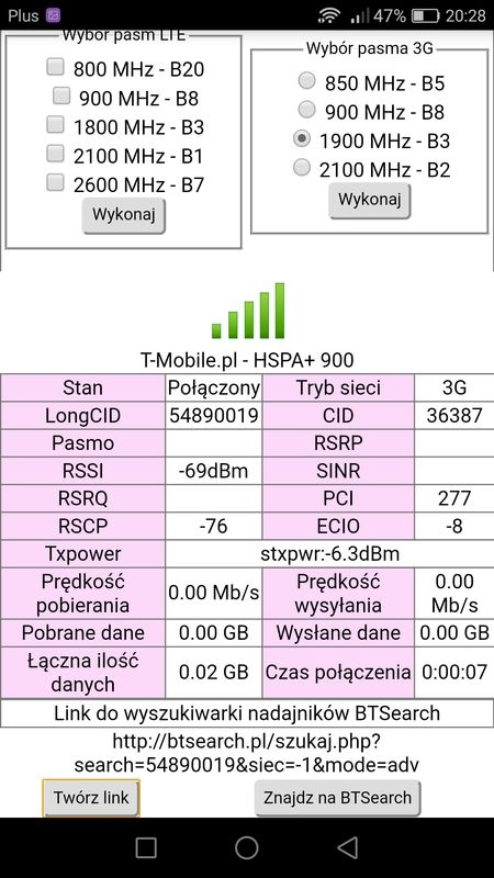

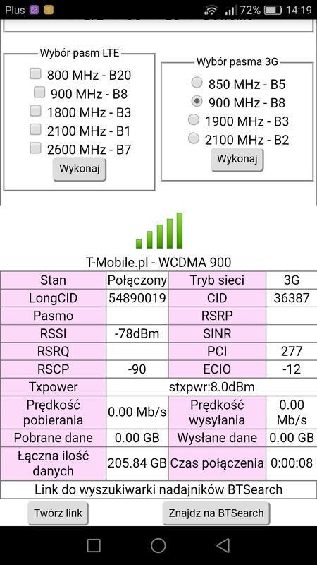

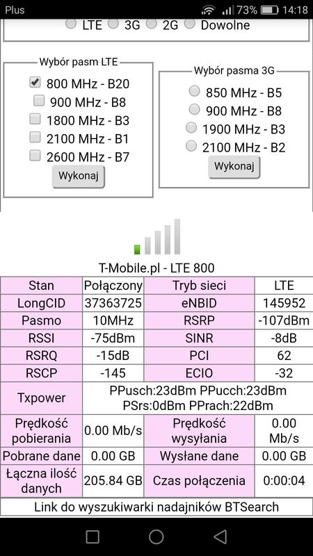

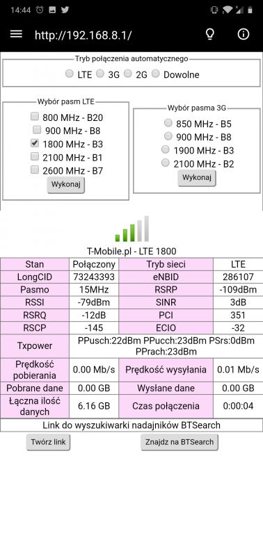

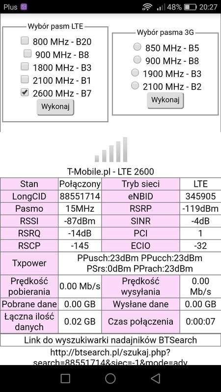

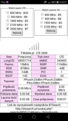

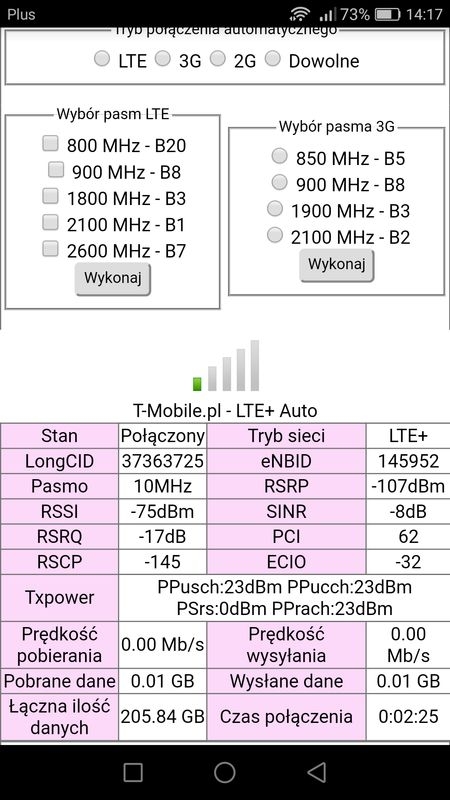

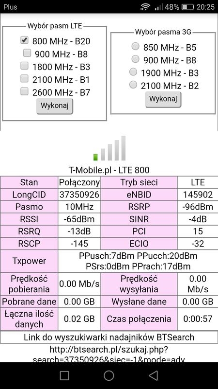

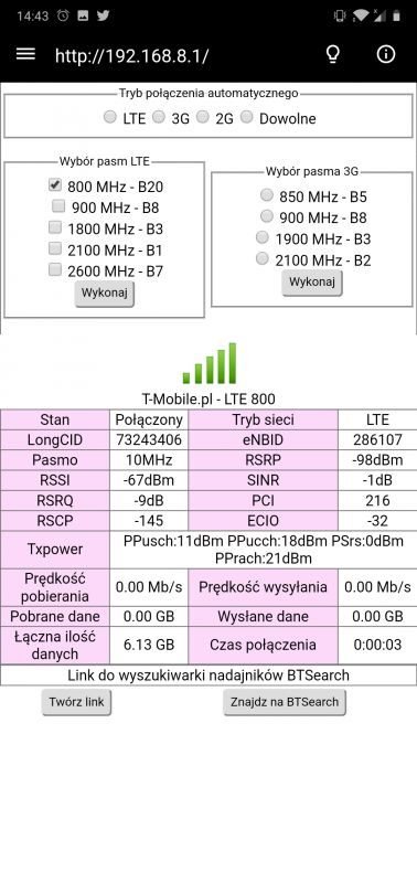

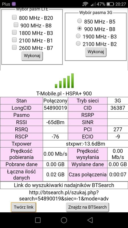

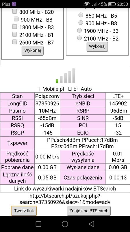

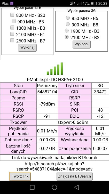

    Hello, let me join the topic. I am the owner of the Huawei B528s router with internet from T-mobile, unfortunately in my town is very poor coverage I was thinking about buying an antenna to improve LTE. Below I attach screenshots from Hmanager. I wonder why after the change from LTE to 3G the range increases and the internet speed increases (speed test changes from download speed 3.6 to 7.8). Please help me to choose the right antenna and to direct it to the appropriate BTS. My place of residence is Balczewo in Kuj-Pom.
    Choosing LTE Antenna for T-Mobile Unlimited Internet: Huawei B525s Router, 800+1800MHz Bands Choosing LTE Antenna for T-Mobile Unlimited Internet: Huawei B525s Router, 800+1800MHz Bands Choosing LTE Antenna for T-Mobile Unlimited Internet: Huawei B525s Router, 800+1800MHz Bands Choosing LTE Antenna for T-Mobile Unlimited Internet: Huawei B525s Router, 800+1800MHz Bands Choosing LTE Antenna for T-Mobile Unlimited Internet: Huawei B525s Router, 800+1800MHz Bands

    LTE800 from BTS-a Networks Modliborzyce, very weak signal, low SINR and speed. Put it out the window and show how the signal parameters on the LTE800 look, and DL / UL on the speed test, it may be overloaded. LTE1800 and UMTS2100HSPA + DC on 3G from BTS at Laubitz 19 in Inowrocław. Residual signal on LTE1800, not bad on UMTS2100. In addition, it works on DC, i.e. DL up to 43.2Mbps and is faster than on LTE. Finally 3G on free UMTS900HSPA + with BTS-a Błonie 6. In general, do the LTE1800 and LTE2600 test with B528 outside the window. LTE2600, LTE800 T-mobile and LTE1800NW operate on BTS Błonie 6 and Jagielońska 22 and aggregation of these LTE bands. BTSs with LTE800 alone such as Modliborzyce are usually overloaded. Better chances for better speeds from those in Inowrocław, both on LTE and 3G with UMTS2100.

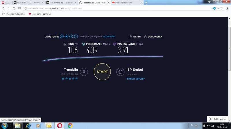

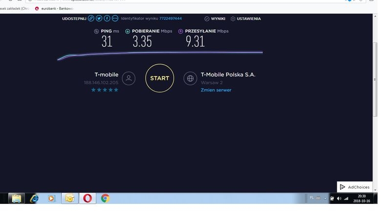

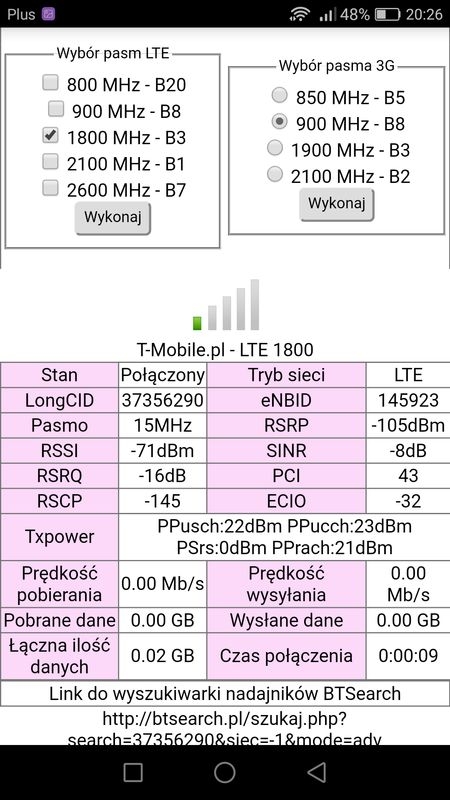

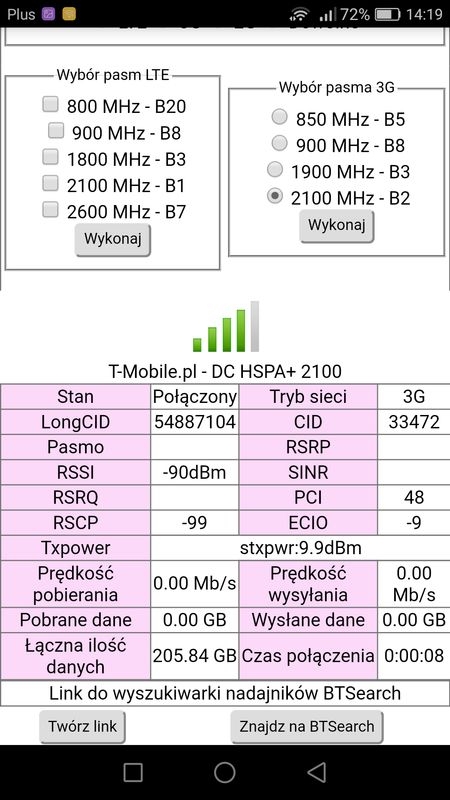

    Tests carried out with the router outside the window. First LTE 800 + speed test. Others also, in addition, speed tests on the Auto setting are the latter (st) and on G3 -2100 are the latter (st). Does the antenna help at all.
    Choosing LTE Antenna for T-Mobile Unlimited Internet: Huawei B525s Router, 800+1800MHz Bands Choosing LTE Antenna for T-Mobile Unlimited Internet: Huawei B525s Router, 800+1800MHz Bands Choosing LTE Antenna for T-Mobile Unlimited Internet: Huawei B525s Router, 800+1800MHz Bands Choosing LTE Antenna for T-Mobile Unlimited Internet: Huawei B525s Router, 800+1800MHz Bands Choosing LTE Antenna for T-Mobile Unlimited Internet: Huawei B525s Router, 800+1800MHz Bands Choosing LTE Antenna for T-Mobile Unlimited Internet: Huawei B525s Router, 800+1800MHz Bands Choosing LTE Antenna for T-Mobile Unlimited Internet: Huawei B525s Router, 800+1800MHz Bands Choosing LTE Antenna for T-Mobile Unlimited Internet: Huawei B525s Router, 800+1800MHz Bands Choosing LTE Antenna for T-Mobile Unlimited Internet: Huawei B525s Router, 800+1800MHz Bands Choosing LTE Antenna for T-Mobile Unlimited Internet: Huawei B525s Router, 800+1800MHz Bands

    LTE800 is already mentioned Modliborzyce, as expected, despite the improvement of the signal clogged band, not worth attention. LTE1800 this time a weak signal from LTE1800NW in Wybranów. On LTE2600 is T-mobile from Pl. Klasztornego 2. The aggregation with BTS at Błonie 6 as the basic LTE1800 band and LTE2600 or LTE800 from it joined. Weak signal, adequate speeds. In the home T-Mobile, such BTS jumps are the norm. In such a situation, it is necessary to purchase an external broadband antenna operating in the 800-2600MHz band, e.g. 2xATK-504 from TELKOB. You'll set up Inowrocław and on it further tests of bandwidth and aggregation and setting it to a specific BTS. As it will be difficult to predict. Speeds depend on many factors, it will definitely improve and stabilize the signal on all LTE bands, you will use it in case of 3G on UMTS2100HSPA + DC.
