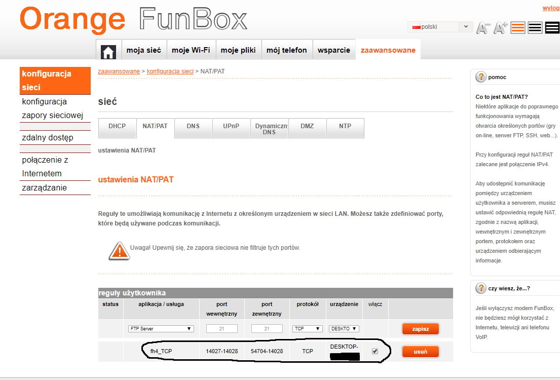

    As in the topic, I can not remove or disable this rule. I wanted to redirect these ports:
    TCP: 80,443,14000,14008,14020,14022,14027-14028,14043
    UDP: 3074
    for For Honor on PC.
    But I can't do that because this rule blocks adding one of the ports.

    How can you not?
    First turn off then delete.
    Ev. first turn off and on the router.

    The point is, I can't either disable or delete it. I restarted the router, still nothing.
    I wish I could remove this without resetting the router.

    Have you tried on different browsers?
  • #5 17062479
    ZielonyNowicjusz
    Yes, I tried on Microsoft Edge, IE, Chrome
    Unfortunately, to no avail.
  • #6 17062482
    jimasek
    Posts: 35287
    Help: 3783
    Rate: 2681
    Probably some error in the router configuration. All that remains is a factory reset and reconfiguration.

    For the future.
    Set the barrier to low in FB.
    Computer on static IP.
    Do not add ports in ranges just one at a time.

    This rule is in error. The starting port is greater than the ending port (54704-14028). Maybe it needs to be corrected but can only be removed.

    Thanks to everyone for your help. Resetting the router fixed the problem.
