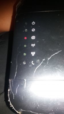

    Hello, this morning, as always, the computer was turned on and everything was working, but at some point the red diode started to flash on the router @ so, as usual, I waited a moment (usually it helped) after disconnecting and connecting to the power supply it still did not work. It was like that for 2 hours until I decided to restore the factory settings to configure, I entered 192 168 1 1 in google chrome, but only a screen with a funbox and the inscription no connection popped up. Now @ diode is flashing red all the time help I tried everything!

    upload a photo of LEDs,
    do you have sync Is the DSL or bird "v" lit continuously? Does he wink.
  • #3 17452979
    sakunasi
    Orange FunBox: Internet Issues, Red Diode Flashing - Troubleshooting, Factory Reset & 192.168.1.1
    From the top:
    Green constant
    Green flashes
    Red is flashing
    Green constant
    Green flashes
    Grey
  • #4 17453010
    LucekB
    Posts: 995
    Help: 143
    Rate: 137
    i.e. the second flash? then you do not have synchronization, i.e. something in the cables either at your place or on the line, check the cables in your apartment or someone has not unplugged in the socket, etc., and report the problem to the operator.
