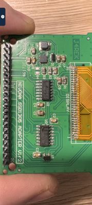

    #464 21624908
    zeto
    Posts: 37
    Rate: 10
    I have assembled a large board to J4rek's design - the inverter circuit that powers the display works - there is 12.2 volts and the display works, however the logic that gives the signal to reverse the mirrored image does not work (or malfunctions) - the display works, the image is unfortunately a mirror image of how it would have been connected on the original board which included the SSD1303.
    PCB labeled NIVONA SSD1305 ADAPTER V1r2 with display connector and electronic components .
    OLED display showing mirrored image and hourglass icon mounted on PCB .
    Has anyone had a similar problem and how did they solve it?
    Also, on this occasion, many thanks to the main mentors of the topic.
    AMIGOS and J4rek - great job in working out the replacement for this express!

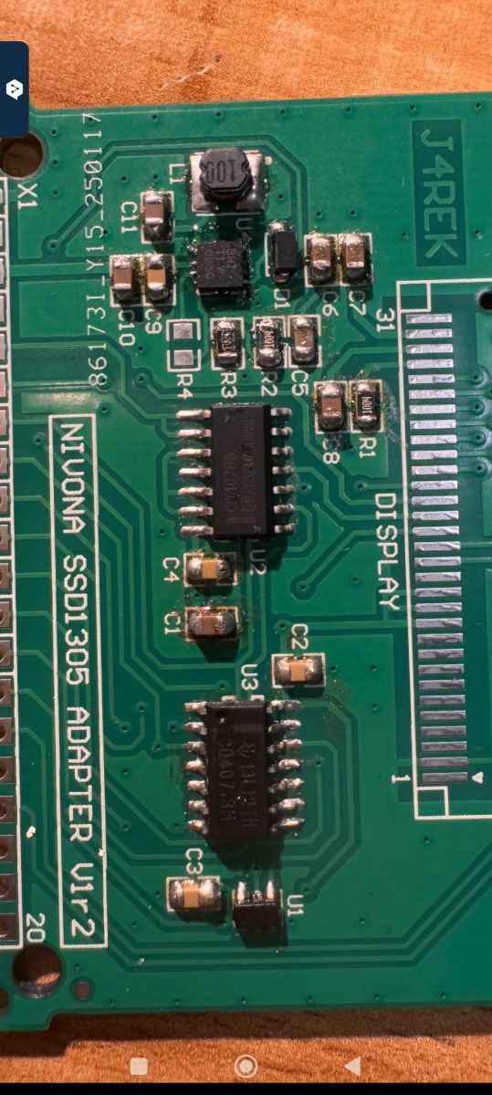

    Added after 2 [hours] 28 [minutes]: .
    >>21624908 .
    Problem solved.
    Close-up of OLED screen with System nagrzewa się text and hourglass icon .
    I fitted the MCP1700T-330E/TT stabiliser as provided in the miniature version developed by @j4rek.
    I soldered it 2 legs directly to capacitor C9, on which is the V BAT voltage from pin 3, and its output 3.3V kynar to capacitor C1.
    Close-up of PCB with red wire soldered to capacitor C1 .
    Close-up of MCP1700T voltage regulator soldered to C9 capacitor on PCB. .
    At the same time, in order not to change the VDD voltage for the SSD1305 display applied to pins 11,12 and 13 of the display, I cut the path leading to these pins, and wired a voltage directly from pin 2 of the baseboard to these pins, and soldered pin 2 to disconnect the 2.7V voltage from the baseboard from the 3.3V voltage from the additional stabiliser. As I already had the display glued to the board, I could not cut the path running from pin 2 on the other side of the laminate below the display.
    Close-up of SSD1305 screen soldered to green PCB with red wire visible. .
    Close-up of PCB with red wire soldered near DISPLAY label .

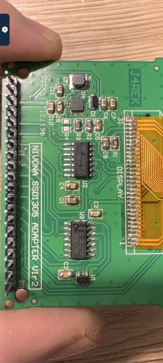

    #467 21626127
    j4rek
    Level 19  
    Posts: 370
    Help: 8
    Rate: 103
    I will try to upload a new version of the large PCB in the near future, so that it includes this 3.3 V stabiliser to power the logic as on the small PCB. As you can see, depending on which chip/part you end up with, some people's logic works on VDD 2.7-2.9 V and others don't.
    Here is the latest revision of the "NIVONA SSD1305 ADAPTER" PCB (V1r3) - a 3.3V stabiliser (U5) has been added to supply the logic (there is also an option to supply from Vdd voltage). If a stabiliser is used, solder points 2+3 on jumper J1. On the logic output signals (D0 and WR) I added series resistors (R5, R6) 1 kΩ.
    View of a PCB labeled NIVONA SSD1305 ADAPTER V1r3 with components and display connector .
    Attached are the gerber files for ordering the pcb.
    • NIVONA SSD1305 ADAPTER V1r3_schemat.pdf (202.74 KB) You must be logged in to download this attachment.
    • NIVONA SSD1305 ADAPTER V1r3 Project Outputs.zip (35.66 KB) You must be logged in to download this attachment.

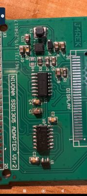

  • Display rework: cut C4 path and add 10 µF VDD capacitor
    #468 21627043
    zeto
    Posts: 37
    Rate: 10
    Thank you on behalf of future assemblers, I already have the boards soldered and have done a rework to supply 3.3 V to the logic circuits and the display still has a 2.7 V VDD supply from the express base board (2nd pin).
    Cut the path between the via and capacitor C4 (you can see it faintly in the photo, as I combined the capacitors and soldered C1 to the same solder field where C4 was (they are now together)).
    Close-up of PCB with modified soldering around capacitors C4 and C1 .
    I cut the path at the second via, leaving the connection of the via to the display pins (VDD from the baseboard of the express), and disconnecting C2.
    In addition, I scraped the mask off the path going to the display and the ground field (it's on both sides, so it doesn't matter which side) and soldered a 10 µF capacitor (I just had one) into these 2 new solder fields to stabilise the VDD voltage of the display (the original board also had a capacitor at VDD for the SSD1303).
    Close-up of a PCB with components U2, U3 and modified capacitor C2 with kynar wire .
    The final step was to connect C2 - C4 - the 3.3V output of the stabiliser with a kynar.
    I used the MCP1700T3302E/TT, which I soldered 'surface mounted' to capacitor C9, where the VBAT voltage (5 V) is.
    Modified PCB with kynar wires and relocated capacitors .
    Close-up of PCB with capacitors C9, C10, C11 and MCP1700 with red wire soldered .

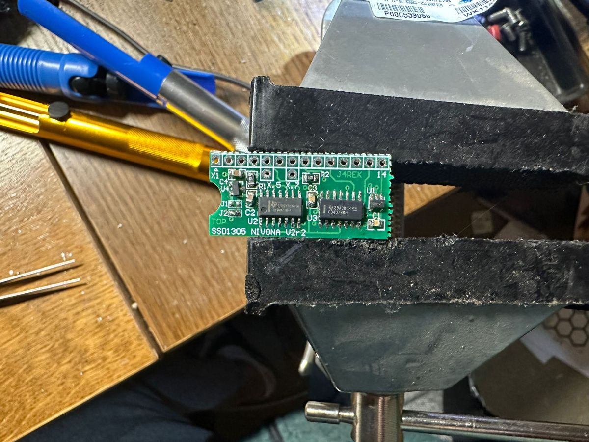

  • Clarifying SSD1305 V2r2 pin connections for assembly
    #475 21888747
    u1773049999
    >>21805331 >>21805331 Hi @j4rek, thanks for the great file you created and provided. I wanted to ask if the connection for (SSD1305 Nivona V2r2) that you described in the PDF file is correctly understood for assembly. Should I connect everything as in the picture (which you created a few years ago in 3D)? I'll upload your picture. Or should I cut off the pins between uP BOARD (original board) and X1 PB14s (Vr2r)?
    Best regards from Germany
    NIVONA Caferomatica 830 Coffee Machine: Damaged Display Repair, AliExpress Replacement
    Cześć @j4rek, bardzo dziękuję za wspaniały plik, który stworzyłeś i udostępniłeś. Chciałem zapytać, czy połączenie dla (SSD1305 Nivona V2r2), które opisałeś w pliku PDF, jest poprawne do złożenia. Czy powinienem, jak na zdjęciu (które wcześniej stworzyłeś w 3D kilka lat temu), wszystko podłączać? Zdjęcie z tobą załaduję. A może powinienem odciąć piny między uP BOARD (oryginalna płyyta) a X1 PB14s (Vr2r)?
    Pozdrawiam serdecznie z Niemiec
  • #476 21889222
    j4rek
    Level 19  
    Posts: 370
    Help: 8
    Rate: 103

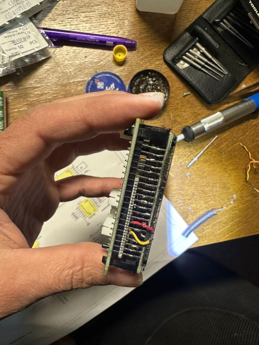

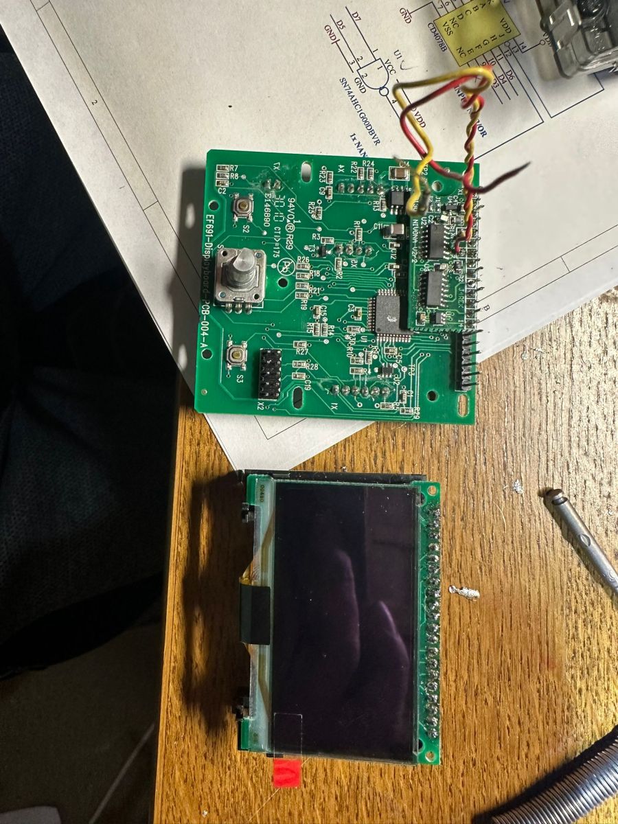

    Please connect as in this old photo, all pins from the original board must go into the X1 pads of the adapter (SSD1305 Nivona V2r2). The LCD board must get pins 5 and 7 from the adapter board.

    Thanks for the quick reply j4rek.
    I have assembled the board and then mounted the display in the centre. Now I have a new problem:
    As soon as I connect the display, all LEDs of the display light up permanently (all segments are active).
    Can you please check whether I have done the wiring correctly or where the problem might lie?

    Gdy podłączam wyświetlacz, wszystkie diody LED na wyświetlaczu świecą się na stałe (wszystkie segmenty są aktywne).
    Czy mógłby Pan sprawdzić, czy zrobiłem okablowanie prawidłowo, czy gdzie może leżeć problem?

• Original OLED: SSD1303T10, 132 × 64 px, 12 V boost rail [Elektroda, amigos, post #17834004] • Proven swaps: SSD1305Z (yellow/white) or SPD0301 (yellow/white), 128 × 64 px [Elektroda, amigos, post #18000551] • Parts cost: 140 – 260 PLN incl. PCB, vs. 800 – 1 000 PLN service module [Elektroda, jacenty67, #17179483; Luczi04031986, #18508253] • PCB options: “Satanistik 24-pin” for SPD0301 or “Amigos 31-pin” for SSD1305 [Elektroda, satanistik, #17894955; amigos, #18233157] • Typical boost voltage after TPS61045: 11 – 13 V DC [Elektroda, jackmc, post #18490466]
Which replacement OLED works without missing pixel columns?
Choose an SSD1305Z 31-pin panel; it shows the full 128 × 64 frame with no two-column gap that affects SPD0301 swaps [Elektroda, amigos, post #18000551]
Why does my SPD0301 screen show a 2-pixel blank strip?
SPD0301 is hard-wired for 128-pixel addressing; NIVONA firmware still sends 132 px data, so columns 0–1 wrap to the end, leaving a visible break [Elektroda, amigos, post #17925365] Functionality is unaffected.
What PCB adapter should I order for SSD1305?
Download the ‘Amigos SSD1305’ Gerber pack (post #18233157) and order 1 mm FR-4, 1-oz Cu; five boards cost about 8 USD delivered from JLCPCB [Elektroda, amigos, post #18510016]
Do I need hot-air to solder TPS61045 boost IC?
Yes. The SON-8 package sits under the board; use 250 °C air, flux, and tweezers. Hand soldering risks bridging pins 6–7 and kills the 12 V rail [Elektroda, damek4, post #18600363]
Edge case: display stays dark after swap—what to test?
  1. Measure VCC at JP1 pins 1-2; it must be 3.3 V.
  2. Check boost output at C4/C10; expect ~12 V.
  3. Inspect TPS61045 for shorts; one bridged pad drops boost to 4–5 V, leaving OLED blank [Elektroda, damek4, post #18600363]
How to flip the mirrored image on SSD1305/0301?
Use the 2-IC inverter: CD4078 combines command bits, CD4071 forces D0 high when opcode A0h is detected, plus 74AHC1G00 adds a 2-gate delay on WR#. Full schematic in post #18507781.
Is a plug-and-play board available?
Yes. Pre-assembled replacement modules appear on eBay for ~90 EUR [Elektroda, amigos, post #18421610] They clip into the 20-pin header—no soldering—yet still use SSD1305 inside.
Statistic: how much money do DIYers actually save?
Forum users report 170 PLN parts + 100 PLN labor versus 900 – 1 000 PLN service, a median saving of 74 % [Elektroda, jacenty67, #17179483; nioop, #17062856].
Can I reuse the old boost inductor and diode?
Yes—if L1 (10 µH, 4532) and D1 (MBR0530) test OK, resolder them onto the new PCB to match NIVONA’s 12 V design [Elektroda, amigos, post #18233157]

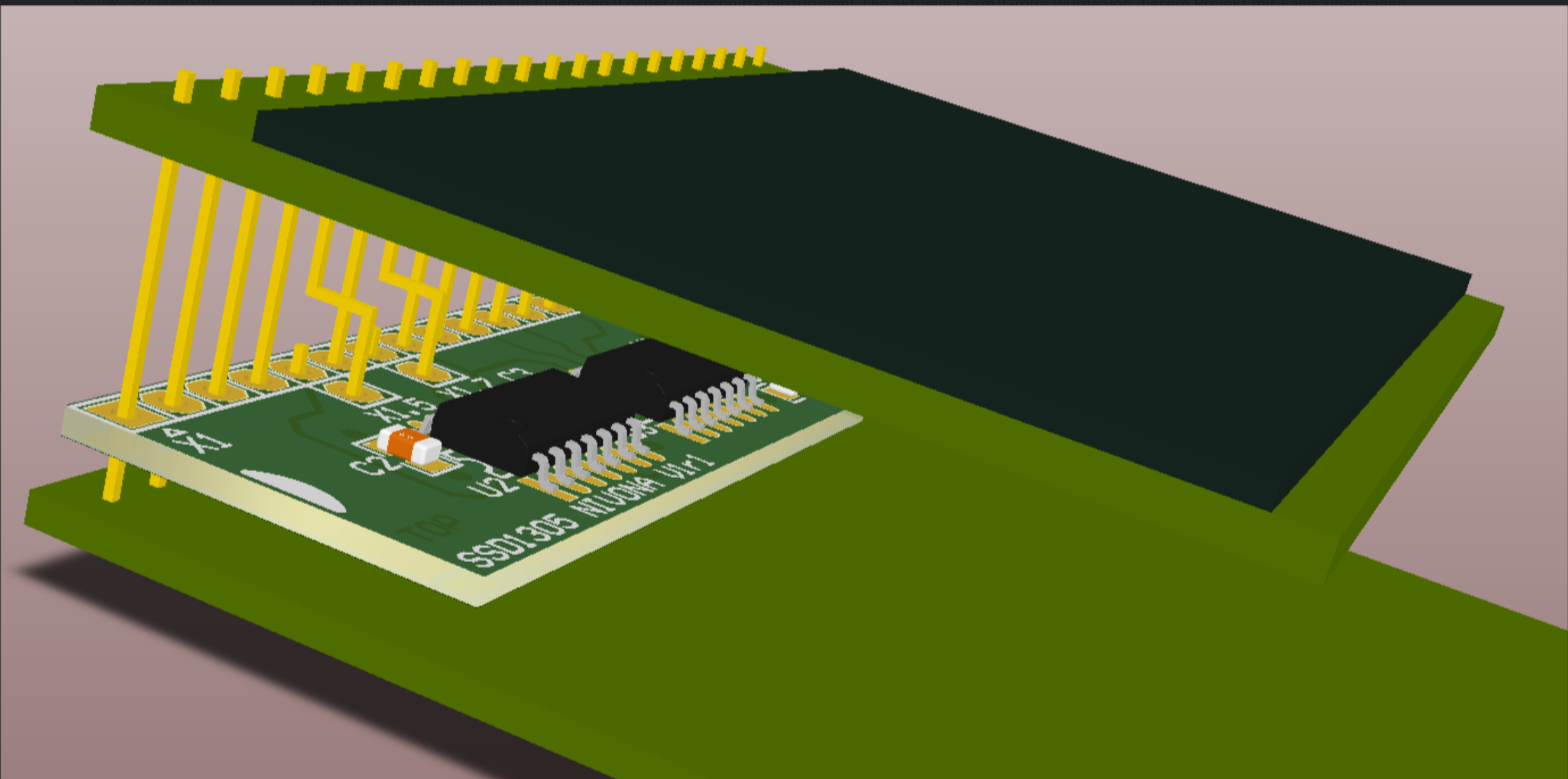

3-step How-To: swapping the OLED panel
  1. Unsnap front fascia, desolder 31-pin ribbon, lift old SSD1303 OLED.
  2. Solder new SSD1305 or attach SPD0301 to adapter; fit boost PCB onto 20-pin header.
  3. Bridge D0 (pin 7) per schematic, reassemble, set clock.
What if the new OLED flickers or is dim?
Reflow TPS61045 and check R4 (set to 120 kΩ). An undervalued R4 limits Duty, capping boost at 8 V and causing flicker [Elektroda, jackmc, post #18490466]
Can I order parts locally instead of AliExpress?
Yes. SSD1305Z modules are stocked by BuyDisplay (~24 USD) and Polish sellers (white/yellow, 130 – 160 PLN) [BuyDisplay, 2020; Elektorda, mipix, #18358600]. PCB components are common 0402/0603 passives.
Expert tip for beginners?
“Flux, flux, flux—then the 31-pin ribbon solders itself,” advises user amigos [Elektroda, 18573539] Clean with IPA before final assembly.
