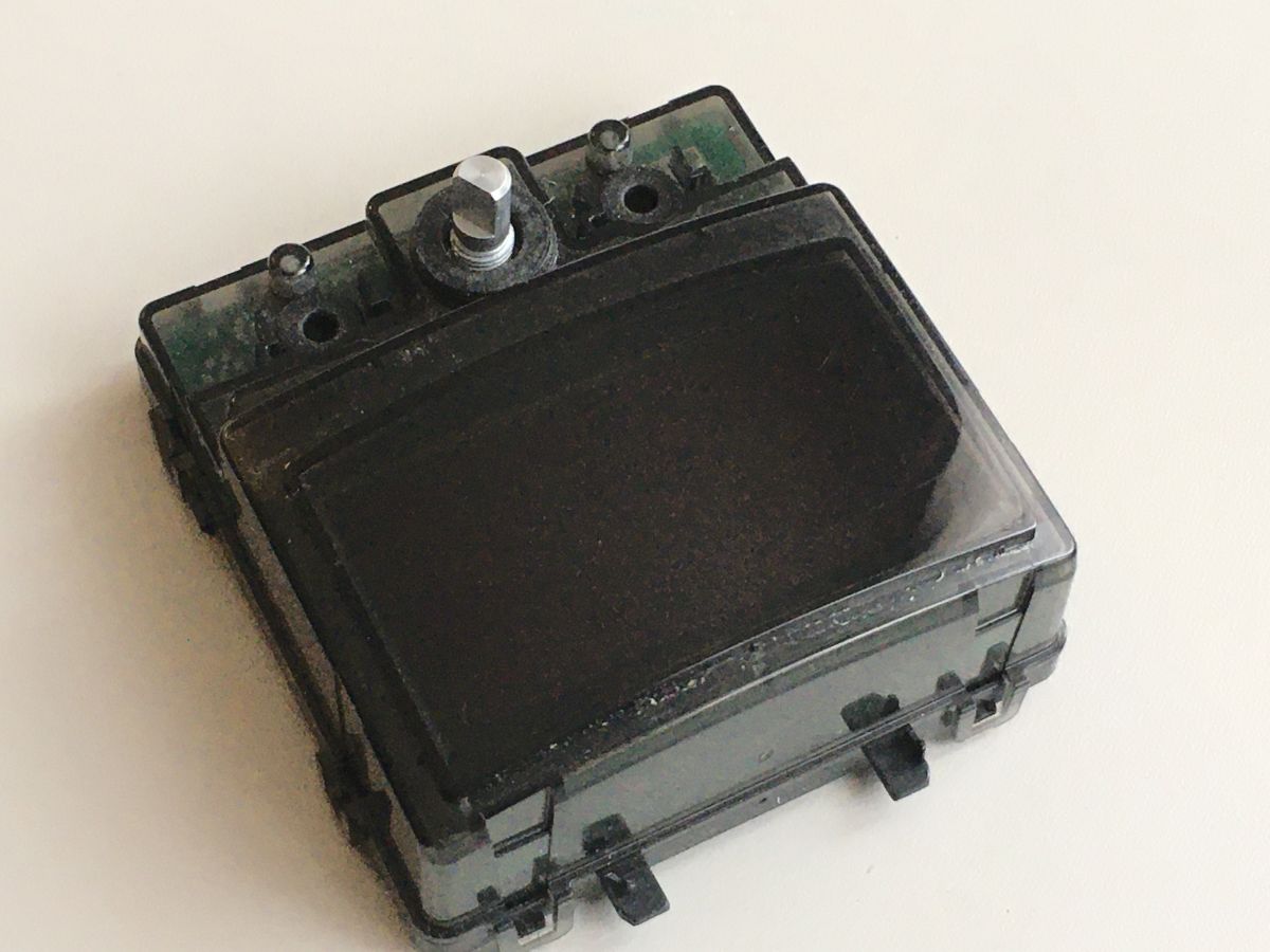

How can I replace the damaged display in a NIVONA Caferomatica 830 with an AliExpress part?
You usually cannot swap in a random AliExpress display: the original module was a special SSD1303T10, and generic substitutes like BL-12864G2 ERNHn/SPD0301 were reported not to fit or to use a different controller [#17062856][#17833740][#18455044] The practical solution that finally worked was to buy an SSD1305/SSD1305Z OLED module from AliExpress and use one of the adapter PCBs developed in the thread; with the reversal fix, it works like the original and no missing-line problem appears [#18305185][#18233157][#18358600] For the J4rek adapter, the tested parts are C1=C3=100nF, C2=4.7uF, U1=SN74AHC1G00DBVR, U2=CD4071BM, and U3=CD4078BM, and the display is soldered directly to the adapter, which then plugs into the machine’s original 20-pin connector [#18959999][#18279191] If you build the simplified version, the TPS61045 stays on the original board; in the full version it is included on the new PCB [#19025589][#18959999]

    What could be the reason if the display does not turn on at all?
  • #401 19218688
    Rosenkopf
    Posts: 12
    There are these states among others.
    1. The display is black but the machine makes driving noises when turned on.
    Here the fault can be found in the display module.
    2. The display is black and there is no driving noise.
    Here the fault lies in the display module or the motherboard.
    If you have a working display, the error is easily attributed.

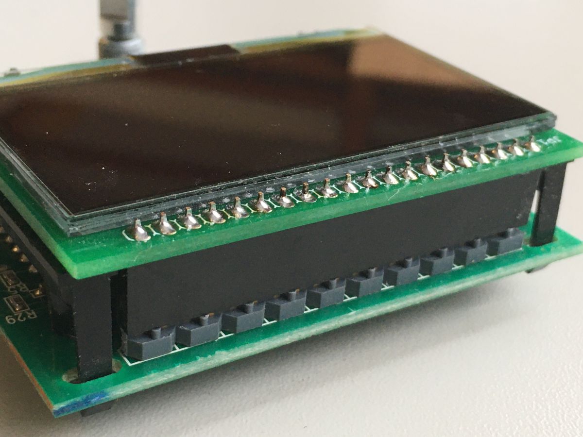

  • #402 19219191
    Niki331
    Posts: 43
    Initially, I attached a display with no additional layout and the image was just inverted. I ordered the tiles from the project, soldered everything and now it does not work, the display is dark, no coffee sounds. In my opinion, everything soldered well. When I measure the voltage + 3.3 V and GND, I have about 1 V and it's strange, because previously everything was going only the image was reversed.
    NIVONA Caferomatica 830 Coffee Machine: Damaged Display Repair, AliExpress Replacement
  • #403 19220078
    j4rek
    Level 19  
    Posts: 369
    Help: 8
    Rate: 103
    It seems that it is not well soldered or some circuit / component is damaged. This low supply voltage indicates an overload or short circuit, so the main processor does not start, so there is no noise of the machine. I propose to unsolder the plate and measure the resistance between pin 1 and 2 (VDD) and 1 and 3 (VBAT).

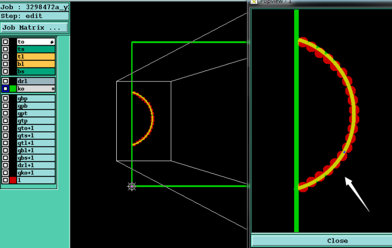

    Donatello-1984
    I wanted to order a circuit board (the NIVONA SSD1305 ADAPTER V1r2 gerber files)
    Unfortunately I got an email from support.
    Screenshot of PCB design software showing an issue with 0.4mm holes.
    Hi Sir,
    Well got your order with many thanks~
    Sorry to bother you, but there is an issue that we want to confirm with you before proceeding.
    As shown below, for these 0.4mm holes, they are too close, we can't make them.
    Coud we change them into a cutting line to proceed?
    Your early reply will be highly appreciated!
    Thank you so much!
    Is it okay or must I have done something wrong?
    VG
  • #405 19236877
    j4rek
    Level 19  
    Posts: 369
    Help: 8
    Rate: 103
    It's ok, you can change it / have it done as a cutting line.

    Hi could anyone help? The center panel of the display is destroyed. Has anyone made a plan for this? I would buy the plan if anyone had it. You want to make the board. I attach a picture of what it is about.

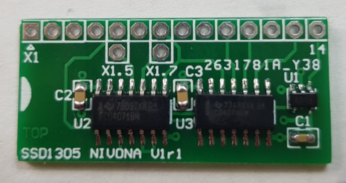

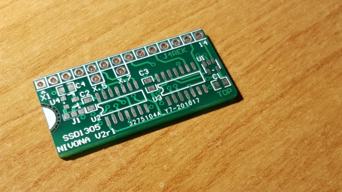

    Donatello-1984
    Good Morning,
    So that I understand everything.
    I bought 1x small board and 1x large board from J4REK version.
    If I use the old board from the display, do I take the small circuit board and only have to buy the components?
    If I throw the old board away from the display, do I have to take the large circuit board and put the components on it?
    Is it right?
    So you have 2 options right?

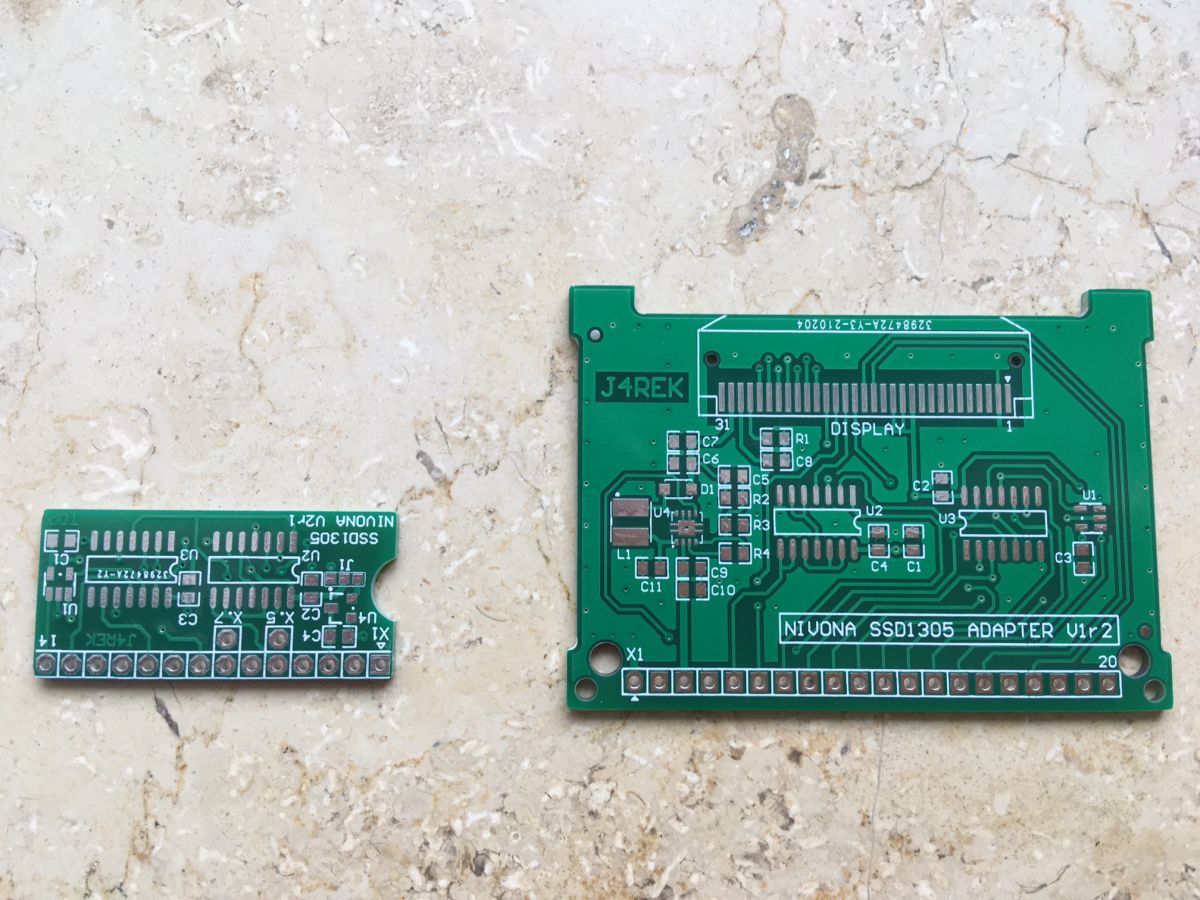

    Two green printed circuit boards of different sizes on a light background.
  • #408 19308780
    j4rek
    Level 19  
    Posts: 369
    Help: 8
    Rate: 103
    1. Option - small plate plus replacement of the oled on the old top plate.
    2. Option - we only replace the top plate (new oled plus smd elements obtained from the original top plate).

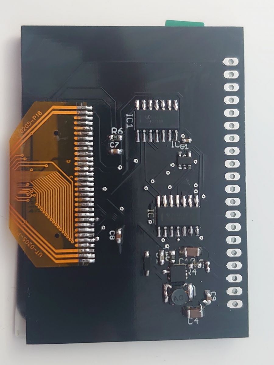

  • #409 19311540
    miji2
    Hi guys, many thanks to all who helped my coffee machine work again, especially Amigos and Satanistik. I was able to manufacture the display replacement using two different displays. I met a few problems including low voltage due to resistor 120k (solved by lowering the resistance down to 100k) and breaking the display while trying to stuff it into case :-), but finally everything works fine and I have a few spare satanistik/amigos PCBs and a bunch of components.
    Is anybody interested in buying the enlivened PCB with display and 20pin male connector for the main module board for let's say 99€ plus transport fee? Alternatively if you sent me the whole Nivona display module, I can replace the PCB+display for you, for free :-). 5€ from order will be sent to Amigos/Satanistik if they give me the permission. Little patience will be needed as I currently have no spare display but I can order some. I live in the Czech Republic. You can sent me a private message or mail to miji2 at volna.cz

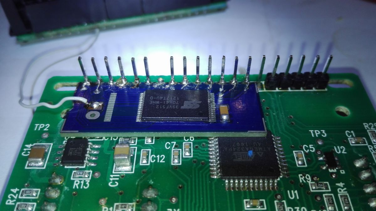

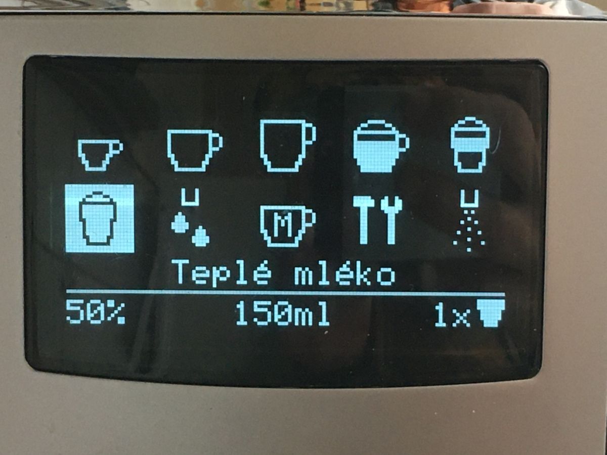

    Markus2010
    I used the solution from the Dragon. I cut the pins connecting the boards, mounted the adapter (a system to invert the image display) and added a 20pin plug socket to the display board and a new display. Now it works like "new". Thanks to Smoczy.
    NIVONA Caferomatica 830 Coffee Machine: Damaged Display Repair, AliExpress Replacement NIVONA Caferomatica 830 Coffee Machine: Damaged Display Repair, AliExpress Replacement

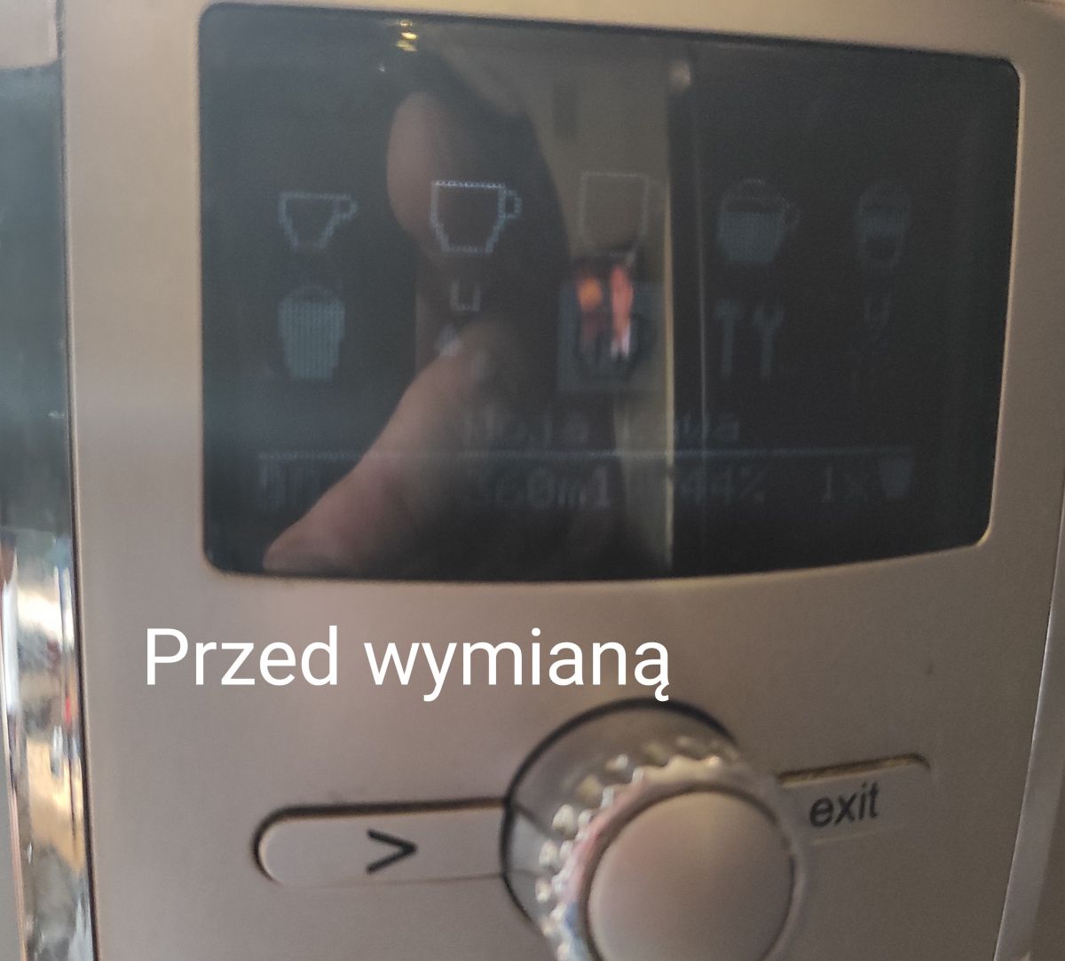

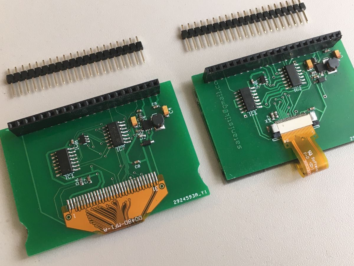

    Lethieg
    hello everyone
    I come back to your help once again. I fixed my screen last year with an ssd1305 and the pcb modifier from Smoczy. so I bought a new machine to repair and I'm looking for a pcb to fit on the 1305 if any of you have one to sell I'm a buyer 🙂
    Image of a PCB with an SSD1305 display module mounted.
    Thank you, have a good day
    Romain

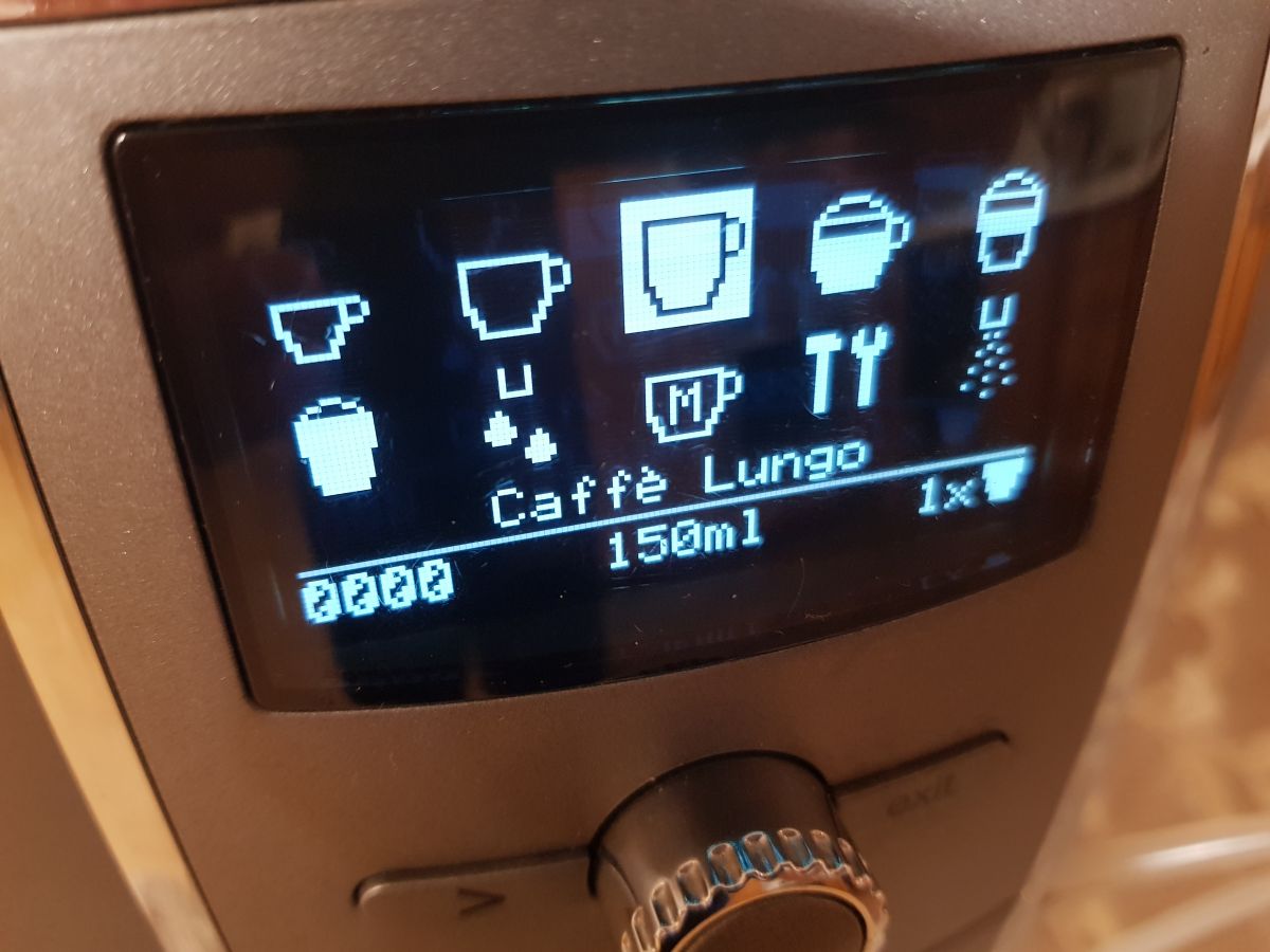

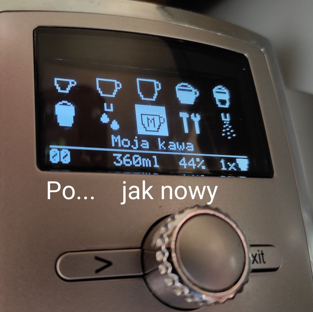

    vasyl.lemyk
    Hi everyone. Many thanks to Amigos and Satanistik. Nivona now works like "new".
    Coffee machine display with Caffè Lungo settings.
